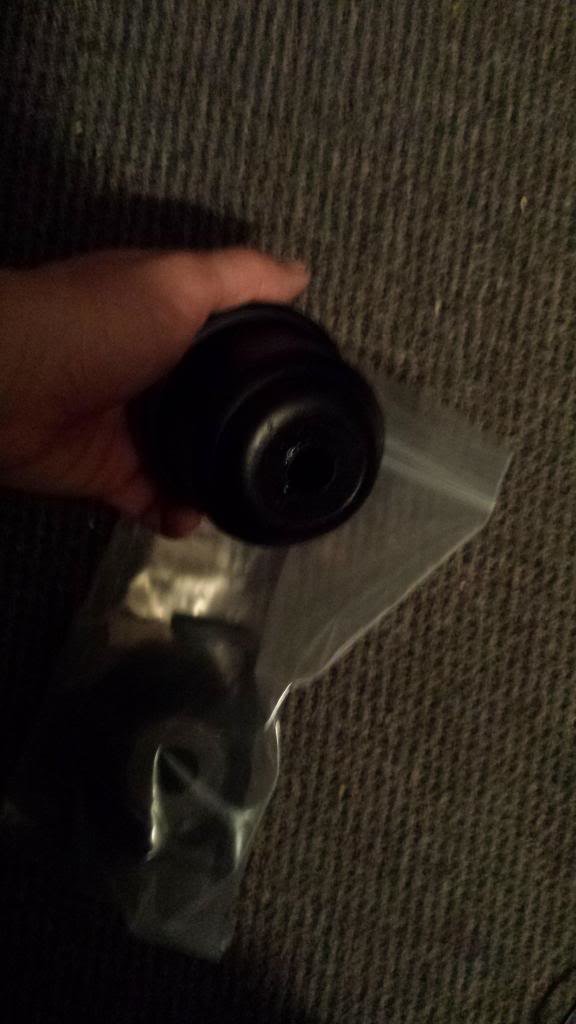

    Wheelers super bumps just came in the mail!

    ^^^ I just installed those on my truck like 2 weeks ago. You'll love em man!
