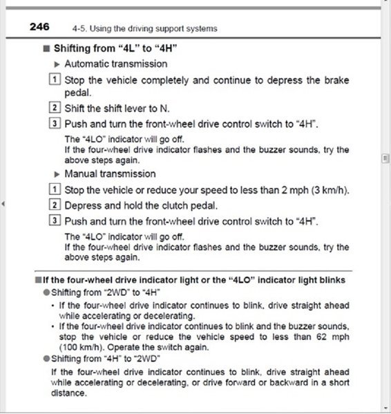

    For automatics, When we're in 4lo and want to shift back into 4hi or 2wd, do we have to put the tranny in neutral first? Like we have to when going into 4lo.
  6. Jun 8, 2016 at 12:21 PM
    #26
    eon_blue
    Mar 4, 2016
    #180213
    69,595
    Azusa, CA
    Yep

    You can engage it on dry pavement as long as you are going straight (but why would you need to anyway?). It's the turning that causes the problem. Normally the wheels turn at different speeds when turning and in 4wd they turn at the same speed so it starts to bind up the driveline. You can definitely feel what's going on, makes it harder to turn.
    From 4lo to 4hi, yes neutral. 4hi to 2wd it doesn't matter.
    Just be sure if you're shifting on the fly to let off the gas and coast while it engages.
