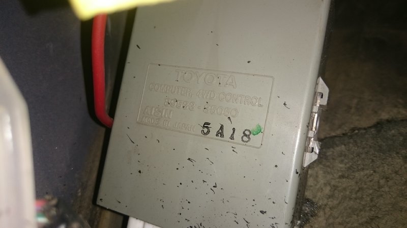

    I checked with the multimeter and there is no power going to the add vacuum relay at all. I pulled the little 4x4 computer out and didnt see any obvious signs of damage on the board and the relay clicks when the 4x4 button is pushed. Fuse is good.

    Bump. There a how to on troubleshooting the 4x4 computer? Anyway to manually engage the transfer case actuator or bypass the computer? I really need my 4x4 working the next few days.
    This is the one in my truck
