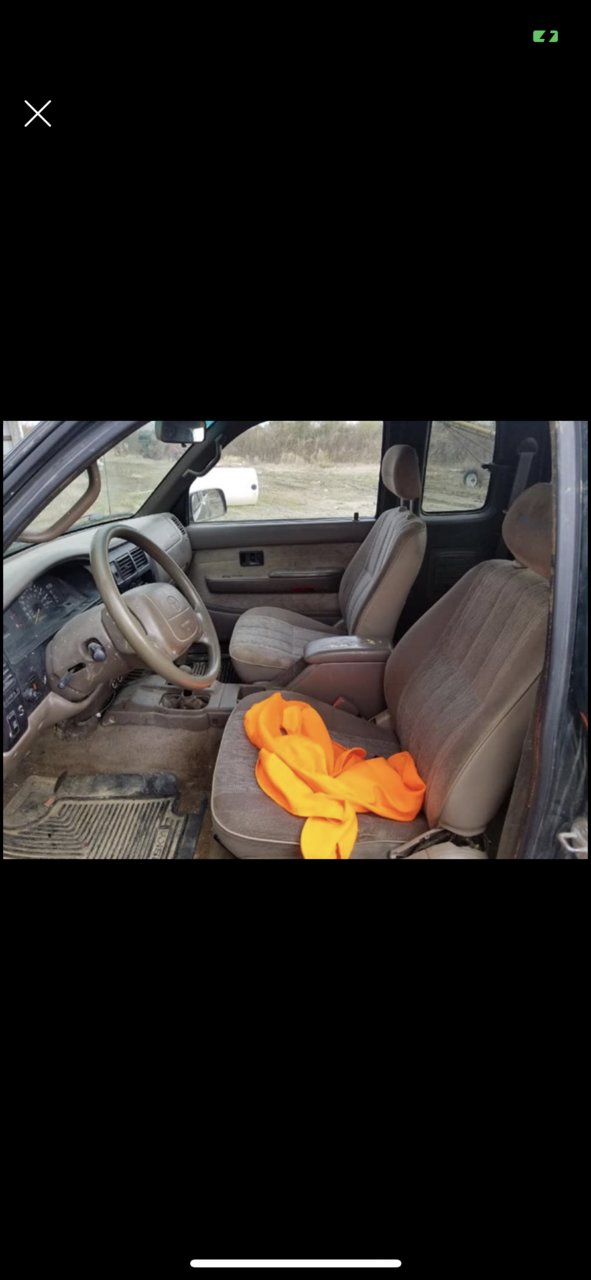

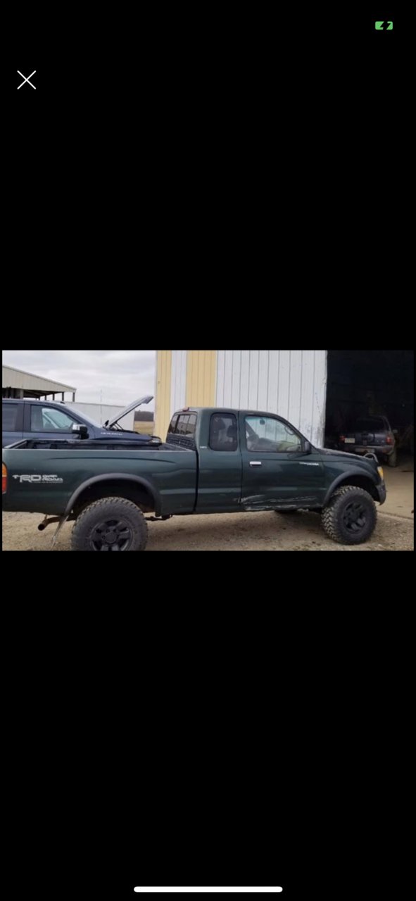

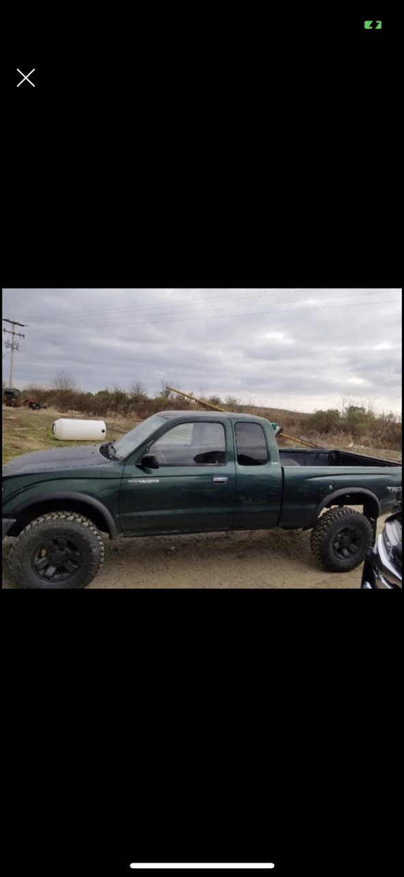

    Here are some pics of the potential purchase.
    I’m currently doing a full restoration on my truck. Paint and interior. The parts from this truck would all be serviced and rebuilt where appropriate before installation on my truck.

    Looks like all the parts are there.
    J shift and ADD

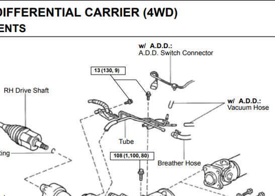

    The 99 is probably vacuum ADD, not electronic like the newer ones. I'm not sure on the year it changed to electric.

    And yes it may be vacuum. I don’t know when the change was. 01 up for sure are electronic

    I just looked at the 2000 FSM and it shows a vacuum line attached to the ADD. It does have a wire harness connection, but I assume that is for the dash light.
