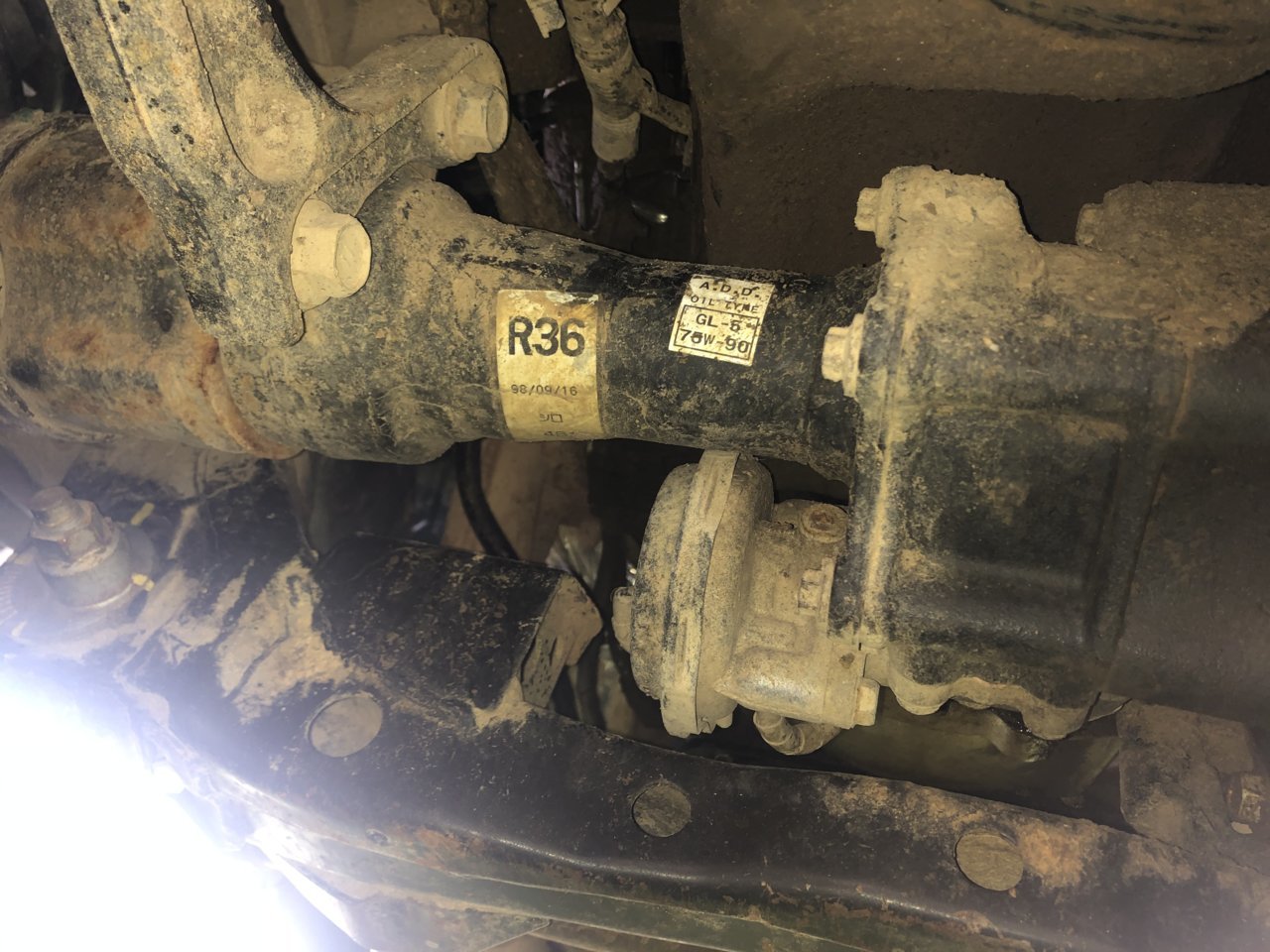

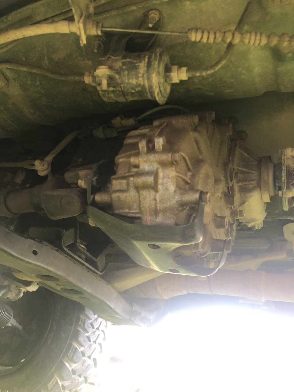

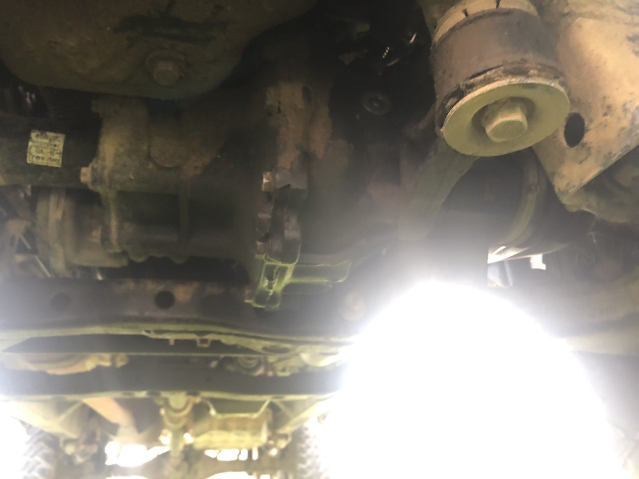

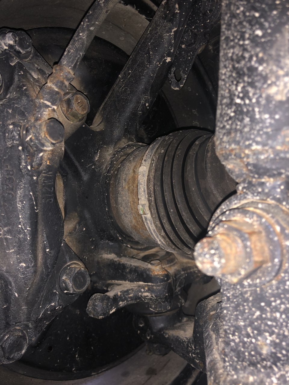

  11. Jan 24, 2020 at 3:21 PM
    #51
    jonesbt
    jonesbt [OP] Well-Known Member
    Sep 22, 2011
    #63963
    366
    Brett
    Monroe, La
    01 3.4L DC PreRunner—>4WD
    TRD Headers TRD Supercharger Custom Cavalry Blue Paint

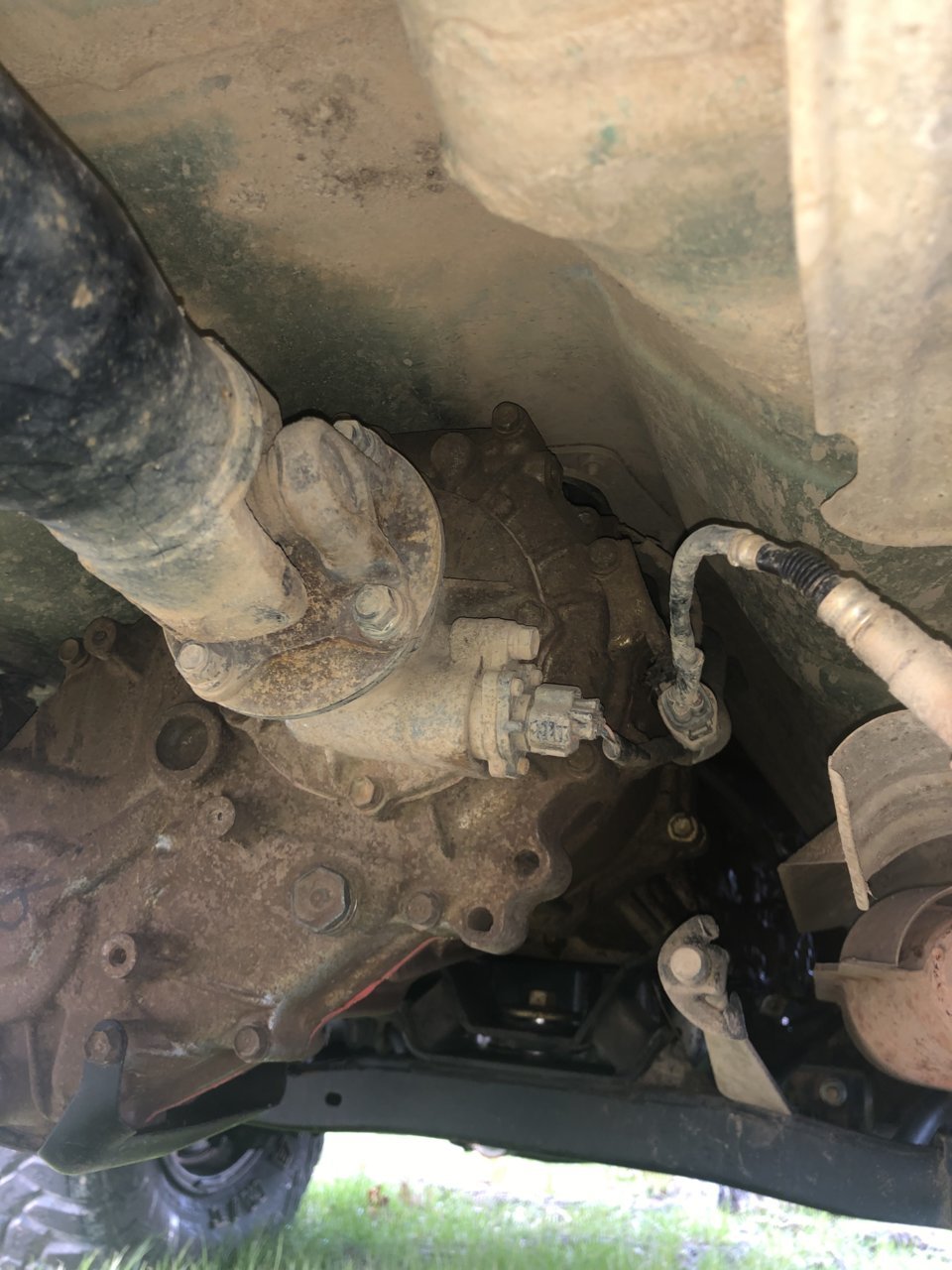

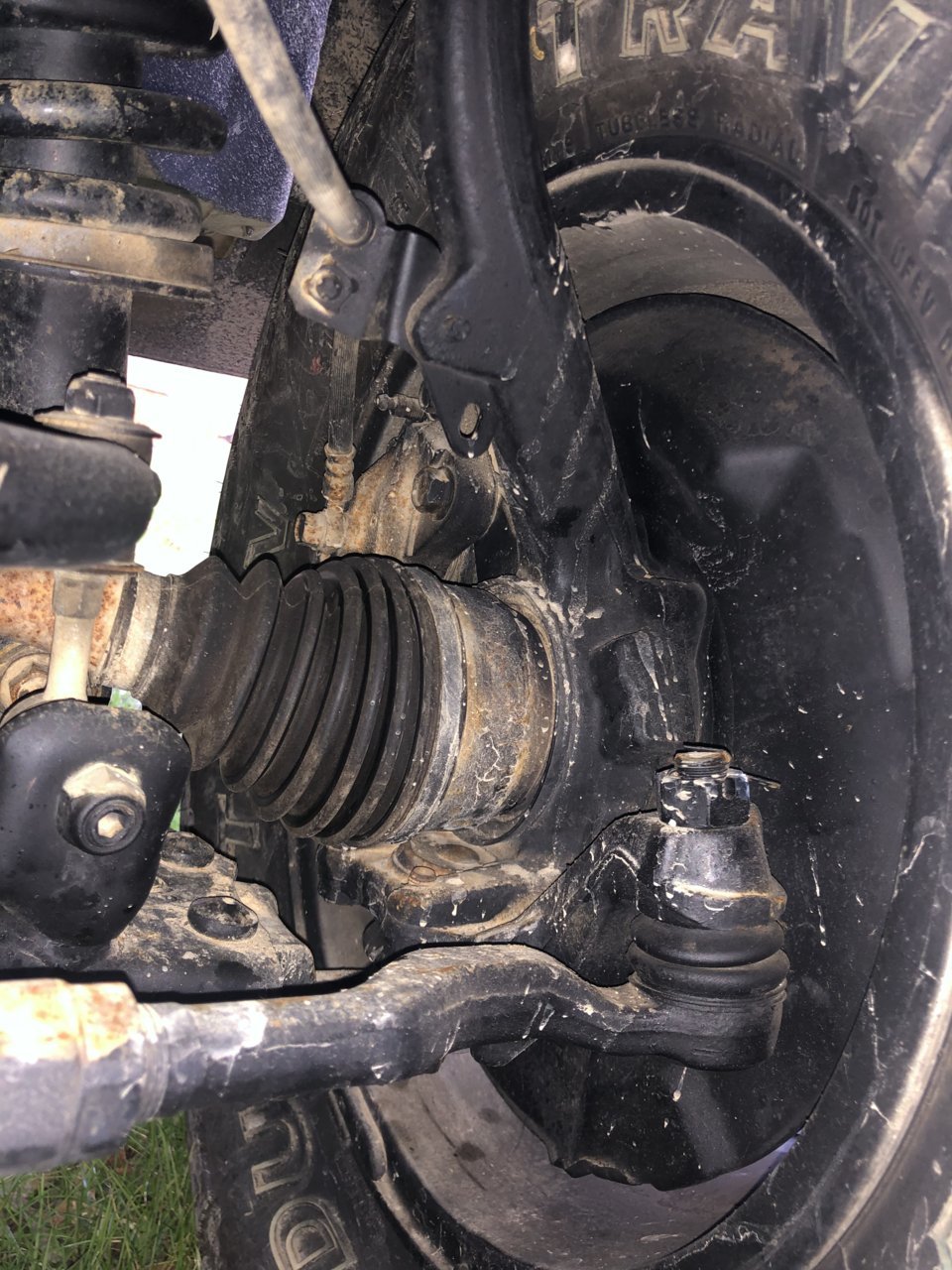

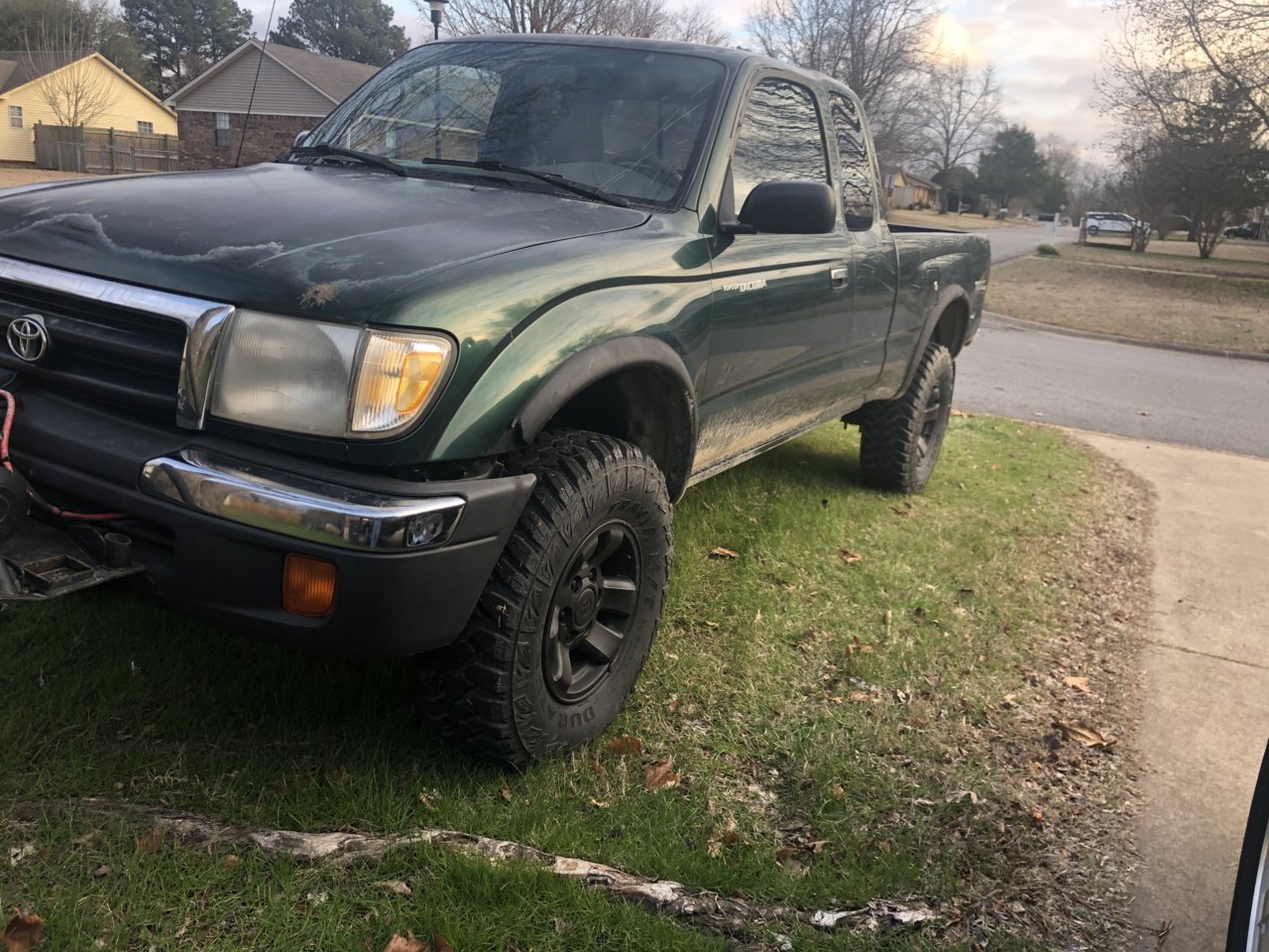

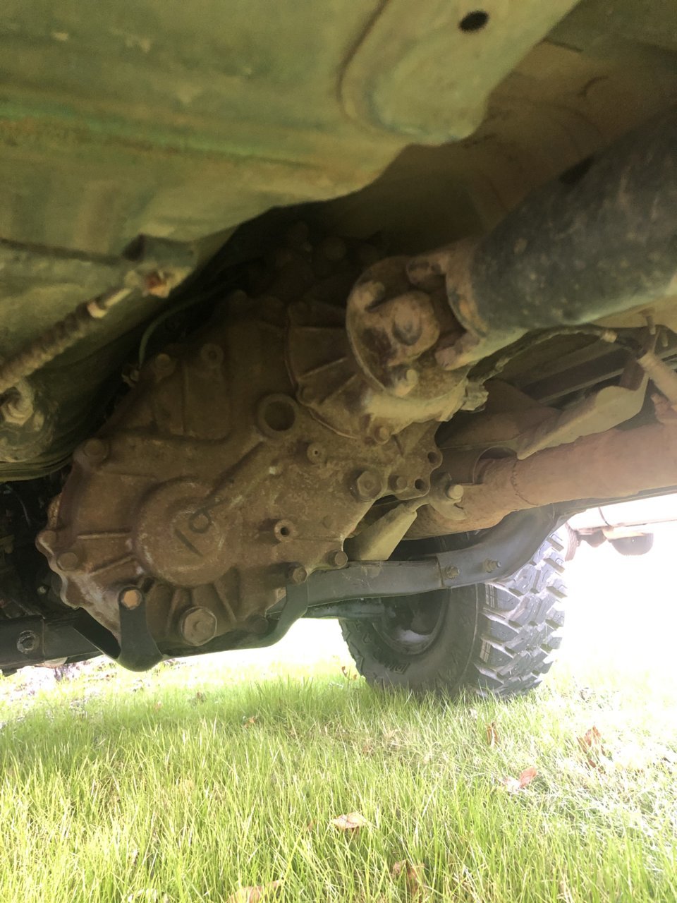

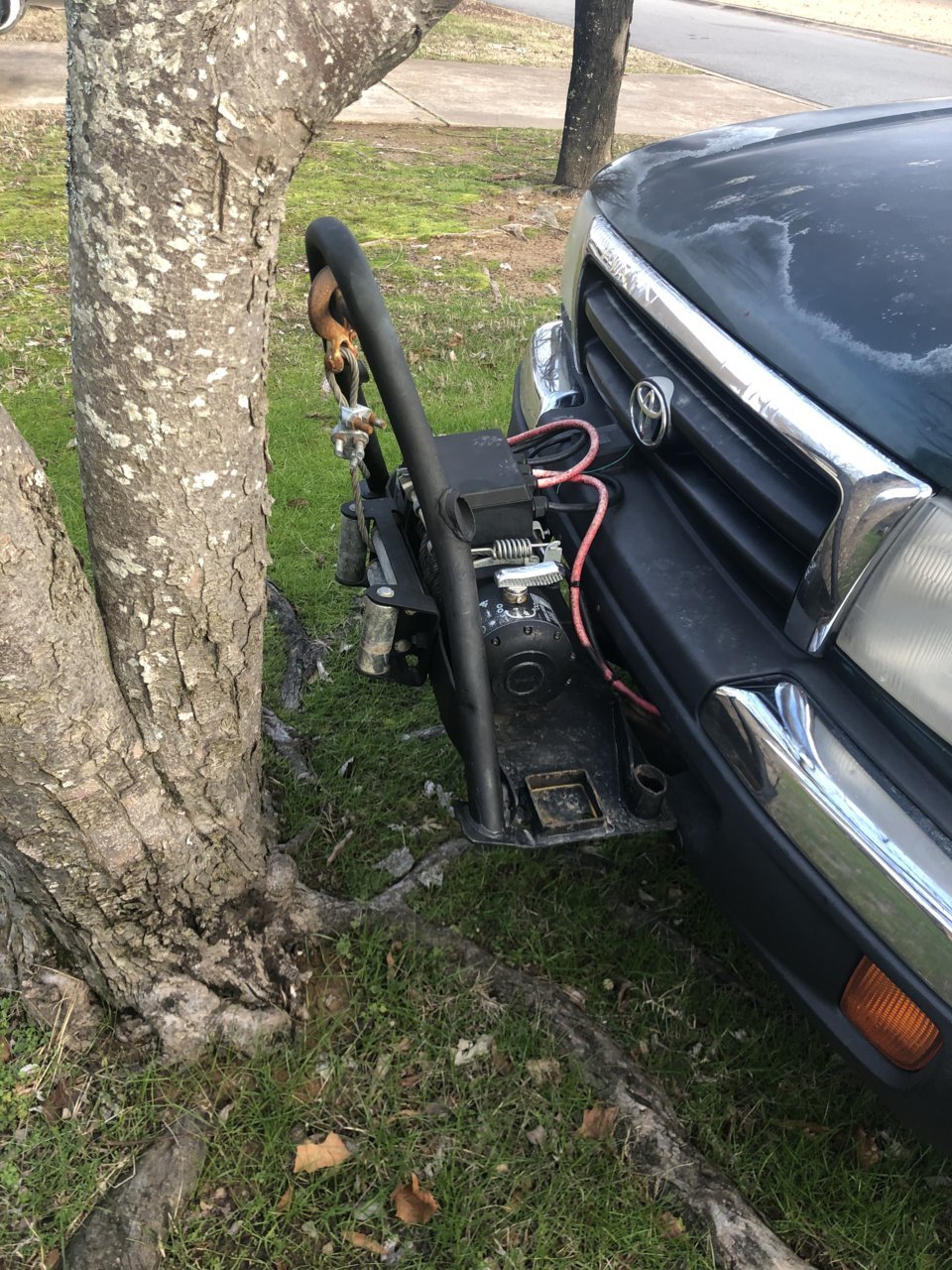

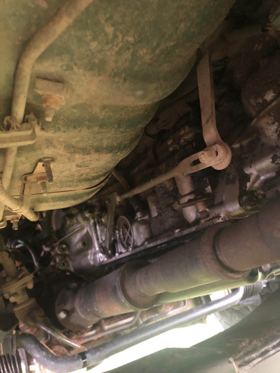

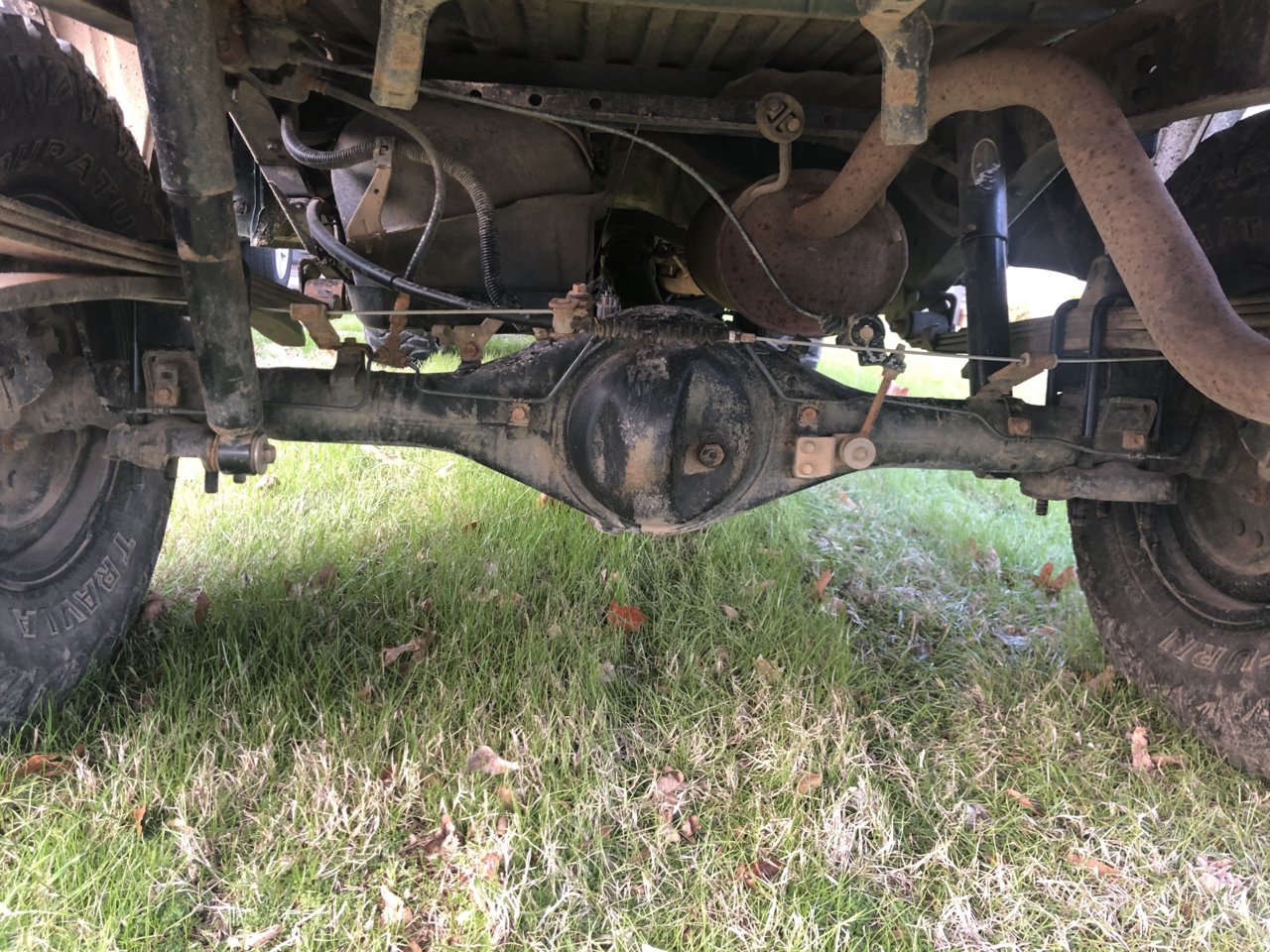

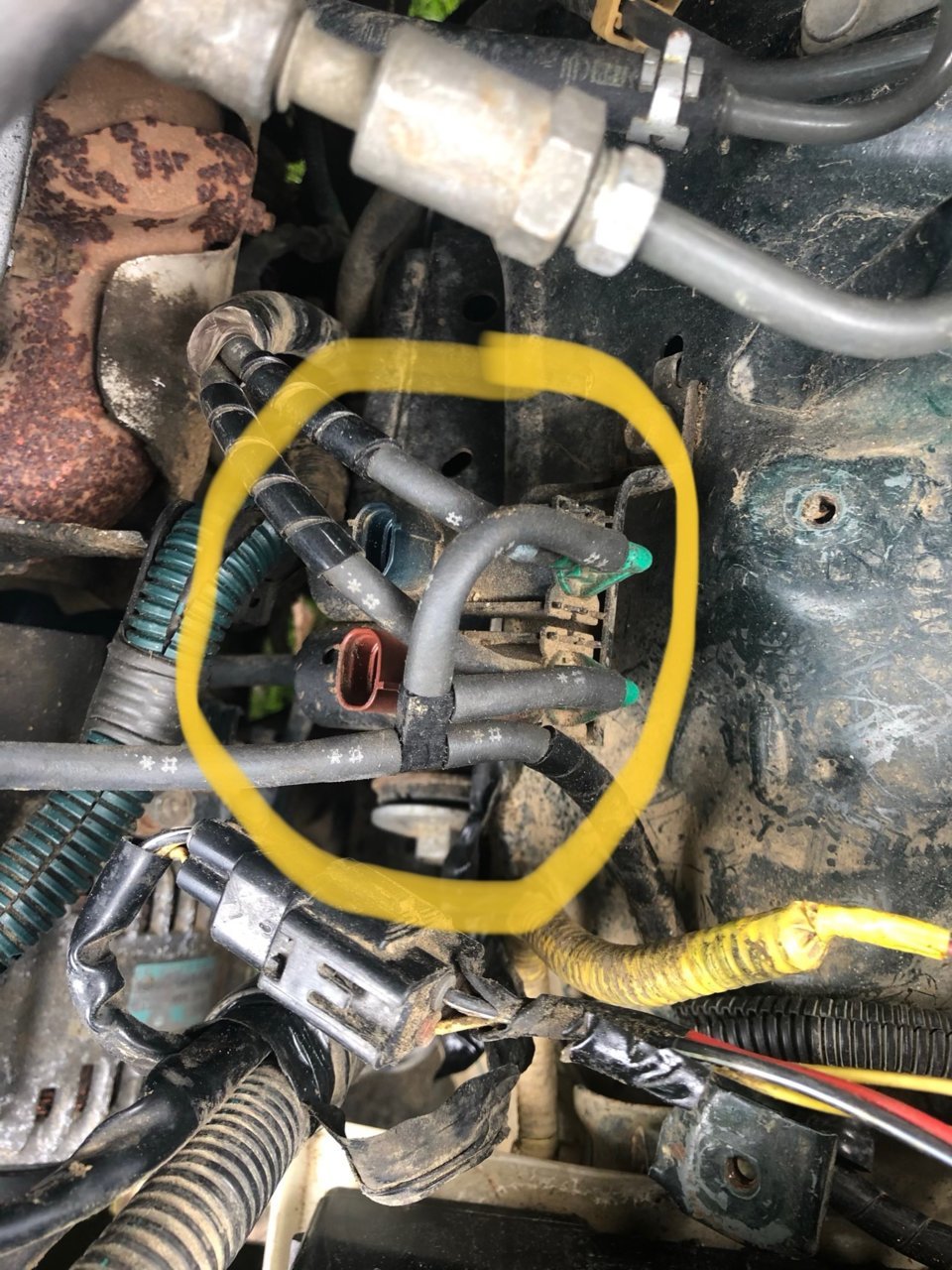

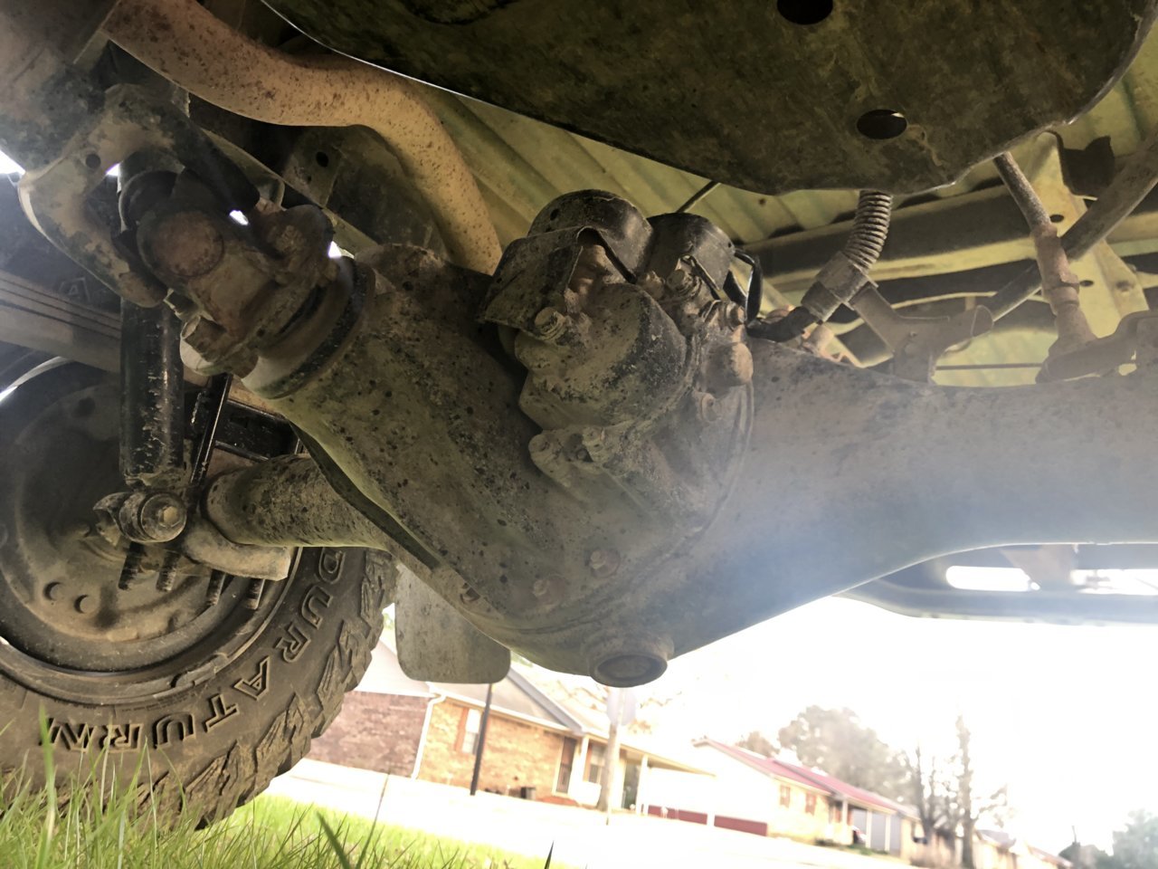

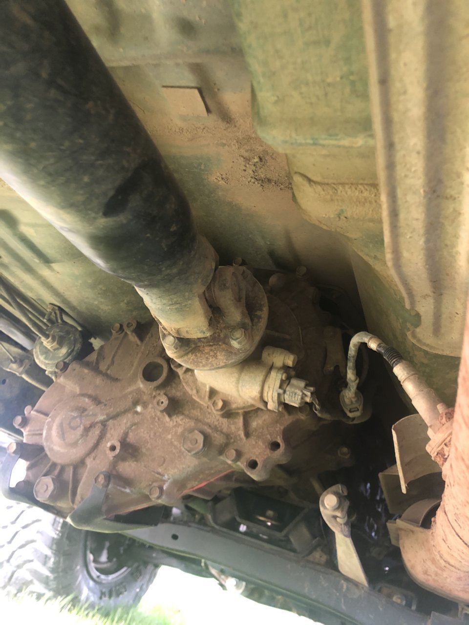

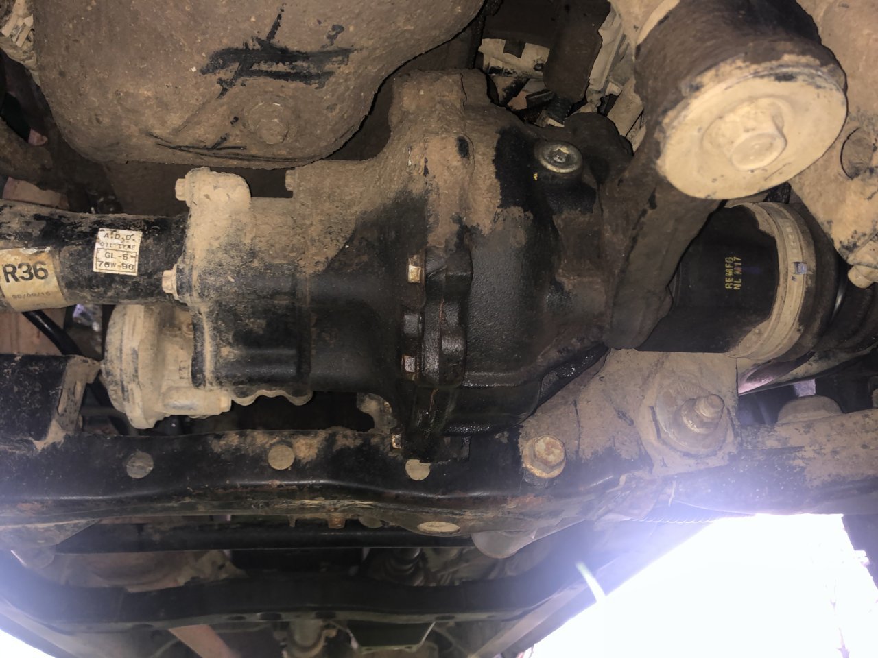

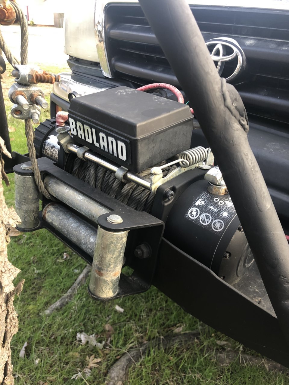

    Here are some pictures that I snapped really fast. There are quite a few leaks here and there that I have noticed already. This is fine because I planned to replace all of the seals that I could get to in the process of swapping the parts. Would you guys look the pictures over and tell me if you're seeing any red flags? I apologize that the pictures aren't fantastic.
    As mentioned earlier in this thread, I would love to use the rear end out of this truck. It has a locker and my truck does not. Gearing is 4.10 just like mine.
    frenchee likes this.

    Seems like a pretty good little truck

    It really is. It's almost a shame to start ripping its guts out! It'll make a solid little 2WD truck here soon though. I might be one of the first people on here to pull off a pre-runner to 4WD swap and a 4WD to Pre-runner swap at the same time.... or at all for that matter.
    The truck ran pretty well on the hour drive to my house earlier. The steering rack bushings are completely shot so it pulled pretty hard on the interstate, but otherwise it was a pretty good drive.
  14. Jan 24, 2020 at 4:21 PM
    #54
    eon_blue
    eon_blue Most Improved Member
    Mar 4, 2016
    #180213
    66,880
    Got a big ass winch on the front of it...12k is a bit overkill for a 1st gen lol. Looks like a good parts truck though

    Does anyone know where I can find some information on how to power the VSV for the ADD system? I pulled the valves, vacuum hoses, and canister from the 99 today and mounted them in my truck. I do not think my wiring harness has pre-existing plugs to power the VSV solenoids.
    I'm considering stripping the 99 wiring harness for the wires and plugs but really don't want to make a mess of the donor harness.... bc I have no idea how deep that rabbit hole would go.

    For swaps, many opt for the later electric style ADD.

    If its cheap and simple to go the electric route I totally will. I have every part I would need for the vacuum option already though(outside of my truck being pre-wired for it). I don't really like the idea of having that vacuum canister in the front wheel well anyway.

    if you can find a electric ADD actuator i can get you the diagrams. if not you can wire the VSVs up pretty simply. but you will not have it act factory/
