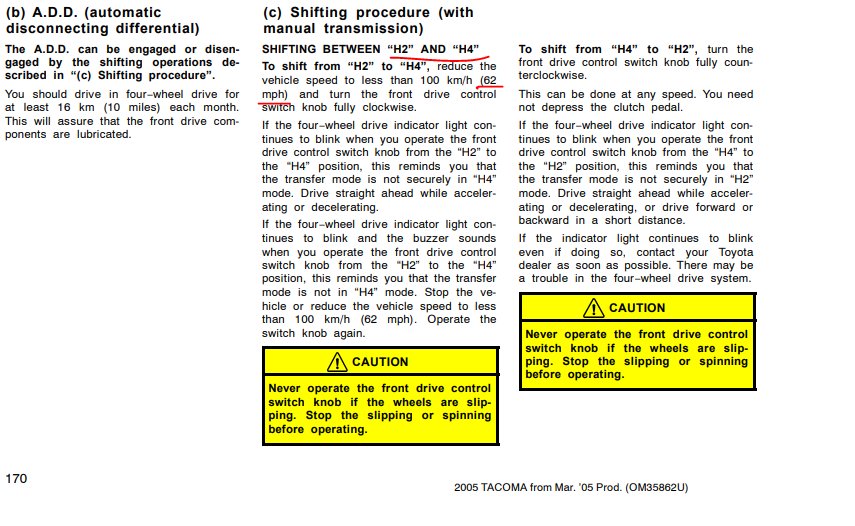

    I can also confirm the same, you can switch on the fly for 4hi. I believe the speed is 65/66mph 62mph and faster that won’t allow the switch.
    It’s been years since I’ve tried it but if you attempt it over that speed the truck will continuously beep at you and will not go into 4hi even if you slow down below that speed. You have to switch back to 2hi, slow down, then re-engage 4hi.
    Of course I should also note that if the conditions call for 4hi on a highway I definitely would not be pushing those speeds.
    As for having your foot on the gas, the 4wd system doesn’t like to engage when the revs are high. When I switch to 4hi I let off the gas and it switches pretty quick. If it makes you feel any better you can always just flip the switch to 4hi and the computer will choose when to fully engage it, thus preventing any damage to the system (unless of course MT is different but someone can correct me)
    edit: corrected max activation speed

    Nice! You found the manual citing 62mph, I remembered it being a strange number but could not remember the exact speed.
    I can also confirm that 4hi does not have a listed max speed and that I have done faster than 62mph in 4hi on dirt. In a safe manner of course.
