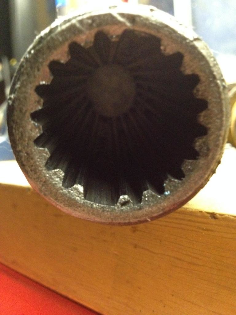

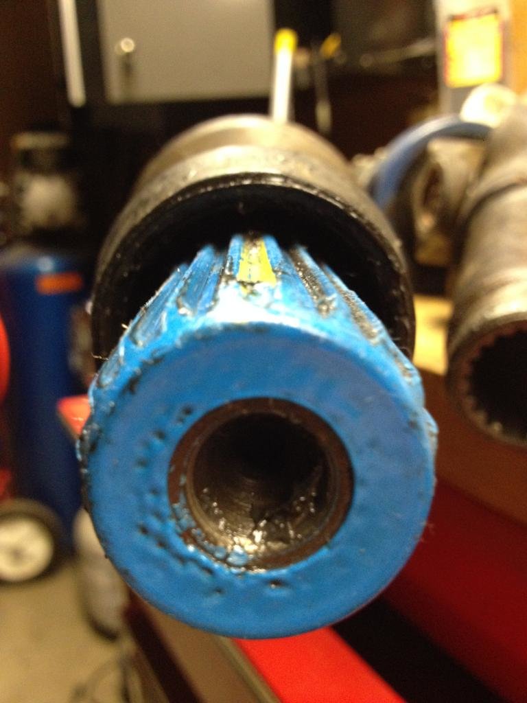

    My stock driveshaft disagrees with that statement.
    For the OP's purpose, your idea will work. It has two slots so you can flip the tail section 180*. It's even marked with yeller paint from the factory so you can't hose it up. When you get it flipped and back in, use an angle finder to ensure both the front and rear shaft are at the same angle or you'll get vibes. You can put carrier bearing spacers in to adjust.

    looking at the female side it looks like there are 2 indexing splines (the fat notches). Are there the same 2 larger splines on the male side, or are there 20 total same sized ridges on the male side.

    I see the "yeller" paint on the male splines... but what about the female splines?
