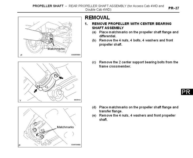

    I was able to grab & crank the shaft back and forth a few degrees, or whatever the play is. When I unbolted the bracket, the drive shaft drops right down. I used a jack to hold the weight. The expansion piece with a boot on the rear part of the shaft stretches out, but the shaft doesn't come out of the transfer case.
  4. Nov 14, 2015 at 3:24 PM
    muisejt
    muisejt Well-Known Member
    Nov 12, 2011
    #66923
    235
    YMM
    08 TRD Sport DC LB
    Katzkin, Bi-xenon Morimoto Mini Stage III Kit (D2S), 4Runner Mirrors, Complete Stereo Upgrade with Backup Camera, Pop&Lock PL5400, Extang Solid Fold Tonneau, TRD OR Tow Hook, rcbs204 4x4 Illuminated Switch, Grillcraft, 10" Rigid light bar behind grill, relocated horns, Redline Tuning hood struts, 5100's with 883 and Wheeler 5 leaf, OME carrier barring drop kit, ECGS Bushing, MarionB2B front hubs

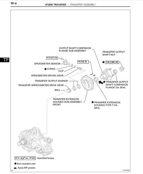

    there are 4 nuts to remove (torque to 65 ft/lbs when reinstalling)
    then there is another nut to remove the flange (torque to 87 ft/lbs when reinstalling)
