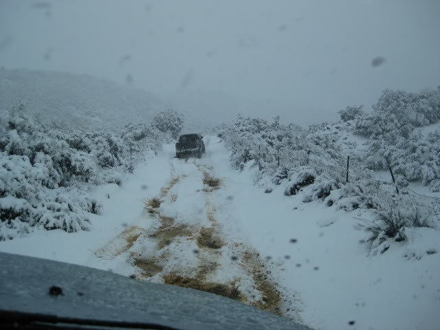

    Tire quality has a lot to do with biting into the snow and not slipping. I was running Hankook Dynapro ATMs and was very happy with them in all surfaces.
    I used my A-TRAC + Rear Locker with great success. I was not in as deep a snow drift as you probably where (I am in San Diego after all), but this was up about 4,000 feet in our mountains.
    You know that with the rear locked, the A-TRAC only activates when you have nearly stopped (becoming stuck), ie. under 3 mph...

    P.S. Left side of truck was in deeper than y'all's photos, right side was shallower.
