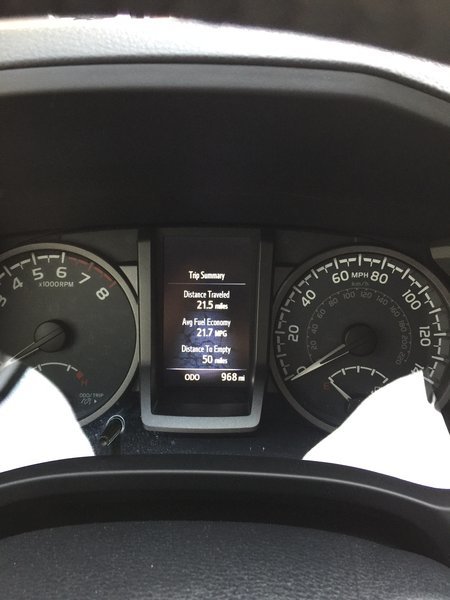

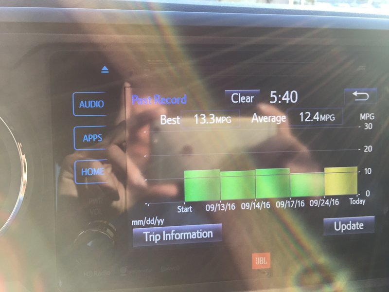

    So I have a 2017 DC4x4 and I have been getting somewhere around 12.5 mpg. I was stressing it because everyone was getting 17-19 mpg on average. AND I know about driving conditions but I dont drive aggressive nor do I think I would average 5-7mpg less if I was trying to get it up.. I kept racking my brain to figure it out. I randomly heard a noise when I went over a steep incline/decline, like a grinding or the drive train not functioning correctly. It made me wonder it I had a hub that was not correctly locked or the 4x4 did not disengage. I took my truck to the dealer for the noise and brought up my concern to them, including the head tech there. I had a 20 min conversation with him... he told me it was the mud flap and my truck was getting 19mpg... he is full of crap. my truck was getting 12/13 on average. the eco said that and the math on fill up confirmed it.

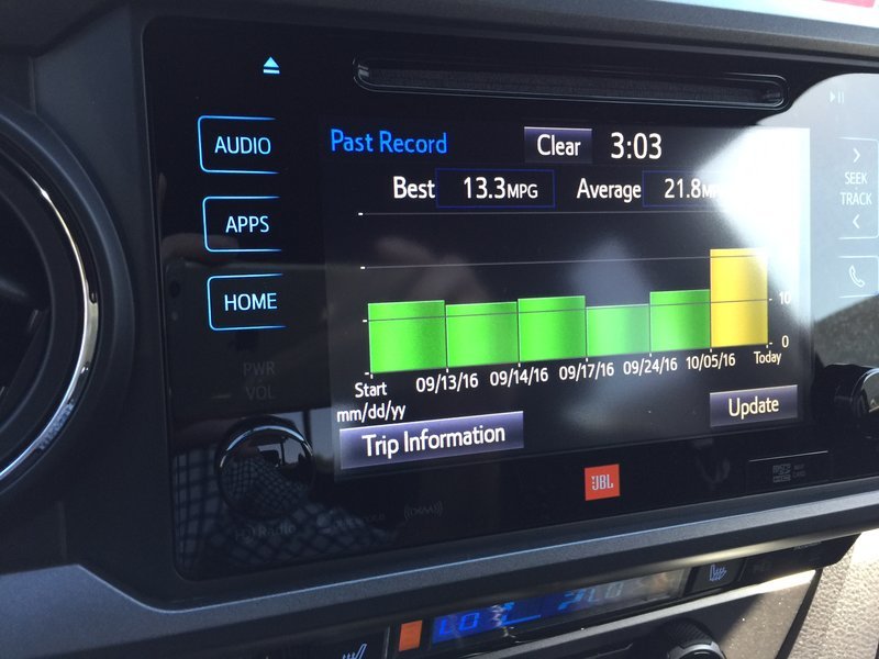

    when I brought the truck home, after they did nothing for the noise or mpg, I started playing around with the 4x4 and engaged and disengaged it several times... and one of the times i heard a noise that sounded just like the one I heard while driving over an aggressive driveway. After the noise it would engage/disengage fine!!! and guess what, the noise was gone when I went over the driveway and my MPG shot way up!!! almost to 21/22. at one point on the highway i was getting 24/25... so moral of the story... There are a few people that have complained like I have about the mpg being so low.. I suggest you play with the 4x4 several times and make sure to do it in neutral when doing so. I think people play with the trucks and buttons at the dealer and they dont care when they deliver it... I hope this helps you! btw I havent had the chance to take mine off road so I didnt even think the 4x4 could be the issue until I remembered my manual hubs on my 89 toyota... dont forget to unlock!!

    16 TRDORDCSB 4x4 A/T (loaded w/ JBL)
