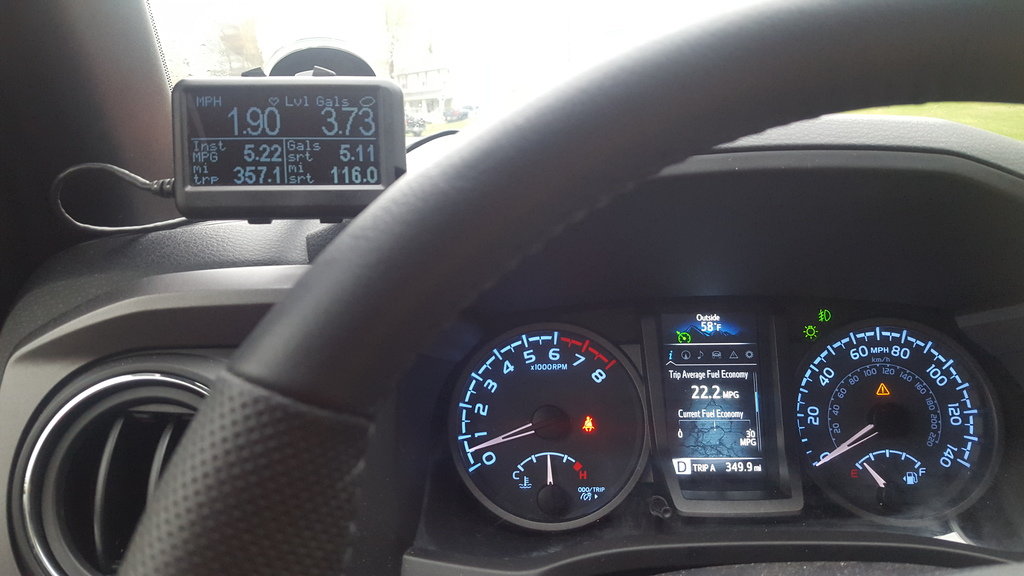

    Ok, so all of you who are saying that I would notice if I was in 4hi/4low... thats not the point Im making. The truck was sending power to the front wheels robbing me of MPG. It would try to engage randomly with the truck was under extreme flex/stress. The pics I posted where before and after playing with the 4x4 system and there is a dramatic dif in MPG... from 12/13 to 21/22. it was night and day. I have seen other with similar mileage and wanted to show I had a simple fix that could be the culprit. Not sure what the issue is with my 4x4 tcase or why it would cause the mileage to drop. but it did and its been better ever since.

    In the 2nd picture you posted the Trip Distance is 2.9 miles. At that distance, you are almost always accelerating which is what gives you bad mileage. 2.9 miles is not nearly enough of a sample size to gauge what your truck is getting. The picture you posted with around 21 MPG, you also drove for about 22 miles.

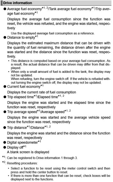

    I have I'm not that dumb. Shows a page of tank and currrent fuel Econ, trip and time, then a blank page.

    The trip details like that only show when you turn the truck off and do not open the doors. Weird, I know.

    As mentioned above, the display in the op is when you first turn the truck off and haven't opened the doors. However, you can customize what is displayed on the normal screen.
