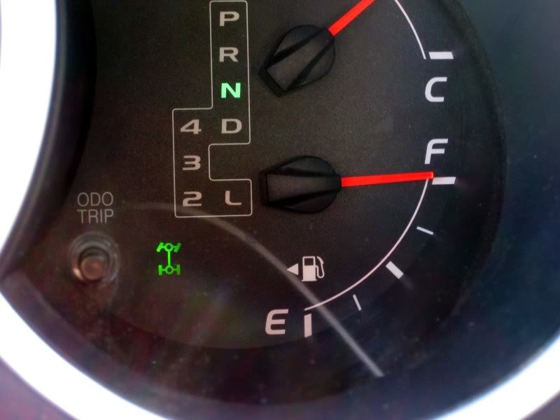

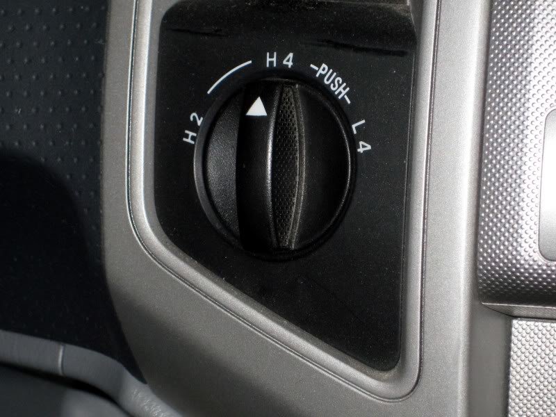

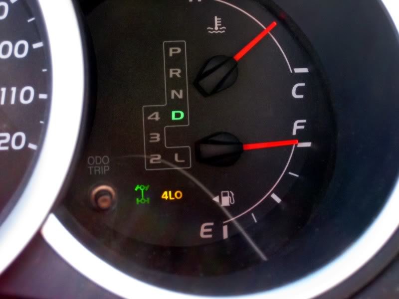

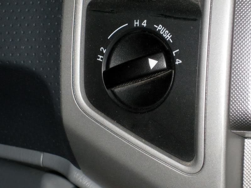

    OK here is a good one my 2011 will not go into 4W low says it is but it lies. And then it won't shift out of 4low even says 4 low when the switch is in 2W or 2H and in 4H it beeps at me and blinks I tried every thing to get it to shift out up and down the drive way backing up even jacked it up and yes indeed it's in 4H. I needed to drive the damn thing the next day about 300 miles 4 wheel drive or not but there was no way I was going to put up with the noise so I disconnected the connection at the transfer case noise went away but it blinked faster. Switched it off, the next morning I hooked it up figuring I would drive it for a few miles and it shifted right out of 4W go figure any way I'll let you know what they find it's only got about 4,000 miles on it.

    Why are you even touching anything? The truck is new, under warranty... if it can't be driven, then let your dealer tow it to them to fix! (Did you ever read the card in your sun visor or owners manual on how to use L4?) Truck must be in NEUTRAL (not Park) or if manual tranny, the clutch must be depressed... to go into or out of L4. If not, beeps and blinks is all you get.
