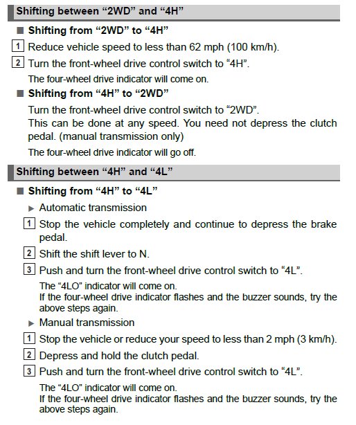

    I's a long thread. So, maybe I missed it. But here it goes.
    I recently had a problem where the truck was in 4 wheel low and would not go back to 4 wheel or 2 wheel drive. Called the dealer. He told me to always place the transmission in N whenever changing among these options. I did it and presto, all was fixed.

    If your speed is below 62 MPH, you can shift in and out of 4H all you want, so OP was OK there.
    The road surface won't have any effect on the system, but driving in 4H on dry roads is obviously a bad idea, so again OP was OK in the rain.
    You don't have to depress the clutch to switch in and out of 4H with the MT. I switch back and fourth all of the time while in the snow. I think you're thinking of 4L.

    manual says 45 to 50 MPH and I have found on my 2018 6 speed Manual Transmission it is Yes I can Turn the selector switch anytime to 4 Wheel High (not 4 wheel Low) it will engage However when Disengaging I have found that it will keep blinking until I push the Clutch pedal down then it flawlessly with out any sound disengages I have done it without and waited ...Waited ... and waited then I could feel a bump... and it disengaged I really did not care for that so I have decided to treat it the Same way I do with My 2000 Toyota Tacoma with the 5 Speed Manual Transmission and Not worry about Fucking it up.

    That's only the case for 4Lo. You can go in and out of 4Hi regardless of where the clutch is.

    Got it .... habits from the Older 2000 Tacoma carry over into the newer Tacoma and Certainly don't hurt to follow the older Tacoma has the manual shift lever and You do have to press the clutch for that to disengage smoothly and to engage it smoothly.
