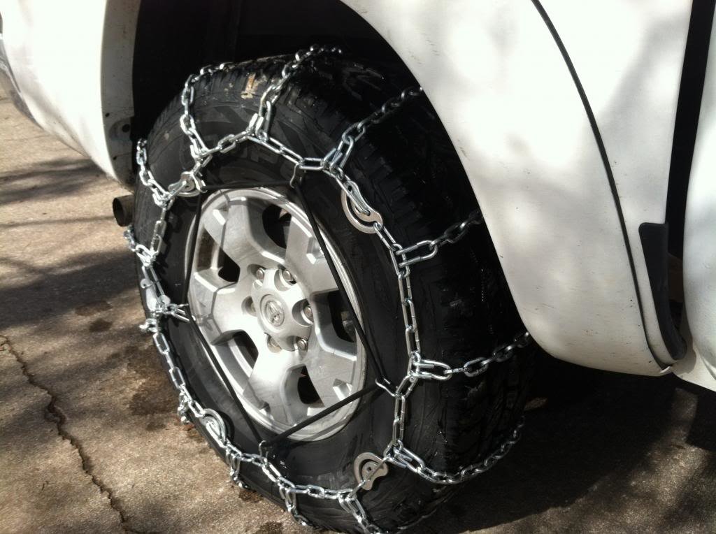

    I have a set of RUD Grip 4x4 chains for the rear. They were around $140 shipped to my door. It is my understanding that it is German chain assembled in China. RUD and Pewag have some better offerings, but they are German or Austrian made, hard to find in the states, and significantly more expensive. The only way I could justify the money is if the truck was chained in November and stayed that way through winter, but I have only needed chains once before. I think my recommendation is a good compromise.

    The square link is the same style as the mud service chains, I think the mud service are the largest links. There are different size links available on the square link. I put myself in ridiculous situations because I knew these chains could get me through, I never had a failure that wasn't because of user error. I've worn out a couple dozen sets of chains, and nothing wears as well as these.

    The first picture shows the clearance limitation at the knuckle from the top fo the tire. The bump where the problem seems to exist is partially black because the grime was wiped off when I pushed a piece of clay between the tire and knuckle. That was the only way I could think of to get any kind of reasonably close measurement.
    The second pic shows the limitation from the front of the tire. It may look like there is more than 1/4" of clearance but that is because the clay cleaned up the tip of the bump and the black doesn't show up well in the picture.
    I'm not sure what to do next. Maybe I will cycle the suspension and take additional measurements at the UCA, LCA, cab mount, and pinch weld. Maybe I will just punt and spend my time cursing the damn Toyota engineers that couldn't imagine users like me needing front chains on occasion. Or needing to haul anything, or better approach/departure angles, or larger tires...oh well. All in all I guess they made a pretty fine passenger car. Sorry, light duty mid-size truck.
