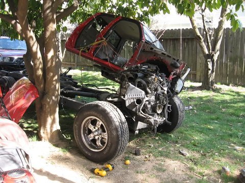

    found the answer for how to lift the cab up high enough...
    Pretty ingenious
    1997tacomav6 likes this.
