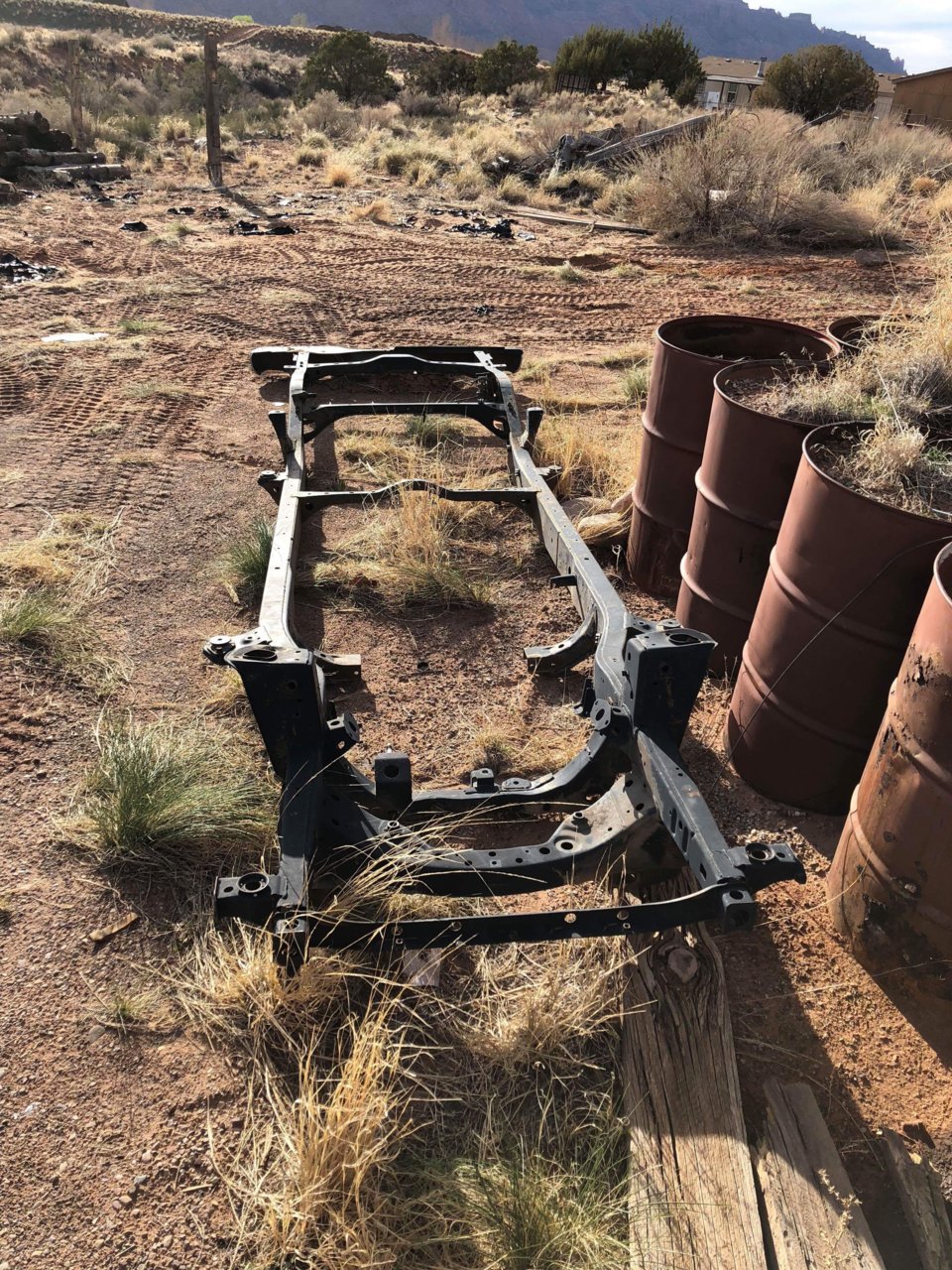

    Well, I bought a frame, and it’s in great shape. Ran a borescope down in there but could immediately see that there was no rust. Just some surface stuff on the external faces. I guess it’s about time to make a build thread... haha
    How do people go about naming their build threads?32B67F19-3CA9-4C45-88AF-CA6F9DD14784.jpg

    Dalandser
    Dalandser ¡Me Gustan Las Tacos-mas!
    Feb 19, 2015
    #149090
    17,645
    Anthony
    Downey
    08 PreRunner Regular Cab / 98 4x4 Extra Cab
    Empty Wallet Mod
    Let the build name itself lol suggestion "I'm totally inframe to be doing this" build
