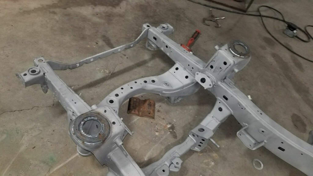

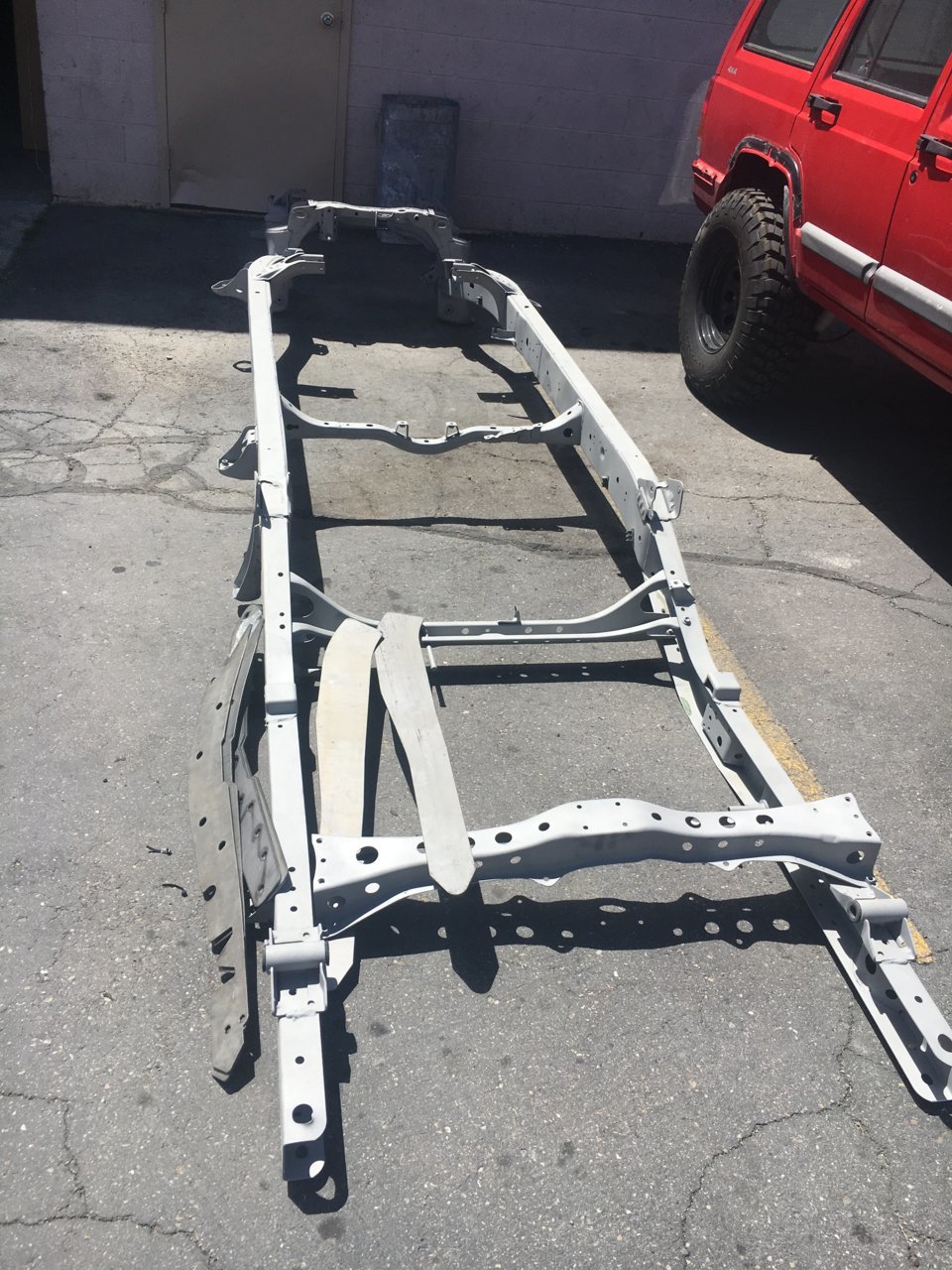

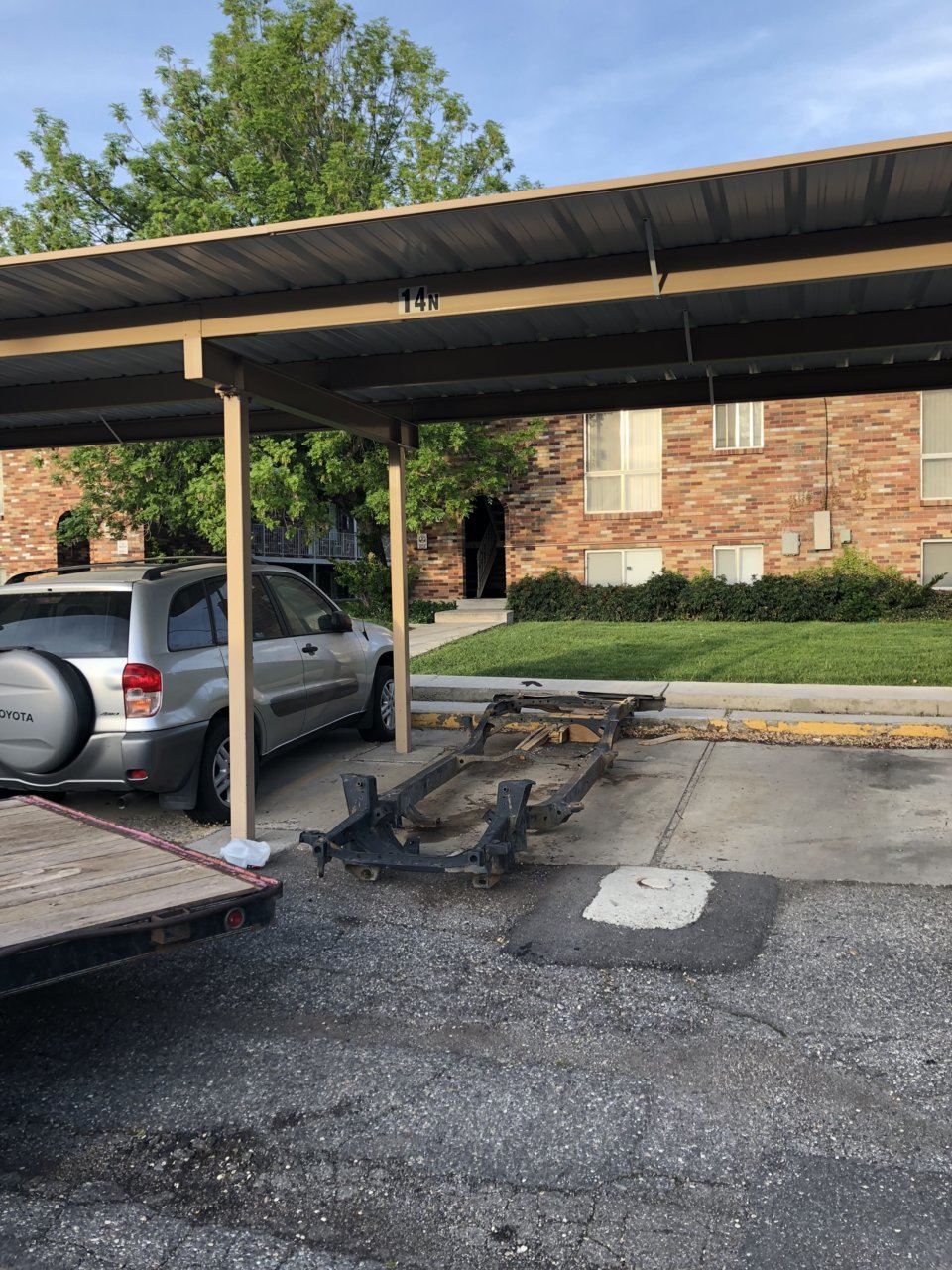

    Obtained the '98 frame! I'll be hauling it off to sandblast before welding, then back for the powdercoat... Hmmm what color should I get it done? I'm thinking black, blue, green, or red.

    #126
    Dalandser
    Dalandser ¡Me Gustan Las Tacos-mas!
    Feb 19, 2015
    #149090
    17,609
    Anthony
    Downey
    08 PreRunner Regular Cab / 98 4x4 Extra Cab
    Empty Wallet Mod
    Green like the $ you'll be throwing at it :spending:
    How much? ;)
    ZrowGz[OP] likes this.

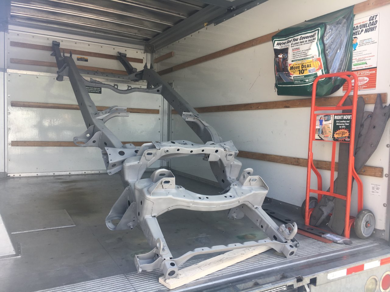

    Finally sandblasted and dropped off for welding of the rear plates. Just an FYI for anyone, you can fit a frame in a 17' uhaul. Just. Barely.
    Lol when I picked it up I asked "why is it grey?" I thought they had primer coated it or something. Nope. Just super fresh raw steel!
    Looks like I might be hauling it to Seattle to do the frame swap at the end of the month. Oof. Will have to build a rack to carry it with and will look super derpy.

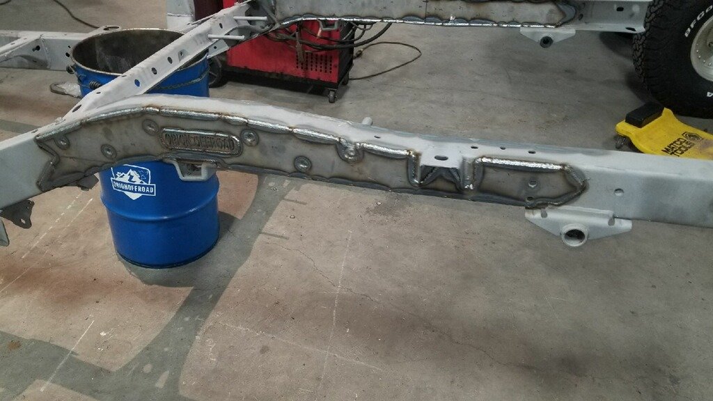

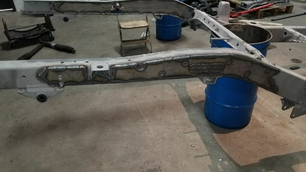

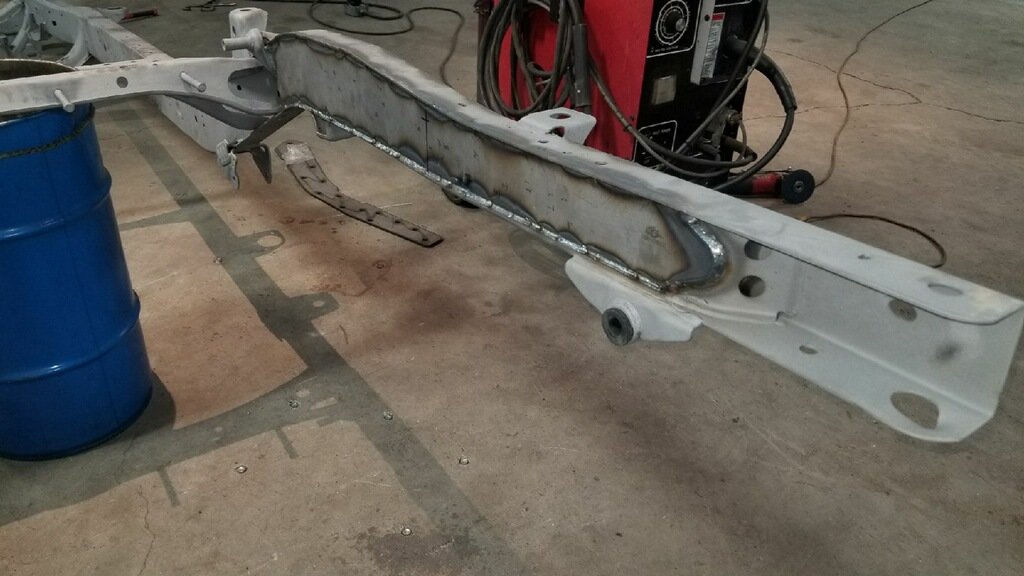

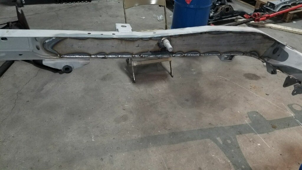

    Welding done.
