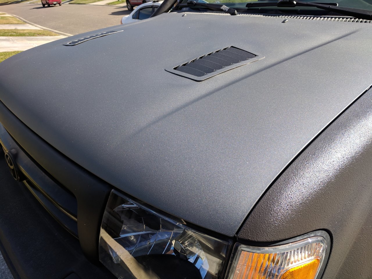

    I forgot to mention. I pulled the hood off and had my buddy powdercoat it. It was fading when I purchased the truck and had a couple of dings that I replaced with vents. He charged me like $30.

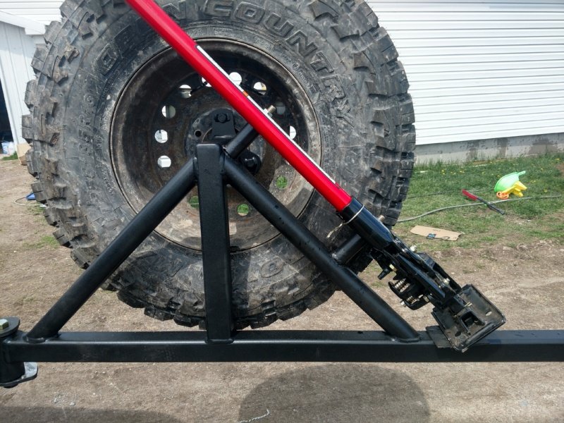

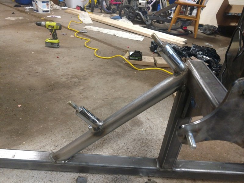

    Sorry didn't post pics when it arrived, but I got it Thursday last week, waiting on the doorstep after a work trip. Since I forgot to order a hilift mount, I decided to do it my own way and made my own out of a couple bolts and extra sockets (I hardly use my SAE's anyways!)
    Sanded and mostly prepped for some Rust-Oleum rattle can bed liner. I used this stuff on the rocker panels of my van and it's still holding up well after 3 years. I think most of the neg reviews come from folks that don't prep at all... This stuff needs a clean rough surface to addhere properly. But...it's still in the 30's at night here, so I'm gonna wait to paint...
