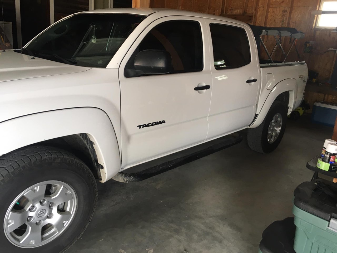

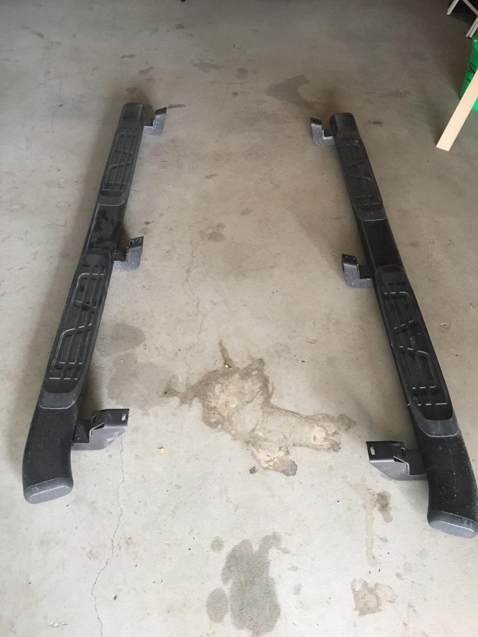

    Picked these 5” Oval running boards awhile back, they came off a TRD Pro DCSB (don’t know year, but was 2nd Gen). Questions;
    1. Will these bolt directly right up on my 2010 TRD OR DCSB without issues or modifications?
    2. Tried Googled, but could not locate anything on mounting hardware. Anyone know the OEM part number if there is one or what parts would be needed?
    TIA

    1. Yes, if they are both DCSB's then they should bolt right up.
    2. The only hardware needed is the bolt/washer combo that would have come with the steps. They bolt directly to the rocker panels. You should currently have plastic bolts in place that you could use to figure out what size you'll need.

    Unfortunately I bought these used with a bundle of other parts and seller did not have mounting hardware. No bolts in place that I saw, since I have other steel running boards already installed.

    If the existing ones mount to the same location, you could probably use the same hardware.

    Yes. They will mount right up. Did this a few years ago. Steps are useful for me.
    The bolts you'll need are: 8mm diameter x 1.25mm thread pitch x 40mm length,class 8.8 steel.
    You will need 12, along with 12 flat washers and 12 lock washers of the same 8 mm diameter.
