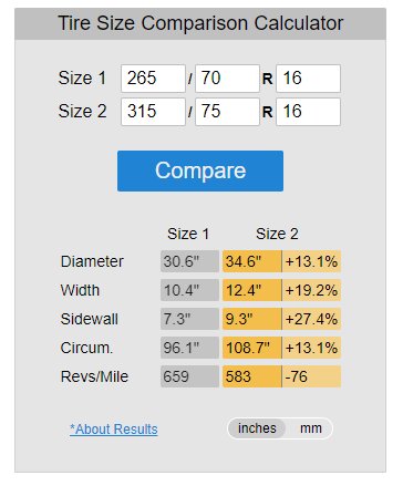

    Sounds about right. You might get another ~1mpg w/a tune. Don't forget that your speedo and odo are off by around 13% with a 35 inch tire vs the stock 31 inch tire. So if you haven't factored for that then you're getting around 13.5-14.5 mpg, which is downright respectable! :rofl:

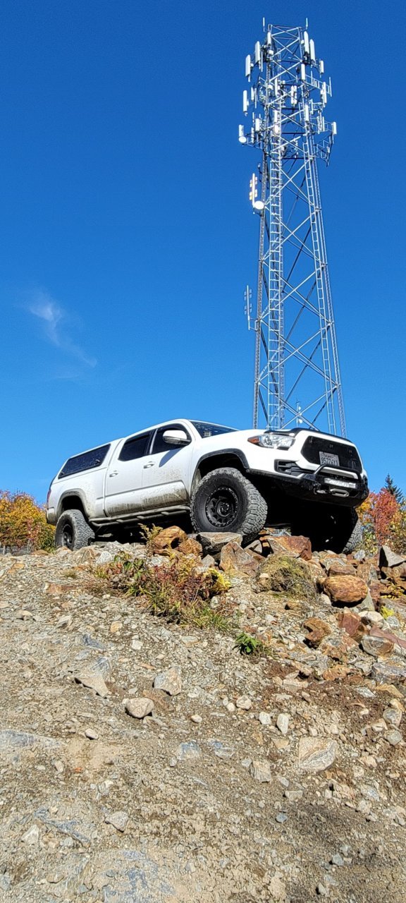

    5.29s, 35s, and ovtune. In California where I ran 75mph + all the time I was getting 14-15. Now in New Hampshire where I rarely go above 60mph I get 17 to 18mpg 20211007_133154.jpg

    Damn impressive for carrying armor/sliders/bumper/winch and NH terrain. :thumbsup:

    Also.. are you going by what the trip computer tells you? If so the calculations are not corrected for your larger diameter tires.

    Yes, I am actually. Which is wrong apparently. Are the percentages in the above comment correct?

    Yes, look accurate to me. Your exact tire size may differ slightly.
    tiresize dot com
