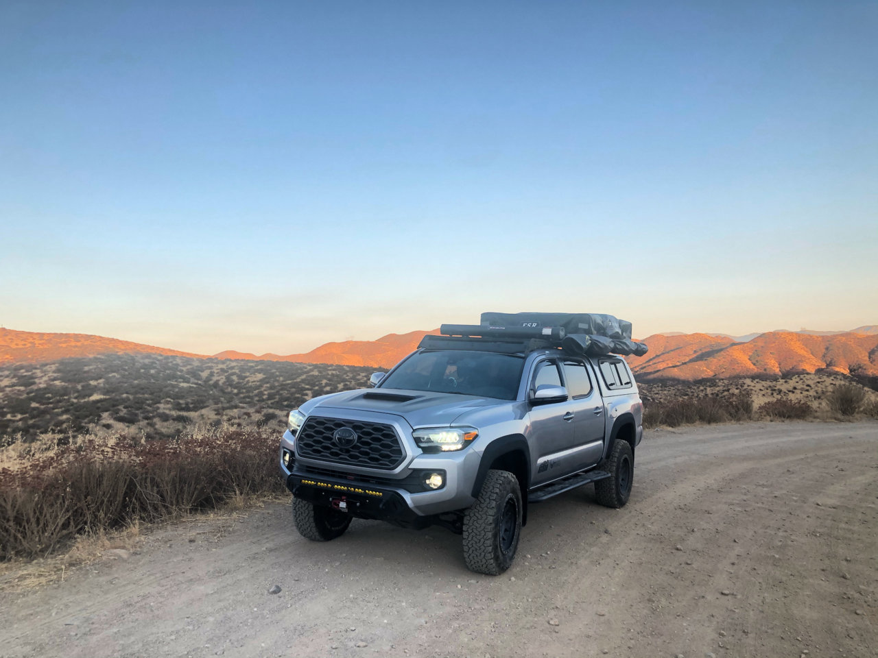

    I’m on 265/70 R17 KO2. 3 inch lift and about 650-700 pounds constantly in the bed area. RTT and shell and other stuff. 5.29’s installed with a Nitro Worm gear in the rear - similar to a D-tru trac and ARB locker up front. I couldn’t be happier. Truck is very responsive and shifts like it should. I’ll probably get closer to 33’s once these tires wear out.
