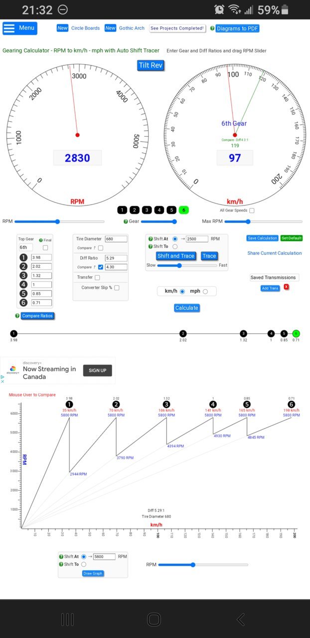

    https://www.blocklayer.com/rpm-gear.aspx
    A tool to play with...

    Why did you decide to go with the 2.7? The shop told me to expect around 2,800rpm at 120km/h, which isn’t much different than my old 4.0 Ranger in 5th.
