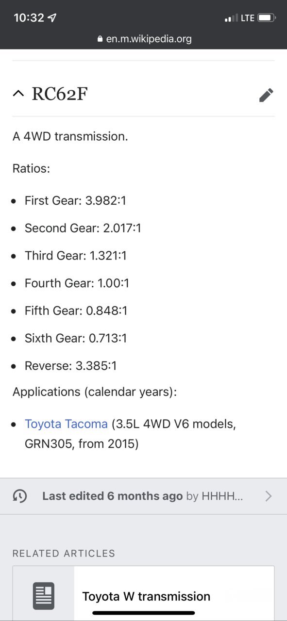

    I’m a second gen manual on 35s and 4.88 but thought I could provide some insight. I intentionally overgeared with the intention of maybe going 37s one day. On the highway, I cruise at 70mph at 2,800 rpm in 6th and it’s very manageable.
    Playing around with the Grimm Jeeper calculator for your transmission, axle ratio and tire size, you’ll be better off than I am. At 70 mph in 6th gear you’ll be at 2,600 rpm. These trucks don’t mind maintaining higher rpms on the highway.
    If you were to go 4.88 you would be at 2,400 rpm on the highway.
    Here is the calculator. The RC62F isn’t on the drop down menu for transmissions so I input the ratios manually.
    http://www.grimmjeeper.com/gears.html
