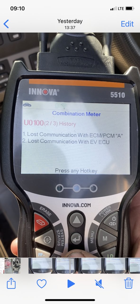

    No i was going to buy a salvage ECM for $135. After a little research and learning there were a couple more computers, my scan gauge showing (pic) 2 ECM codes, my fuel pump which was previously engaging (stopped), secondary air which would turn on (stopped), i banked on chasing electrical problems that would have bought me a new truck. Not to mention I would have had to jump a couple terminals to reflash to my vin (or something like that, i stopped researching bc even if it worked I wasnt willing to keep chasing problems) I did pull the ECM and there was the beginning of some green corrosion on one of the pins, cleaned and gave another shot...nothing. Thats when I called insurance for the claim. I will be going with a first gen when I find one. I do know of this forced induction system off a second gen that may be available however.
