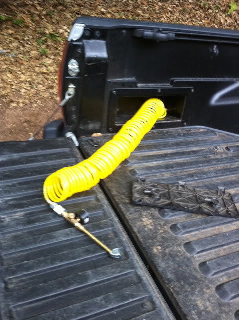

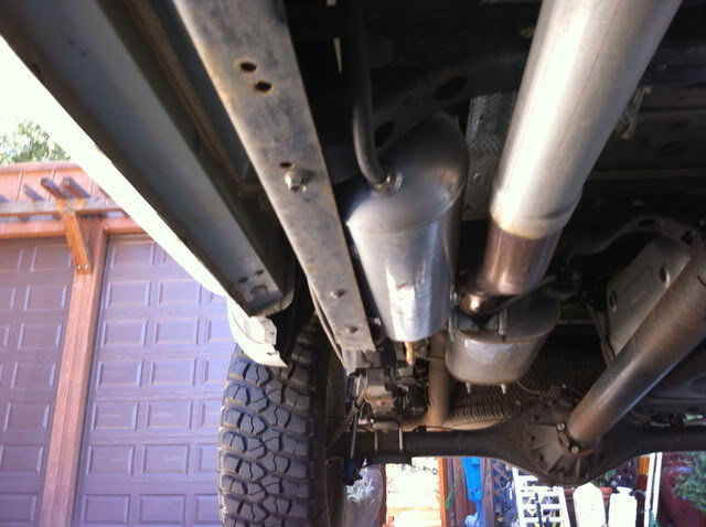

    Ive got a OBA set up more pictures in my build. I find that even at 150 psi in a 2.5 gallon tank it isnt even good enough to go from 5 to 25 psi, I also have a 66% duty cycle compressor from harbor freight thats not to greaet as well

    I like the set up, however, how did you mount it to the truck?? How does the electric stuff keep from getting wet?

    I have a "water resistant" portable compressor mounted to the front bumper support, it gets wet but ive never had a problem, what im going to do when i get an aftermarket bumper and mount it somewhere in the engine bay.

    that looks awesome but is the tank too close to the exhaust? or does that not matter?

    it doesnt matter IMO, the exhaust doesnt get too hot at that point, and the tank has not been effected for about 6 months of use.

    that seems like the best location ever then
