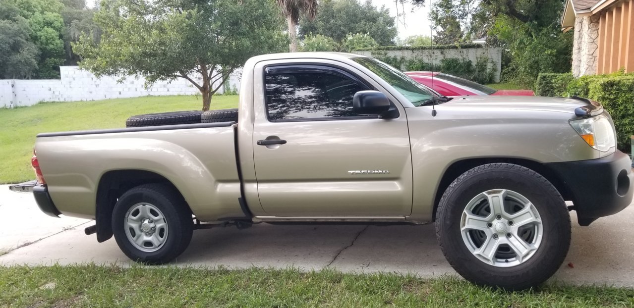

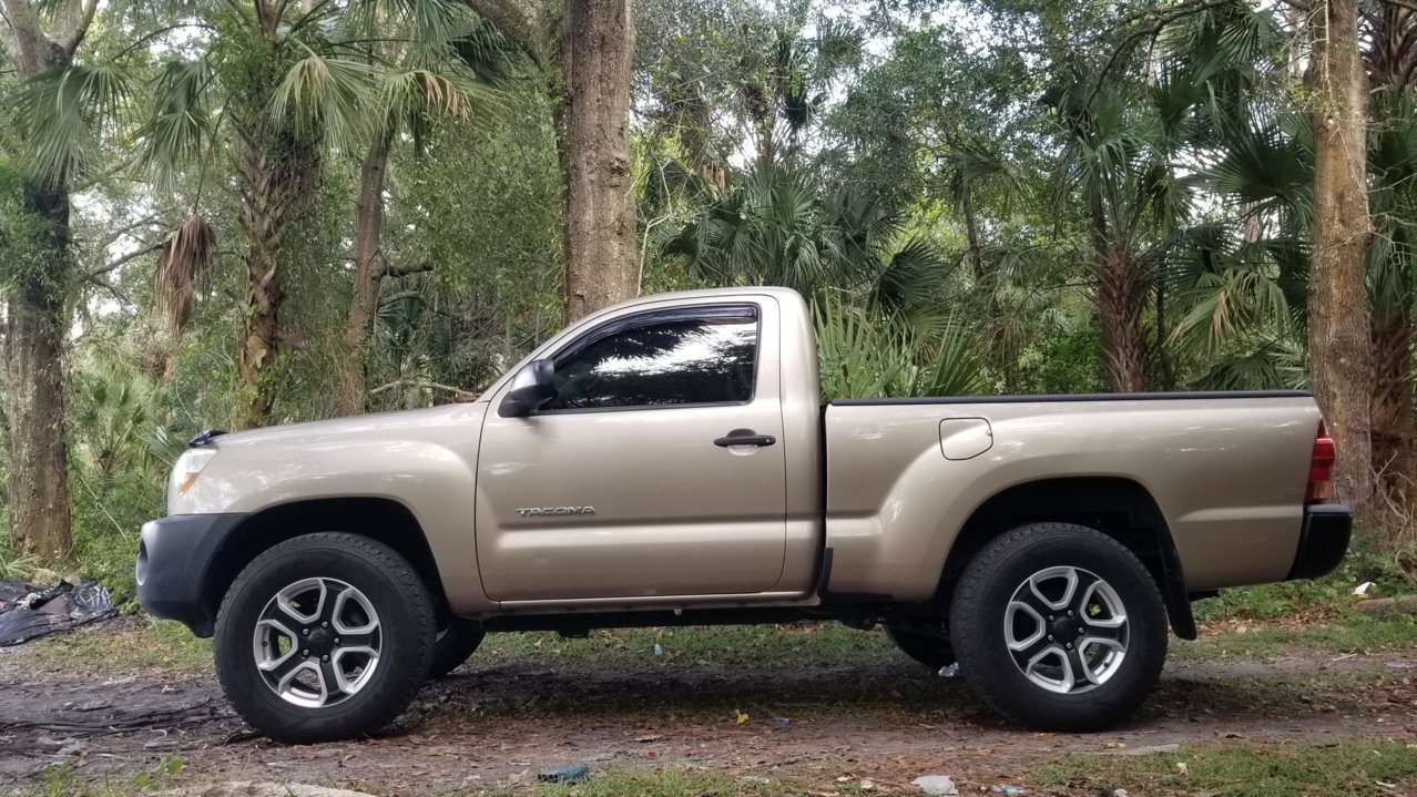

    Hey
    I know its been a while but I figured I would answer
    I am running 245/75/17
    I find it extremely hard to believe that they won't rub w/ out a lift.
    the diameter is much larger than the factory set up
    Another thing to think about is the gearing
    Some say that it would not "need" to be changed....
    but it makes a significant difference on the way the truck drives.
    I ended up replacing the 3rd member on my truck
    and it made a huge difference on how the truck feels
    Here is what that looks like in front of the factory wheel
    The picture above is w/ a Pro Comp lift kit n with a new 3rd member, w/ 3.73 Gears n LSD
    I hope that helps :)
