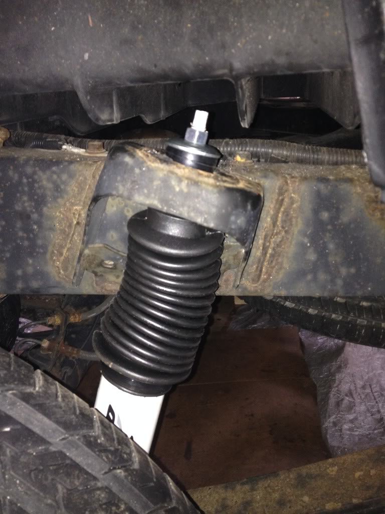

    I just put some Pro Comp ES1000 on my friends 5-lug, that came with the Fat Bobs Lift/Level Kit, what a PITA to put on. And they look to be too long...
    This is with no weight in the back, just sitting level in my garage.
