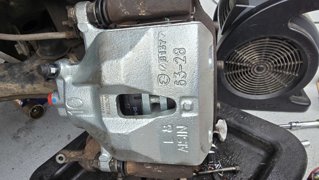

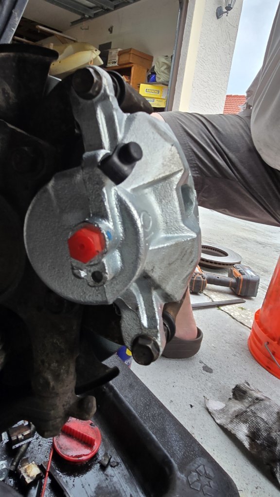

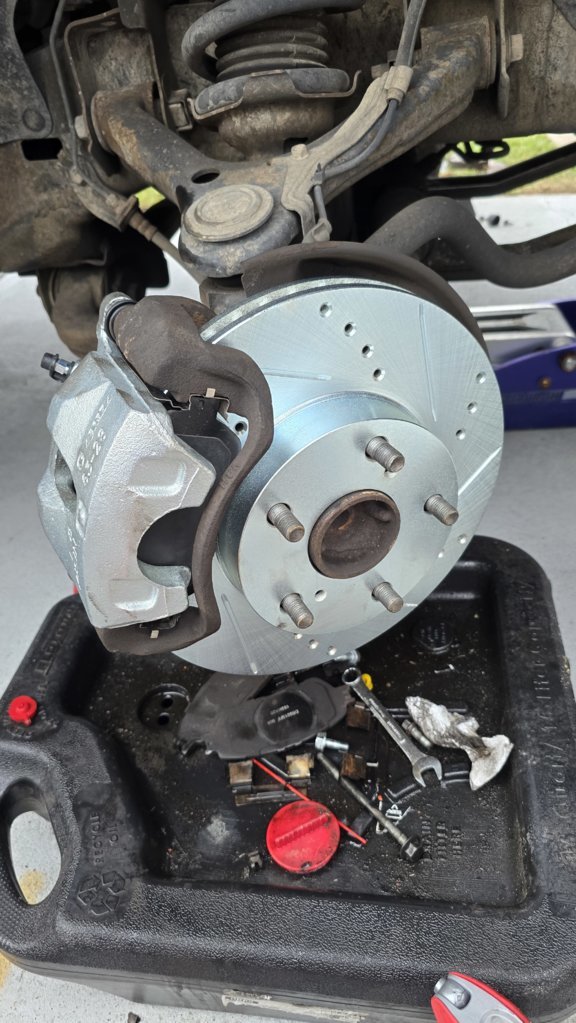

    20250301_172254.jpg 20250301_172246.jpg 20250301_172242.jpg So after that, I decide to got to the local parts house, as I've got a friend that trust me to tinker around, and hears what I find out:
    5 lug tacomas have a unique bracket that resembles the rear vented brake systems on the early 2000s Lexus model, but I wasn't able to dive more into it at this time, however it did confirm that the caliper slides are measured at 160mm. This is important for later.
    Most all other toyotas share this 160mm spacing for their front brakes so long as they are single or dual piston calipers. That means that with next to no modding, or even none at all, you should be able to swap the caliper for a larger bore, and that's what ai was able to confirm.
    2006 Toyota Avalon caliper, but not brackets, bolt on without any issues. The piston size is 64mm, while the tacomas are 60mm (why on earth would they do that?! IDK) and both share the 160mm spacing.
    Now that's all I have for info, so here are the results of my labor, stock rotors, drilled and slotted, Avalon caliper with the stock bracket.
    It stops 10x better than when I first did my brakes 3 years ago.
