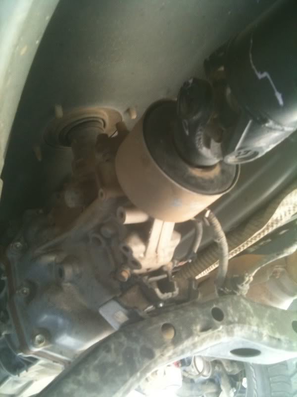

    Could somebody take a picture of the area where the rear driveshaft slides into the transmission on their 5 lug standard cab manual 05up tacoma? I need to know how far into the transmission the driveshaft should normally be.
    Im having problems with a leaking seal and looseness on the output shaft of the transmission probably caused by my lift and driveshaft angle. I think the driveshaft is too far to the back now. I swapped the center section with one from a older truck with different gearing too. Thanks for any help.

    i dont think so unless he has linked suspension .... i have a race pack and at full droop the driveshaft pulls out but no issues and im sure my DS is coming farther out than his. the pinion/ds angle would be my first guess.
    To the OP do u have any DS vibrations?

    No vibrations from the driveshaft at all. Looking at your picture, id say the slip yoke looks right. Im thinking now that a bad U-joint on the differential side may have helped cause the problems on the transmission side. I replaced the seal on the trans and both driveshaft u-joints, but the transmission is still leaking. I put 3* shims on the axle to help the angle.
    I thought maybe I could just buy the slip yoke and it would be tighter on the splines, but the dealer shows the entire driveshaft sold together. I guess I'll just have to add oil and hope the output shaft bearings dont go bad on the transmission.
