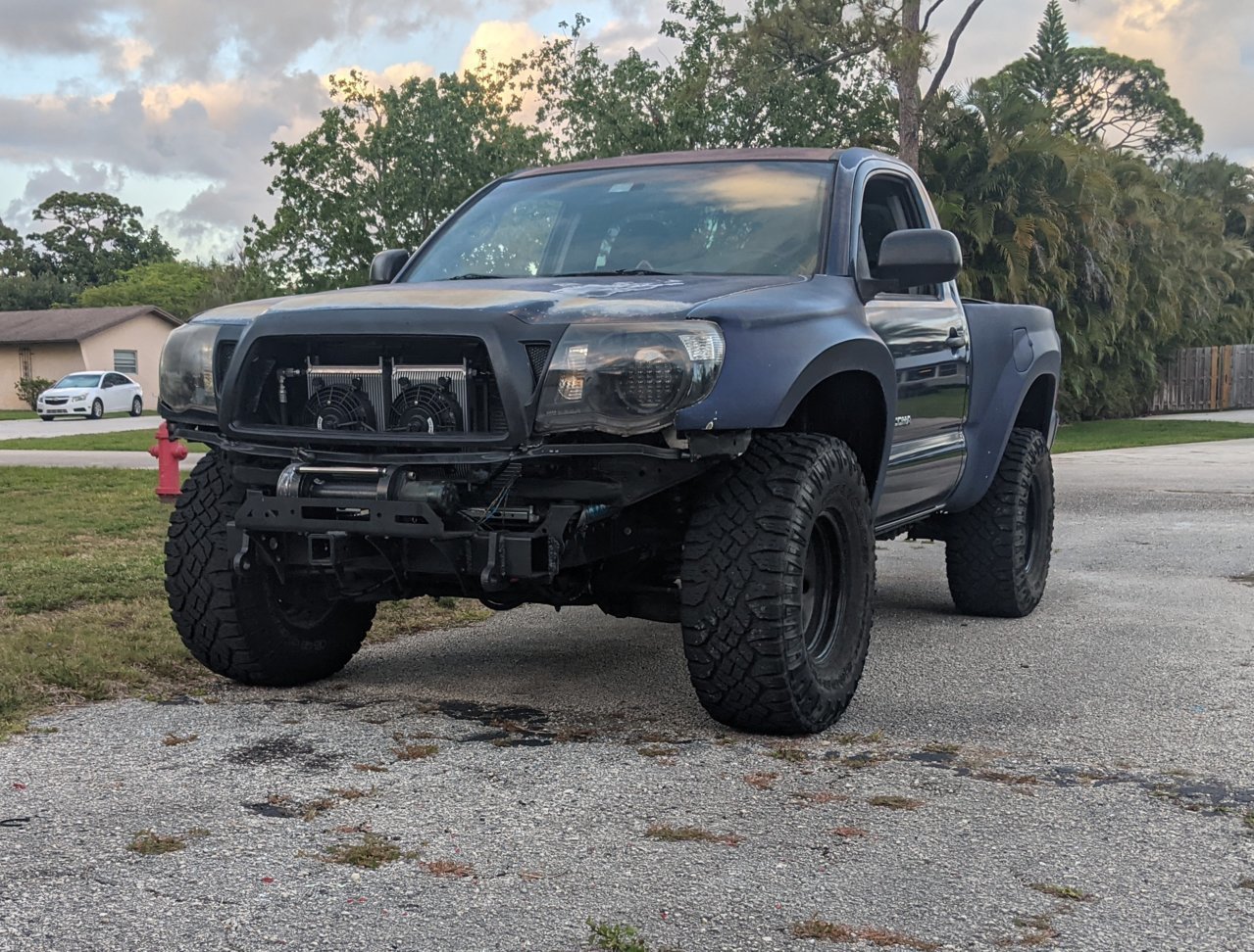

    I was going through my old phone dumps on my pc and found a picture of the truck when it was bone stock. Its crazy how it used to be lol
    It turned into the never ending project lol

    I dig it now! From plain to badass.

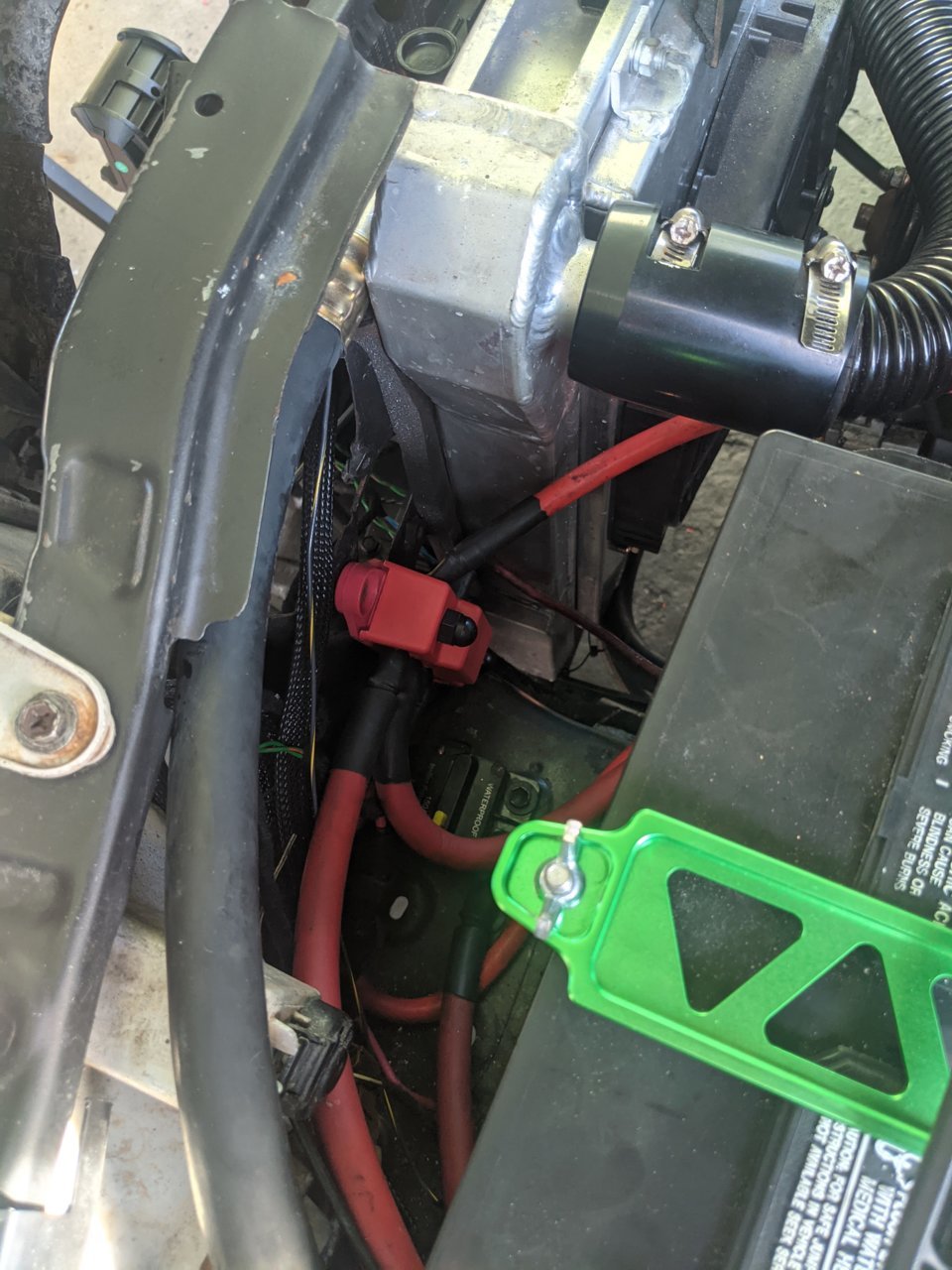

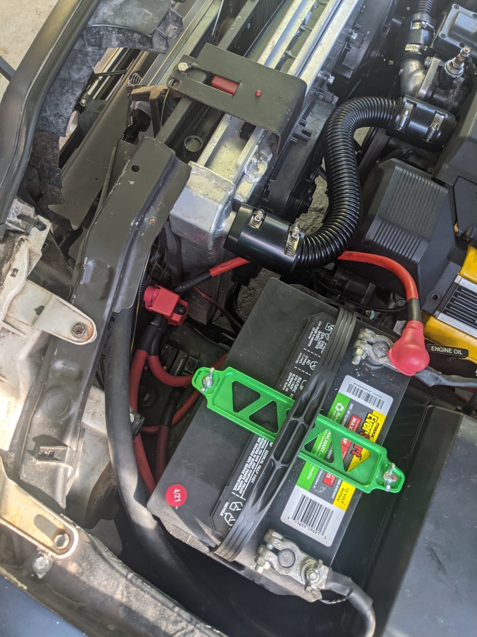

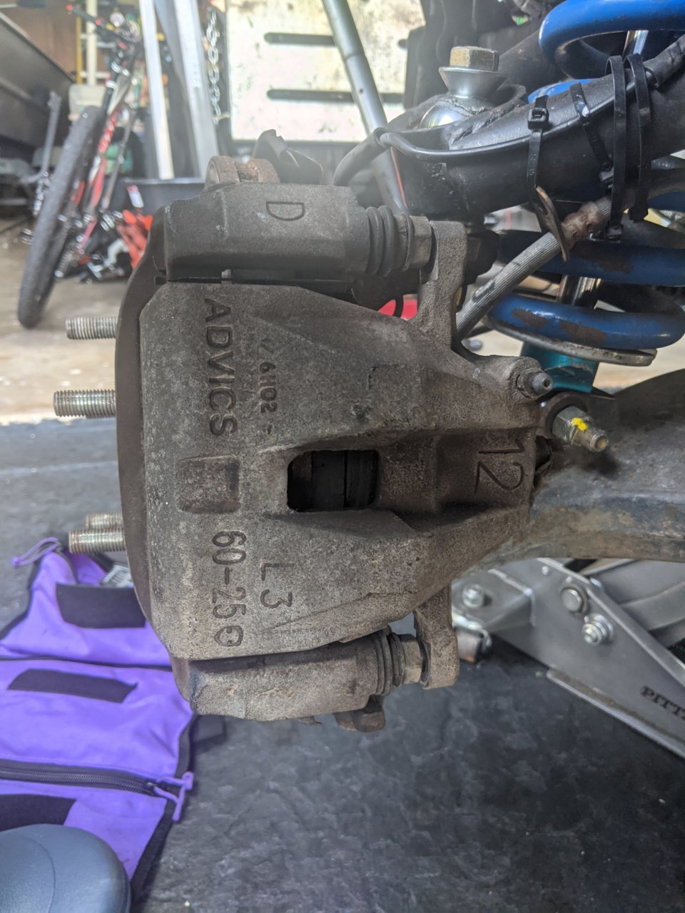

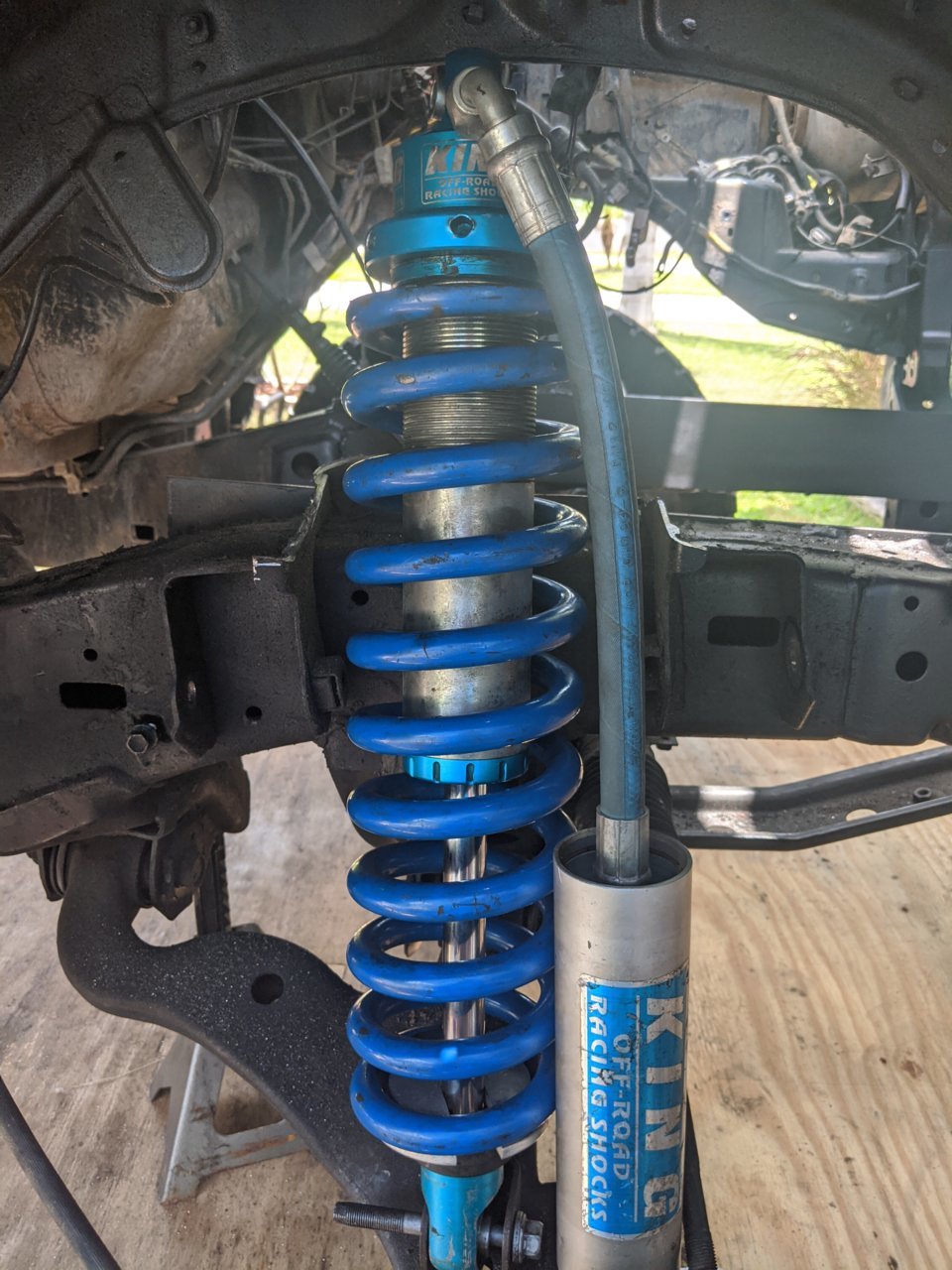

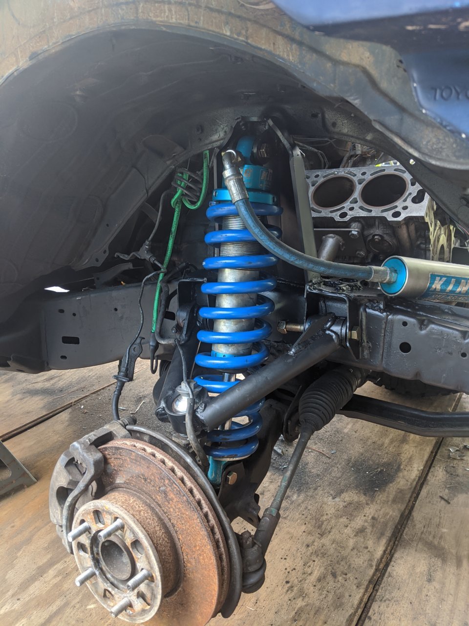

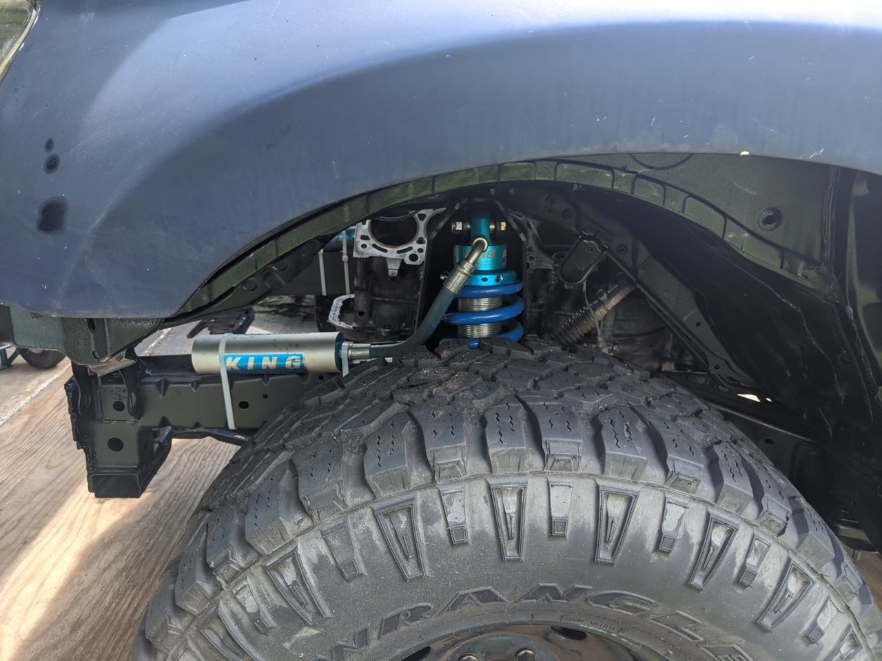

    I moved my positive wires to a bus to clean up the battery terminal. What's funny is I needed to get more 2/0 as the 2 gauge wire I had would barely turn over the starter. Then again when I was originally building the engine I thought something was wrong because it wouldn't turn over with sparkplugs. Turns out I had to double up on the jumper cables lol

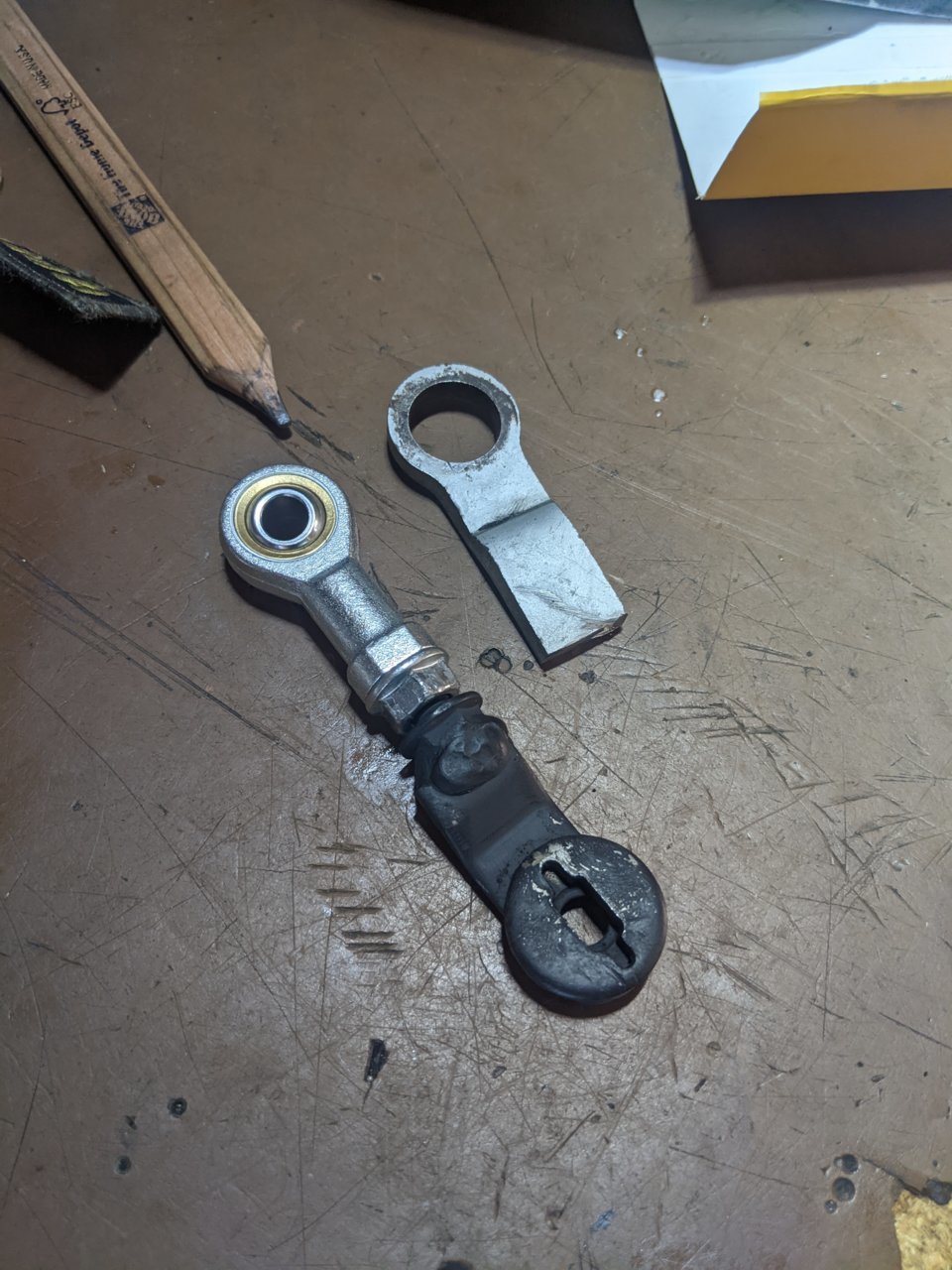

    I also had a rubber bushing disappear on my shift linkage and since I could not find a replacement to save my life, I decided to replace it.

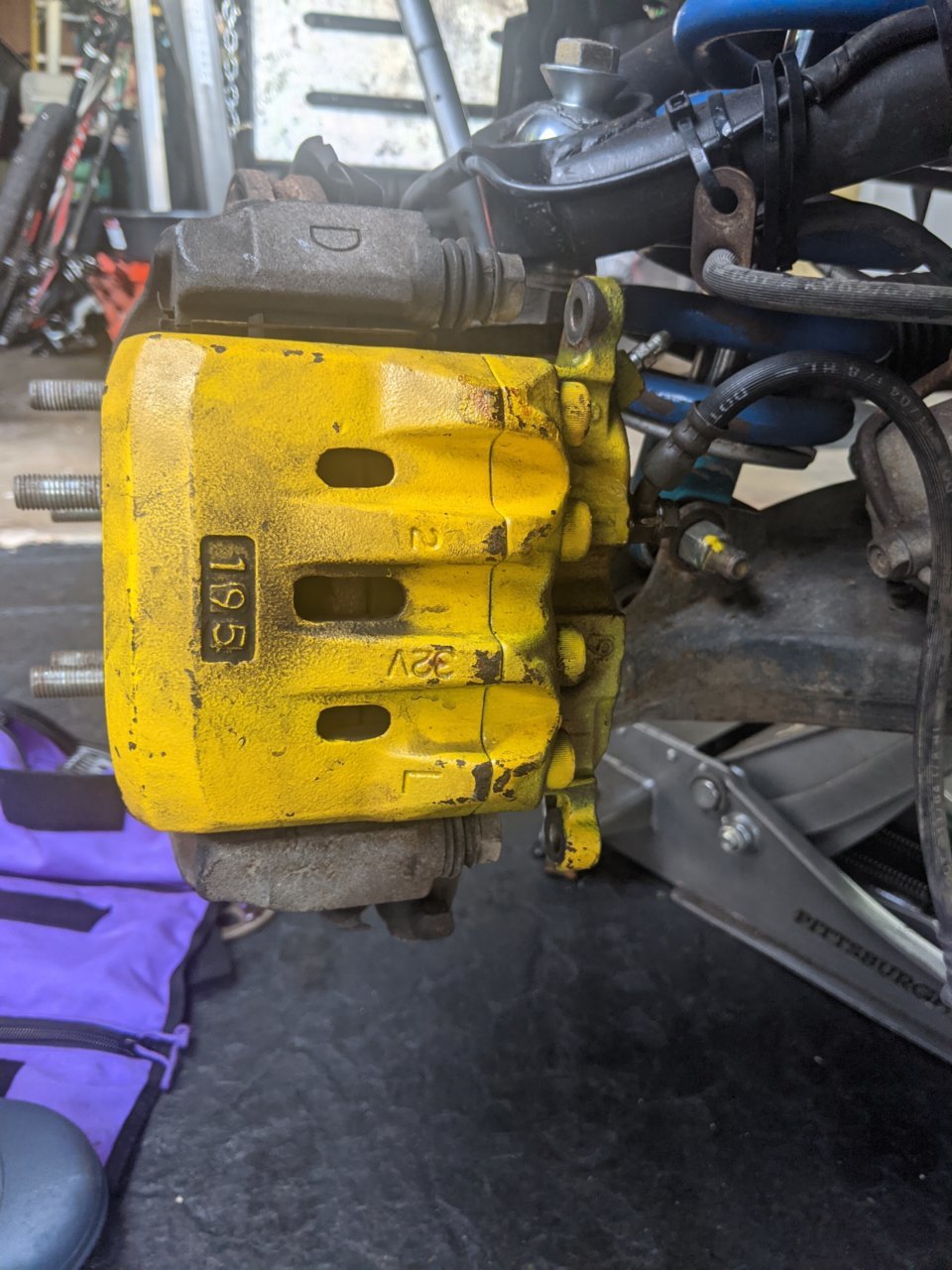

    I'm also looking into a possible brake caliper upgrade using the stock rotors, pads and brackets along with a is300 caliper. This would allow me to go from a single piston to a double. The goal it to first get new pads, rotors and lines and then do some test to see how much of a difference it really makes. Here's a couple of teasers
    Also in the meantime I'm hesitant to take it off road because I've touched so much but I think the time is coming really soon. Also I still need to take more videos lol

    Are the is300 calipers direct bolt in? Or do they require a spacer for the mounting bolt?

    They will require a spacer for the bolt and the pads. Luckily it is a straight shot so no offsetting
