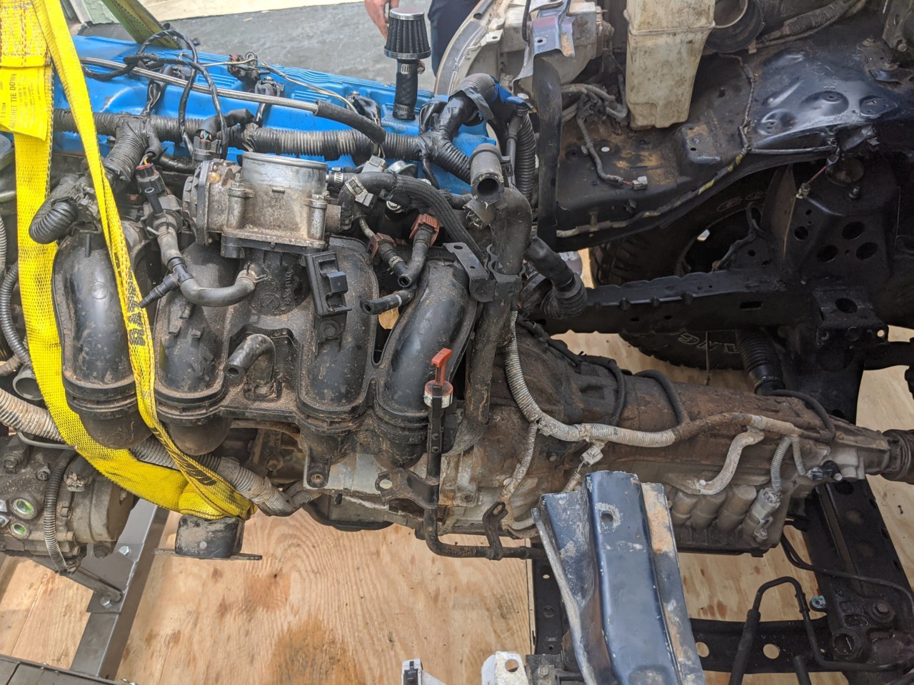

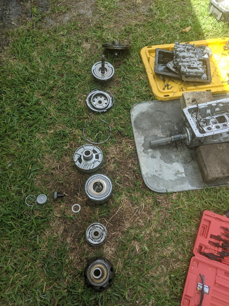

    So haven't posted in a bit but I haven't stopped working on it. I got the tranny apart and replace the rear output shaft to match my current one in my truck. A340 transmission has a couple different types but they are interchangeable.
    Left from right (a340f , a340e from sc400, a340e from a tundra/Tacoma)

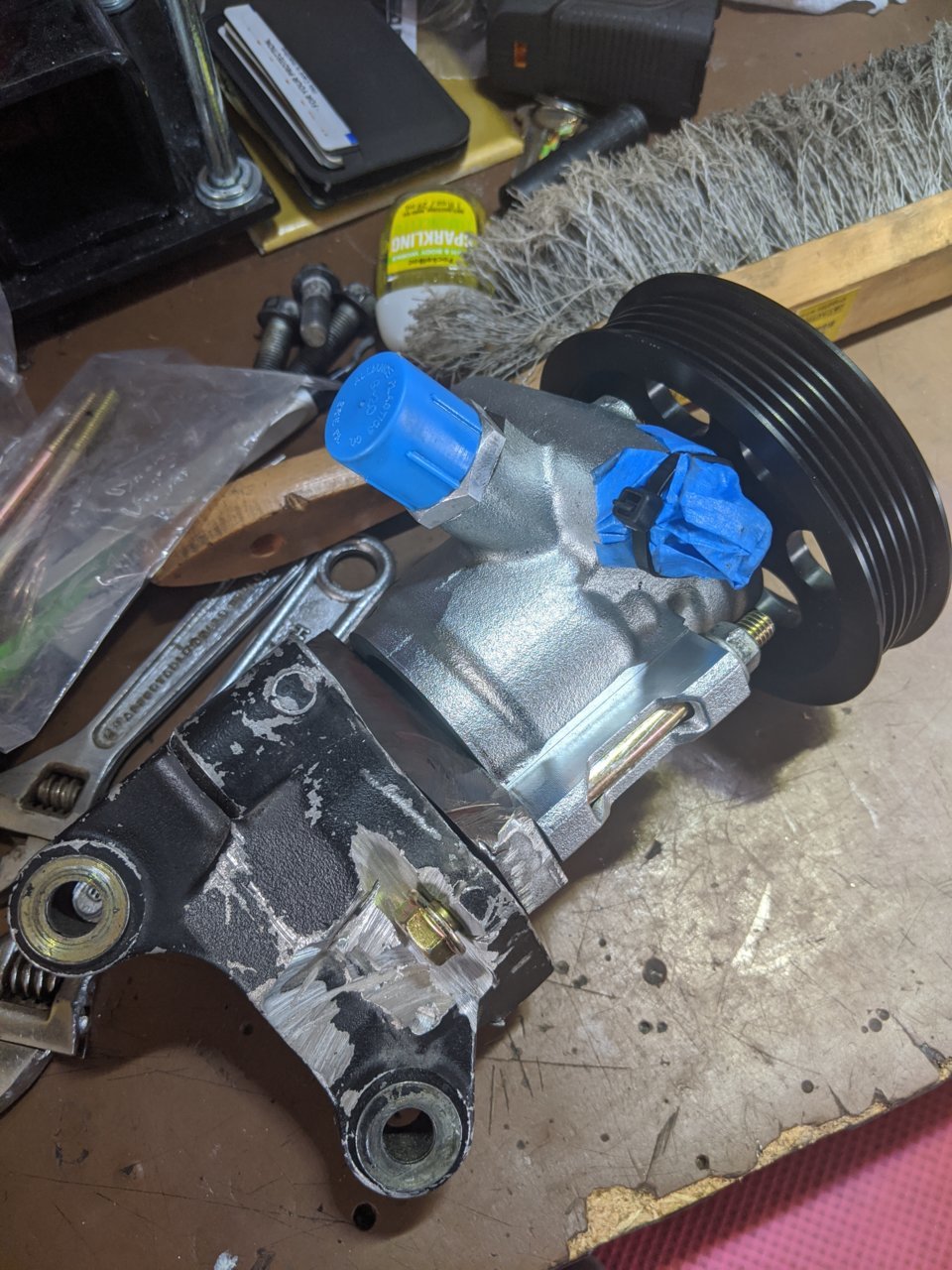

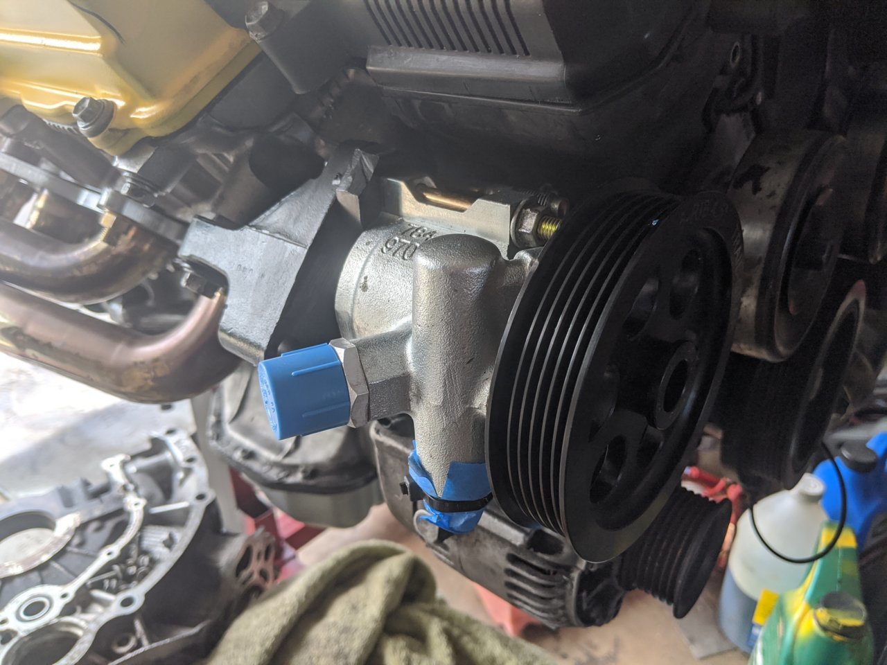

    I found I needed a 1/2" spacer for the belt to fit the pulley properly.

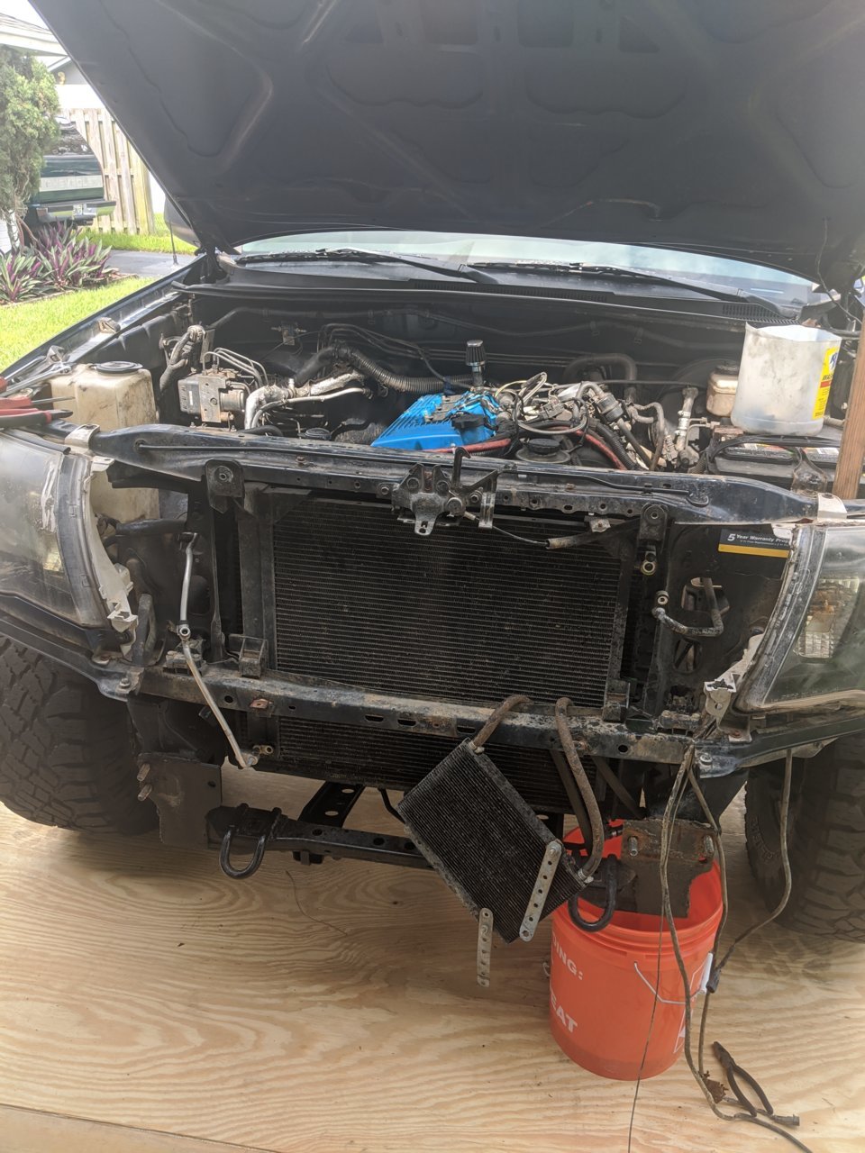

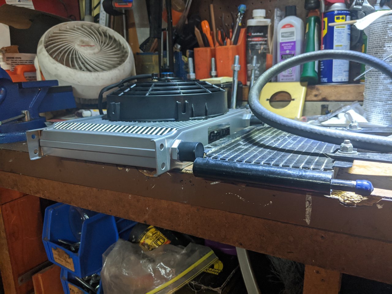

    Got my new tranny cooler, I will be picking up a second cooler for my power steering. My old cooler is on the right.

    So I'm using the tranny that came with the engine (a340e) which is the same tranny that is in the truck currently (a340e). The only difference is how the line pressure is controlled and the output shaft. I'm going to use the tranny that came with the engine so I don't have to worry about the line pressure but I bought an output shaft and tail housing from a tundra that had an a340e and swapped the parts.

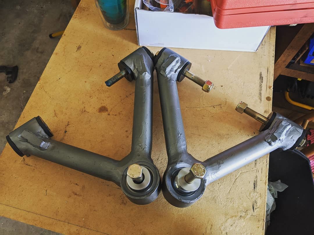

    My not be pretty but they'll get the job done. The next goal is to install them and then cut my shock towers out to make room for hoops.

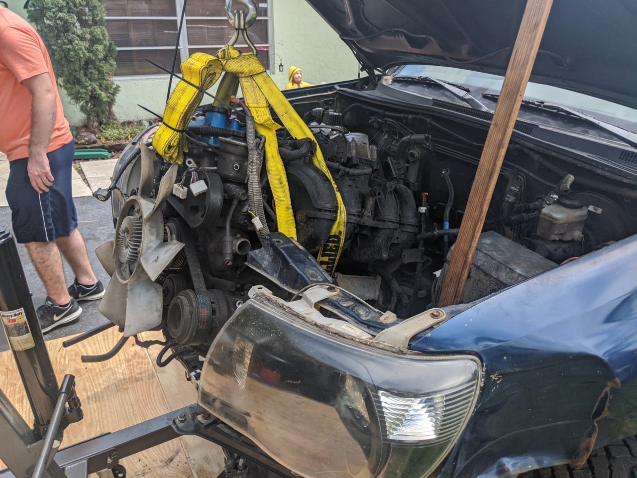

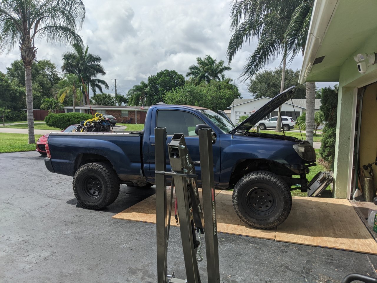

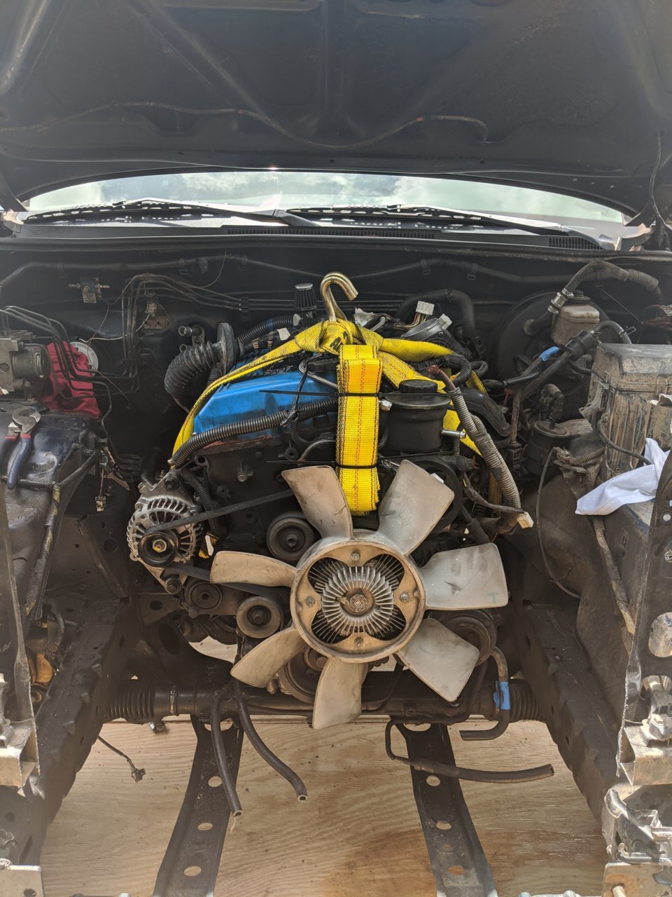

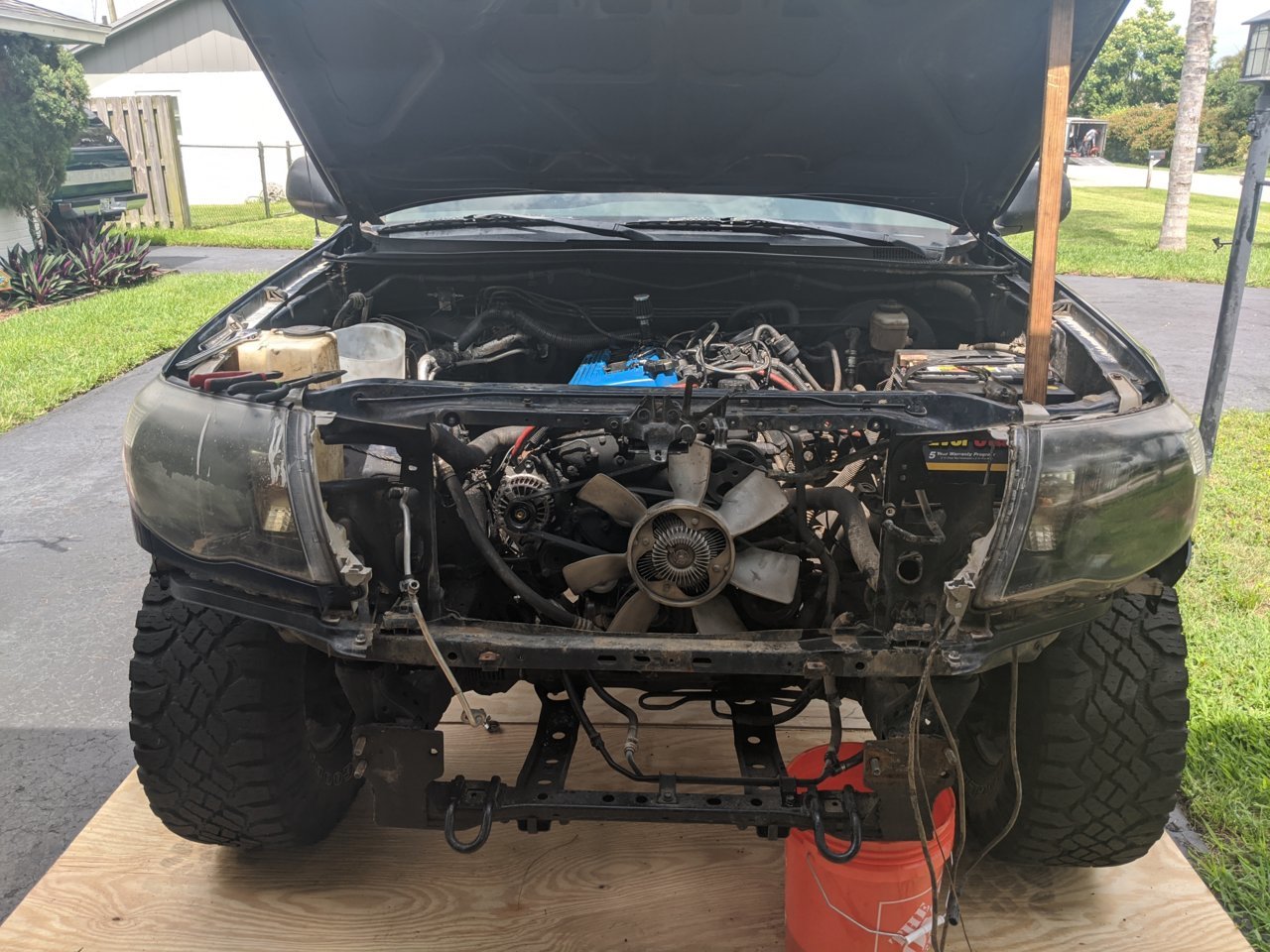

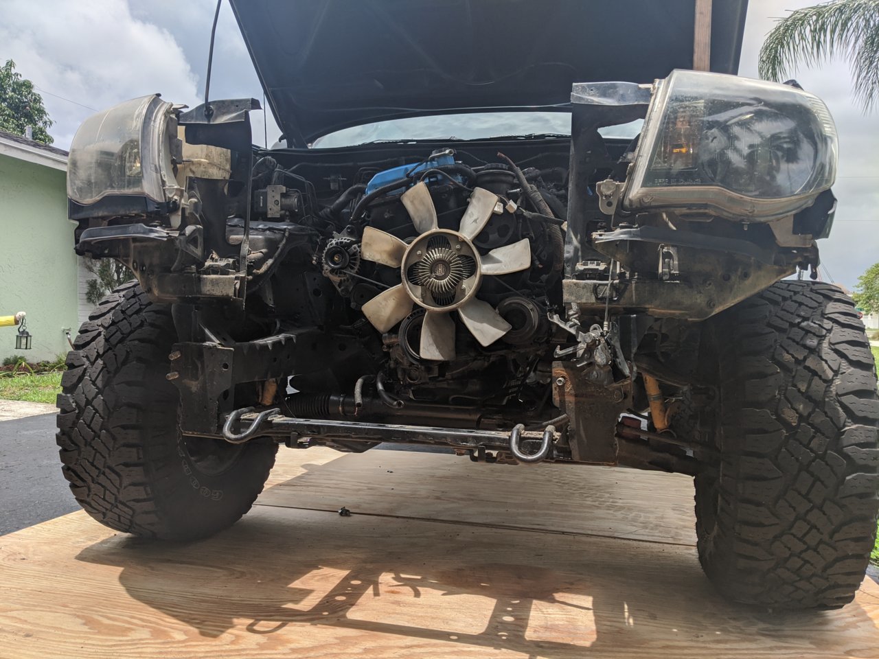

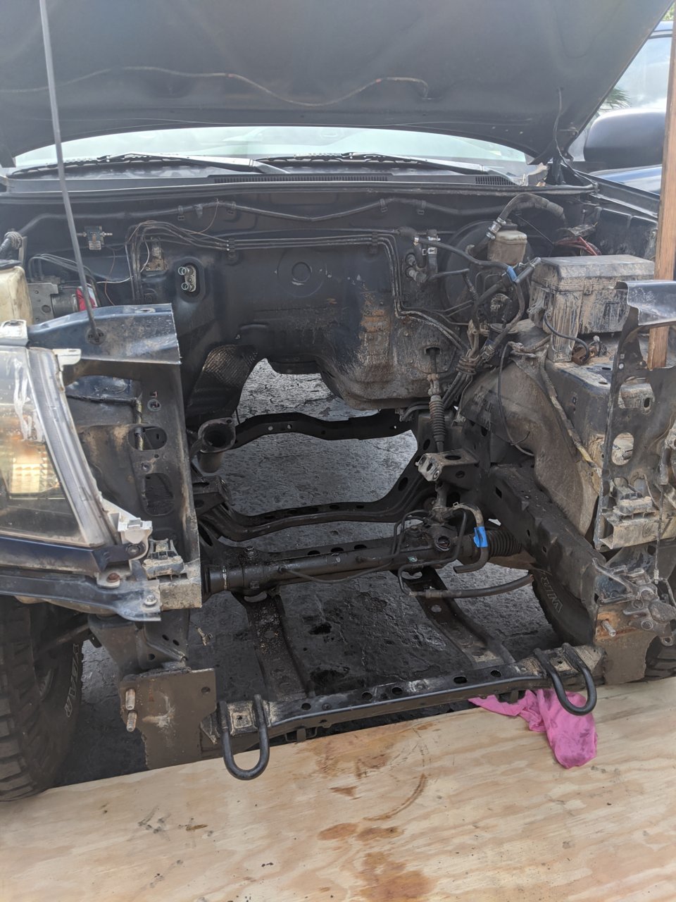

    Yeah when it comes time I probably will pull it off it just rains so much here in South Florida lol I did also cut the front radiator support out so I can come in more level.

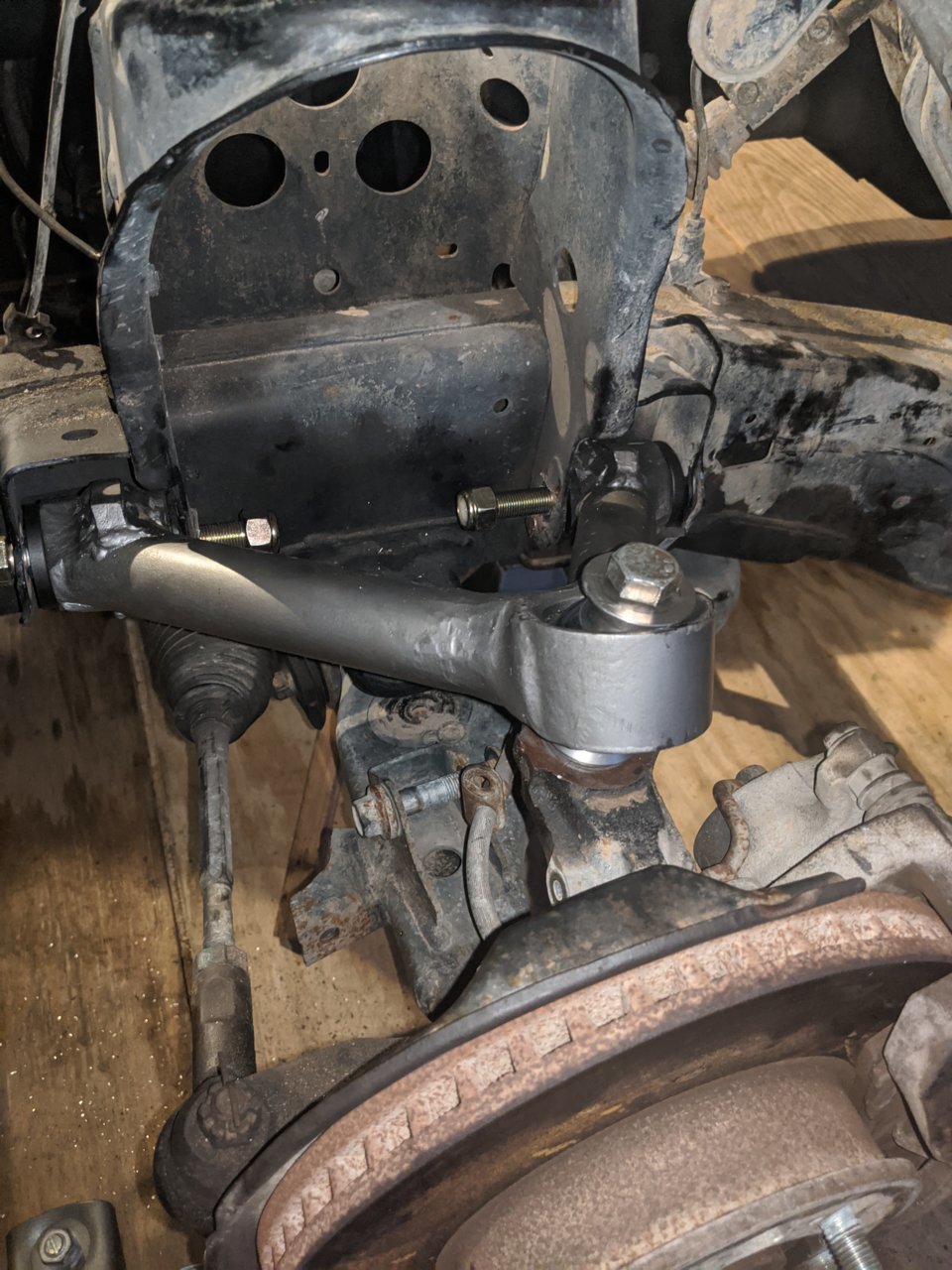

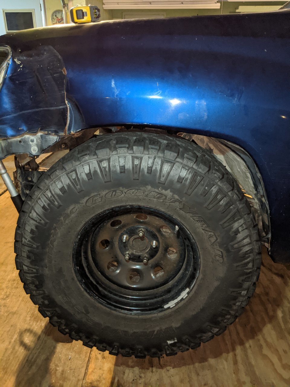

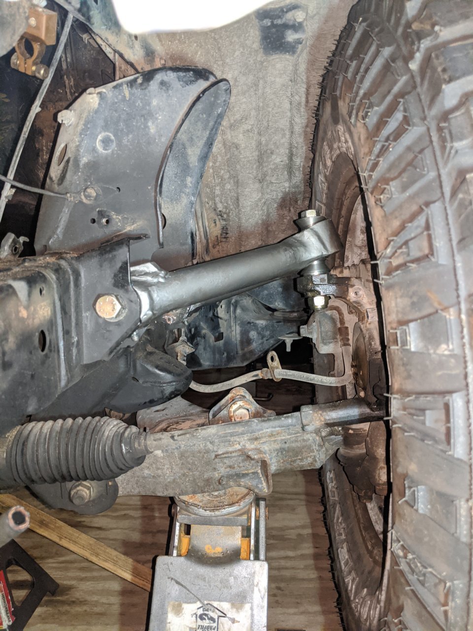

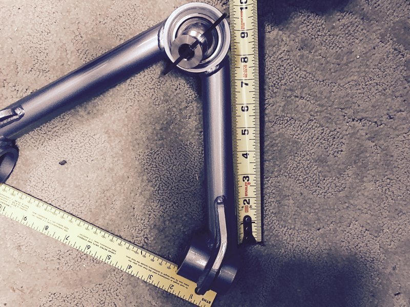

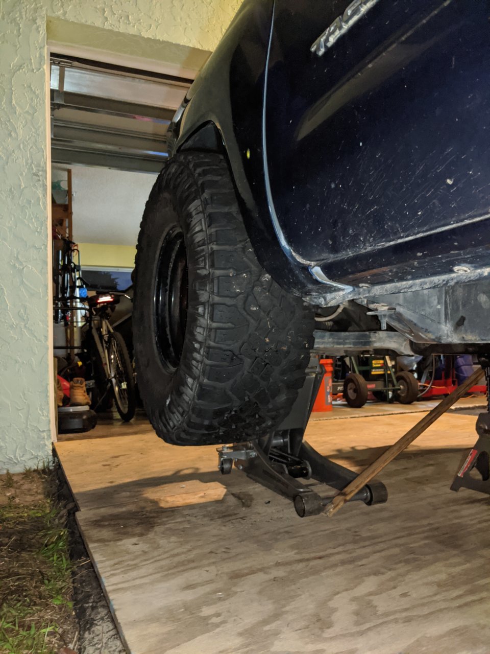

    Well I'm a dummy dumb dumb. I assumed that if I stuck to the jig the arms would work. They do however I made the inside area too small for the proper shocks clearance I want.
    Heres a photo of a traditional arm
    Here is mine
    As you can see the area by the uniball cup is much smaller. It's a slight setback but this is all a learning process. When I make the new set im going to tack and test fit. At least I will have my king shock installed by then so I can confirm that there is proper clearance.

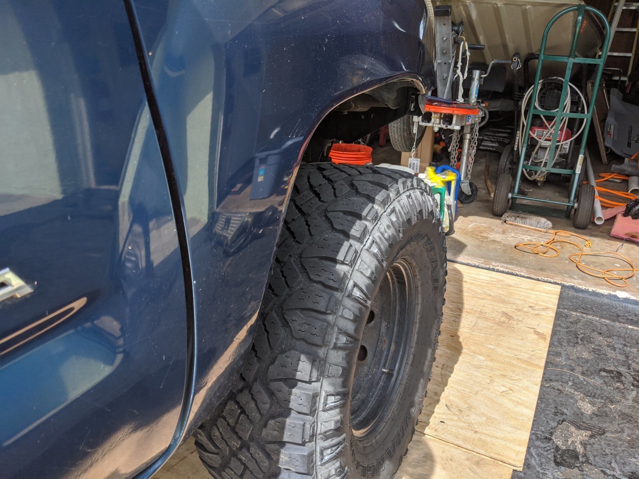

    I did test fit one arm and I do like the extra travel. My fenders are probably going to be modified. Down travel stays the however up travel is where the uniball helps alot. I measured 8.5" of travel at the hub without bumpstops or shocks. It will be less that that but I will try to retain as much as I can permitting my shock and fender clearance. The tire in the picture is a 33x12.5r15 and the other tires are on the ground.
