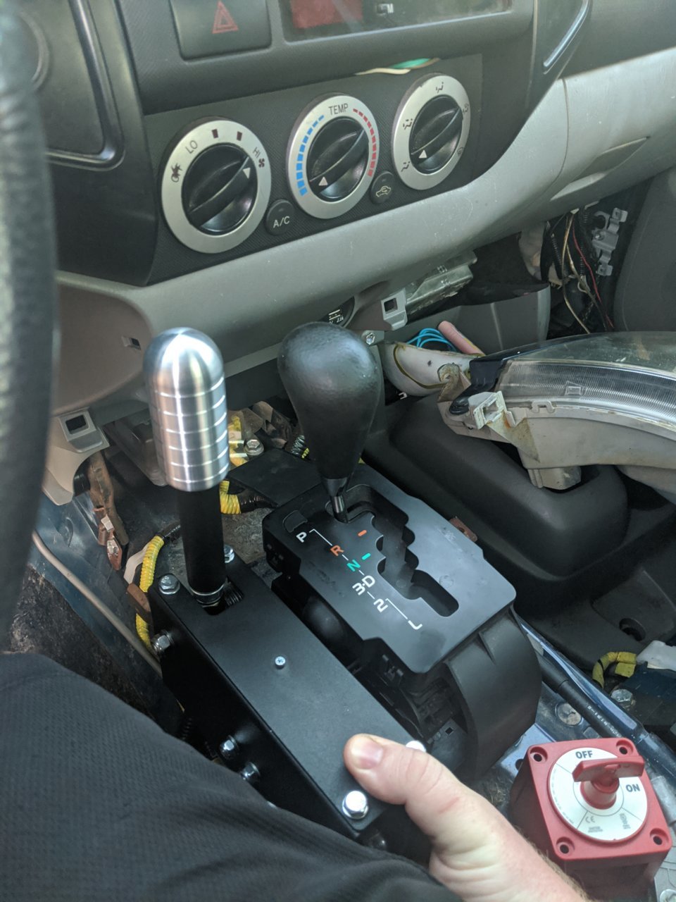

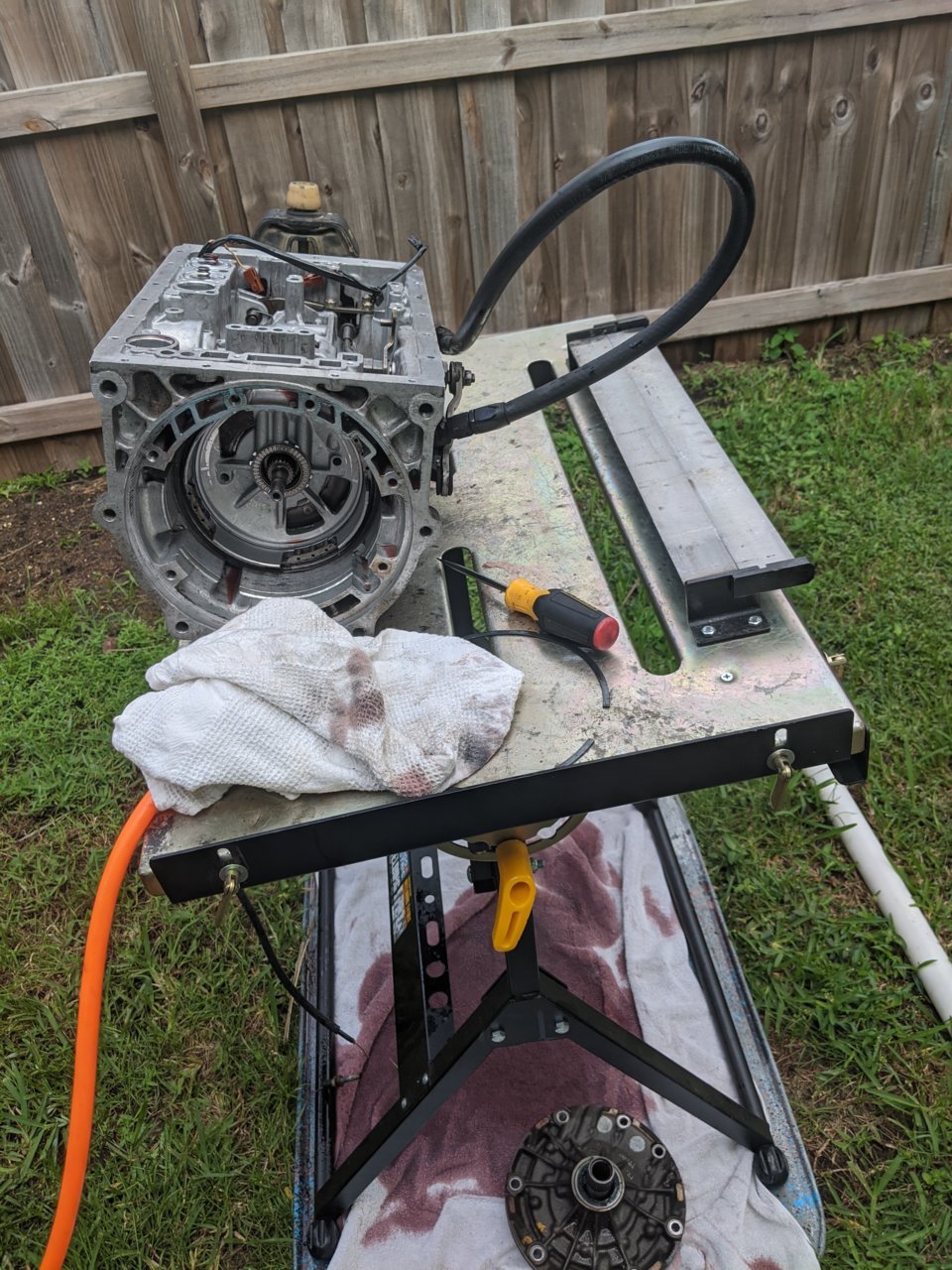

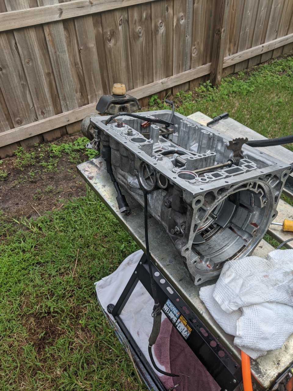

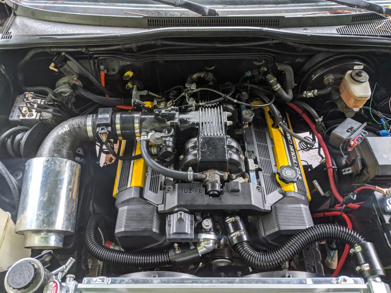

    So I've been slowly working on it. Most of the wiring is done now including some of the gauges. I am having issue with the trans not shifting so I'm slowly going through all the trouble shooting. I did have to tear down the trans to change output shafts so I'm hoping it's not from that. I'm going through the valve body first in hopes that that might be it.

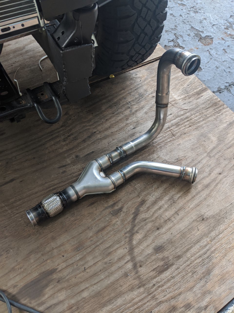

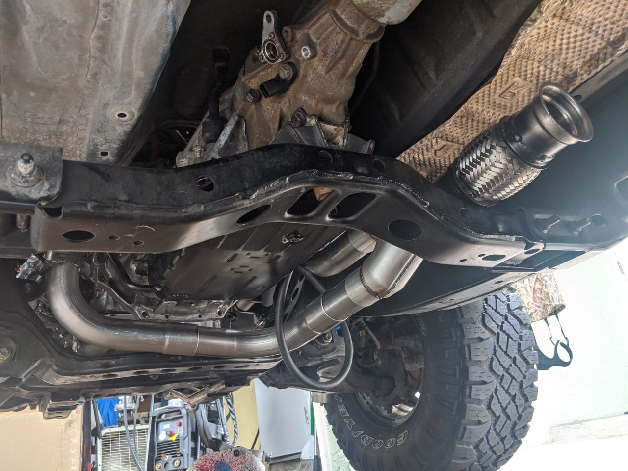

    I did also get my crossover pipe built and attached a cat and resonate just no muffler yet
    Also heres a short clip.

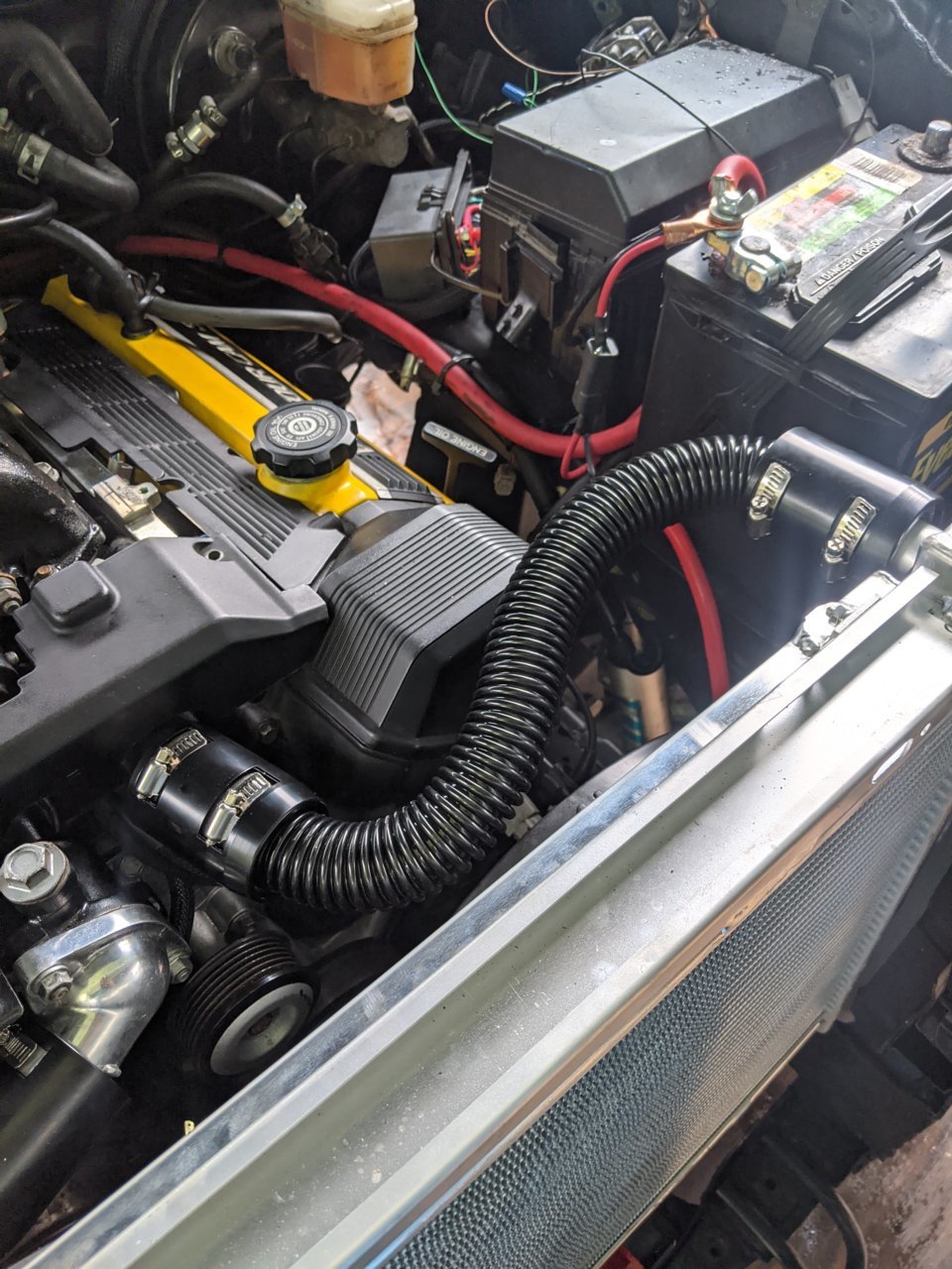

    I'm halfway through mounting the radiator and am still working on the trans but after that the real fun will begin.

    what are you using for a shift controller?

    Soooo the eBay headers turned into a nightmare with the steering shaft. I had to cut and weld the driver side alot.
    I'm using an arduino for my shift controller.

    So I'm currently working on some issues with my transmission and haven't finished the wiring for it yet. I plan on running my a340 manual the whole time for now so no pwm. Eventually I'll complicate it with auto. For giggles I'm going to use a sequencial shifter from a racing simulator for the forward gears.
    Once I get everything ironed out I'll post everything I did with plenty of pictures.

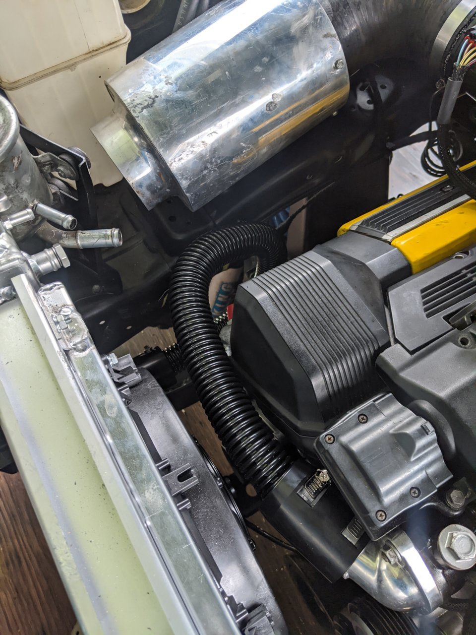

    Still gotta finish the top radiator mount but got the hoses made.

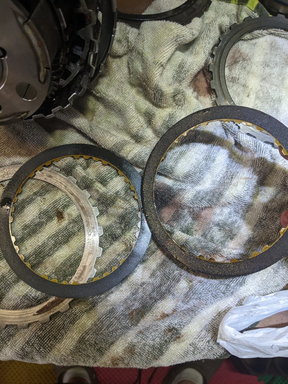

    Finally got back into the transmission.
    Missing a few teeth on the right disc and once I removed the section it was in the transmission moved freely.
    Some testing
    I want to replace the both of the discs from the overdrive direct clutch and I think once I do I'll be back in business.
