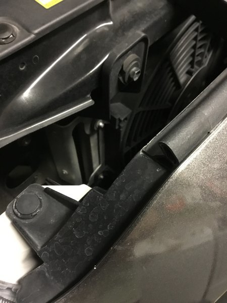

    I'm mainly curious of how you have it wired. No joke this'll probably be one of my next mods lol Also does the fan cover only half of the condenser?

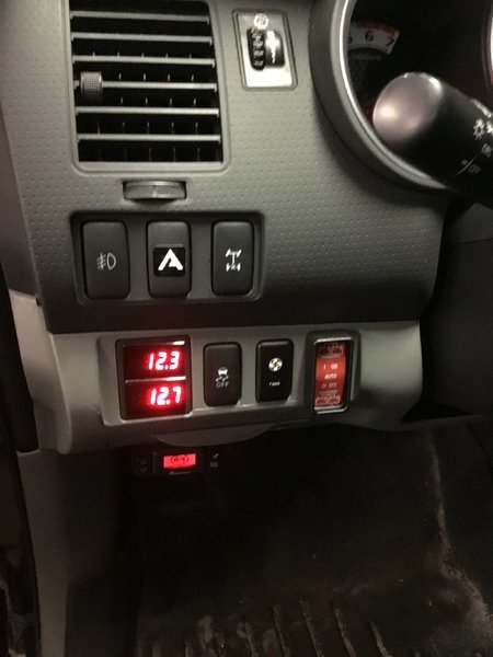

    The switch with the fan on it. Is to turn the fan on . the fan is mounted on the left side . I used a 12" fan. The switch was 30 buck from eBay . It's wired with a relay . + from fan to + on relay, + from relay to + on battery, ground the fan , ground the relay, relay trigger wire to switch, ground switch, power switch from ignition like a radio. (12volt . Com ) has relay diagrams . I don't remember the relay numbers or I would say I did this a year and a half ago. A pre wired fog light kit would be the same wiring. Just a fan instead of light. I didn't set it up to turn on at a higher temp. It just to get moving air a idle. It helps with the coolant temp at idle though. If you want a temp controller I know of good little one with a digital screen that will fit in the switch spot but you will have to use the power mirror hole. And there 80 bucks 30 for the sensor and are hard to hookup .but are sweet.
    Search at eBay push switch 873g maybe add Tacoma. But there only 3amp you have to have a relay to power fan.

    That is the bracket had to make . For left side of fan. Right side and top were able to mount on truck.

    ^^^^ so what do those other switches do 0_o

    Top left switch fog lights, top middle arb compressor . Right top arb locker switch it's actually a hilux rear diff lock switch but I like it better then the taco switch. Cause of the pic. The bottom red are volt meters ignition controlled ,bottom center is peel out stopper, bottom right is auto charging switch for battery's . It's an auto setup but that's the switch to manual control it. Very bottom red is a break controller trailer brakes.

    Arb locker :drool:
    You've got a pretty chill setup :thumbsup:

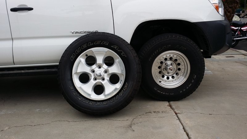

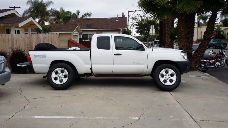

    Got these 2015 jeep rims and like new tires for $100. Should i put them on :)
    255/70/18
    * EDIT never mind! they're 5x5 bolt pattern!*
