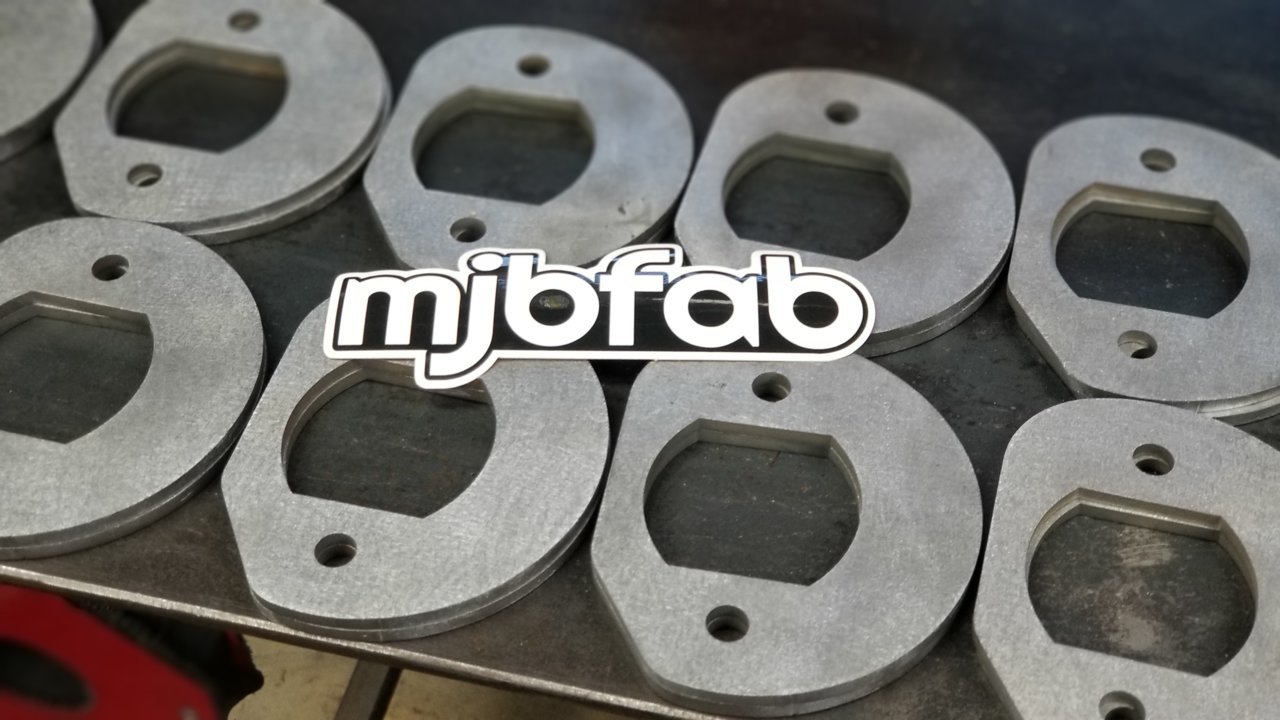

    Is there a qa1 shock for lifted 5 lug trucks

    I dont know off hand but I'm sure they have a longer spring and shock combo that could potentially lift it a bit. I'm sure they'd be able to help out.

    Just curious how much drop can you get from the QA1 coil over conversion?

    Depends on the spring length you get. But usually around 3-4 inches. Even more if you pair it with a ball joint flip.

    Sounds good, I am may have to look into this when I am redoing my suspension! What range of length and spring rates are suggested for our regular cab 1st gens?

    There are 8" and 10" springs with rates in the 10" ranging from somewhere around 350lbs and up and the lowest I've found recently in the 8" is 600lbs. But theres really a bunch of spring options from other companies. I've seen people use swift springs. You can really choose whatever you want.

    Anyone have a winning combination of parts for using these with a lift vs a drop?

    I've had a couple customers say they're going to lift their trucks with them. I havent gotten back any concrete feedback but I know one guy is pretty close. I'll follow up with him and see what he has going on.

    Cool, let me know what you find. I am down to order some plates to try... I have a pair of old LCAs I can sand blast and practice welding on. I am not looking for anything crazy... just like 2-3 inches of lift in the front.
    I am currently running the v6 springs + Doetsch UCAs in my 97 and they give about 1" of lift but they do not work with spring spacers as the springs start to bulge and cause interference with the UCAs at full droop. Even without spacers there is a very slight bulging out on the springs. I am thinking coil-overs could be a perfect solution.
