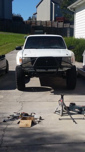

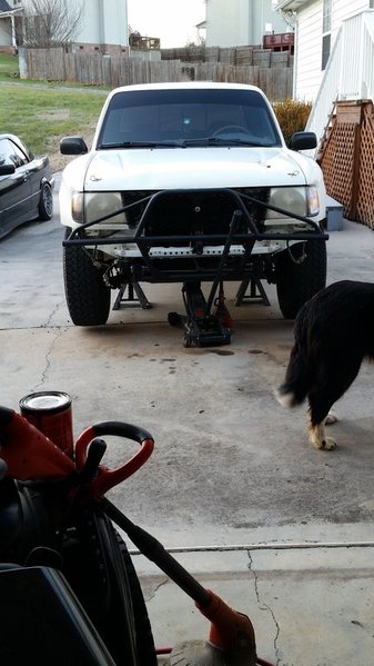

    My downey set up broke so im trying this set up

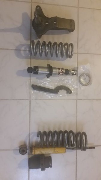

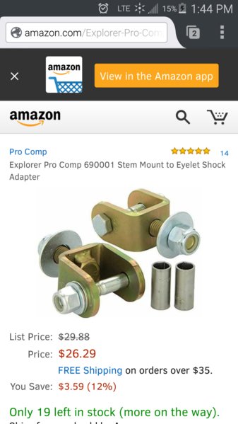

    Ordered from summit racing they are qa1 promo star single adjustable. i just put a loop adapter up top to make em work

    Alot smother than the downey i had. I still have to get an alignment alot of neg camber

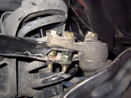

    For got to tell you, on your uppers you can mount your ball joints on the bottom of the arms like they are on my fabtech arms it will give you a little more clearance. Like this but on the bottom

    That is a great idea im going to do this. Looks like it would make the upper ball joint not so angled

    Actually this

    Bolted up just fine. I had to grind out some of the inner spring holder so the bolts would not get in the way
