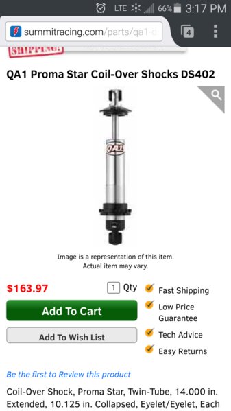

    Also I was wondering if you remembered the collapsed and extended lengths of the coilovers, and also the spring dimensions. I am very interested in doing this upgrade because I have the doetcsh 6" lift and I am looking to upgrade so I'm just trying to find out as much info as I can
  2. Oct 25, 2015 at 12:18 PM
    #22
    chrismxpx
    chrismxpx [OP] Well-Known Member
    Mar 25, 2015
    #151762
    47
    98 rwd tacoma
    These with a 9 inch 650lb spring. They say a 10 inch will fit but i ordered and they dont

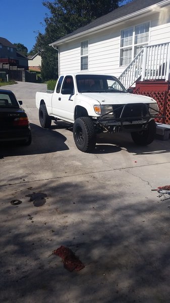

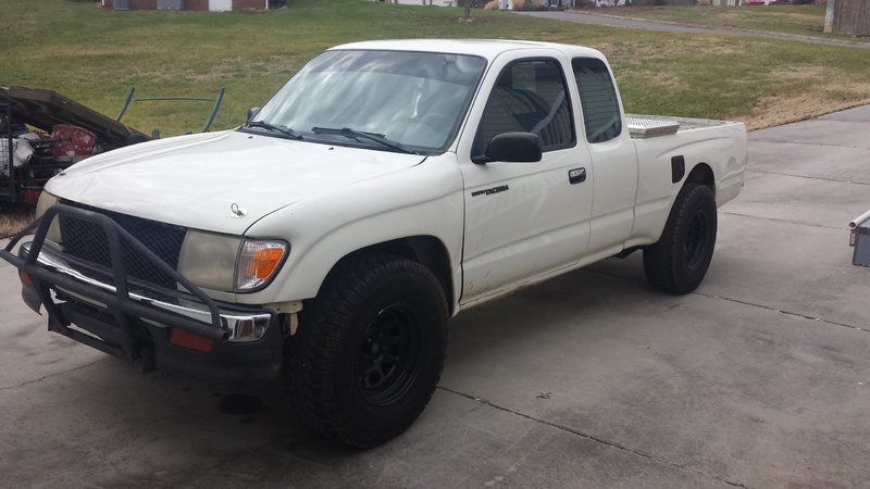

    Alot more lift. Maybe 1 intch less travel because of the adapter. I wont off road 2 much except for a trail i just needed to get this thing driving again. Here is a pic of before and after

    The first is from feb 2015 with the downey set up. The next is after my set up and after driving it around the block

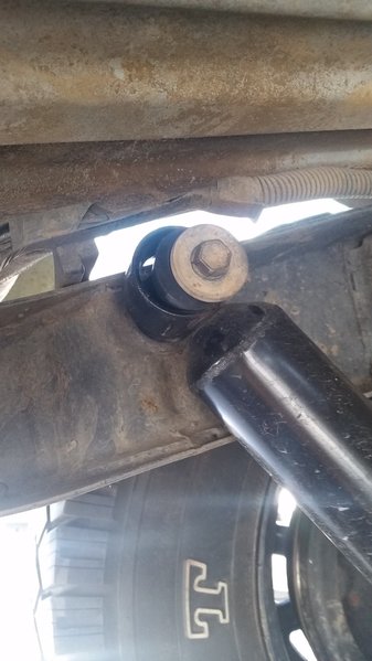

    Well now i have a severe lean in the rear driver side and everything is connected. I was driving and hit a pot hole noticed a clinking sound. All bolts are tight and in place but the rear is saggin like 3 inches. Ps new rear struts are on and connected

    Well this might be a problem and the right leaf is missing the middle half. A shop installed these and now they are fixing it

    Sounds like the middle leaf snapped at the center pin and half of it fell out.
    That would definitely be your issue there! That's pretty much 1/3rd of the strength gone from that side of your bed.

    Yeah but its odd that it sits higher then the other side but i guess with that bushing on the shock falling out on the left would cause the lean. The shop said the leaf that broke is pushing it higher on the right also but that makes no sense
  20. Oct 29, 2015 at 7:43 PM
    #40
    kaotic taco
    kaotic taco Member
    Feb 17, 2015
    #148944
    17
    Tyler
    SoCal
    96 5 lug
    Yeaa the shock bushing would cause it to lean and act weird.. but the snapped leaf shouldn't push that side up I wouldn't think either
