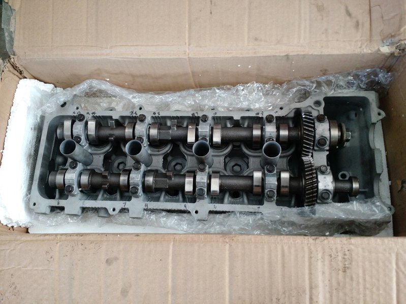

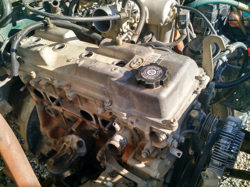

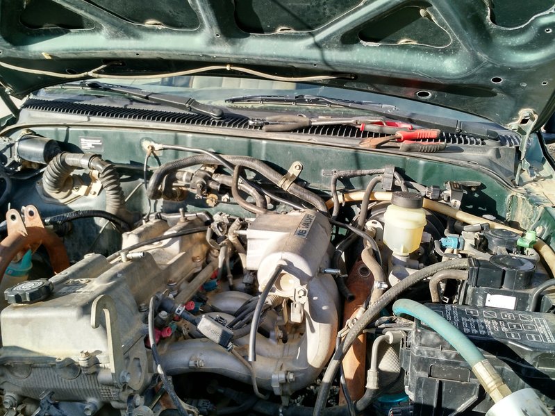

    New head. Started tearing the motor apart. Also came across the toyota manual online to help out with the tear down.

    Gear Head
    Gear Head Well-Known Member
    Oct 27, 2012
    #89921
    4,630
    Jacob
    Winston Salem, NC
    96 Tacoma
    fj60 front, fj80 rear, full hydro, 5.29's, welded, twin sticked 2.28/4.70 duals, 39.5's, inboarded 63's
    What did you do to plug the bung in the oil pan when you took the turbo off?
  12. Dec 21, 2015 at 6:37 AM
    #212
    MadTaco461
    MadTaco461 [OP] BRO runner
    Dec 30, 2009
    #28470
    13,425
    CA
    99 turbo 5 lug long travel
    Kinda stock
    Gear Head[QUOTED] likes this.

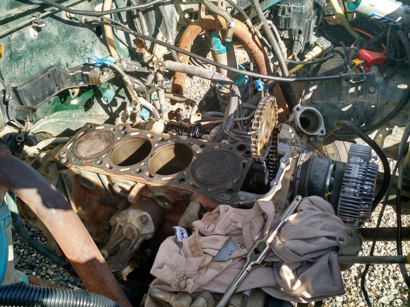

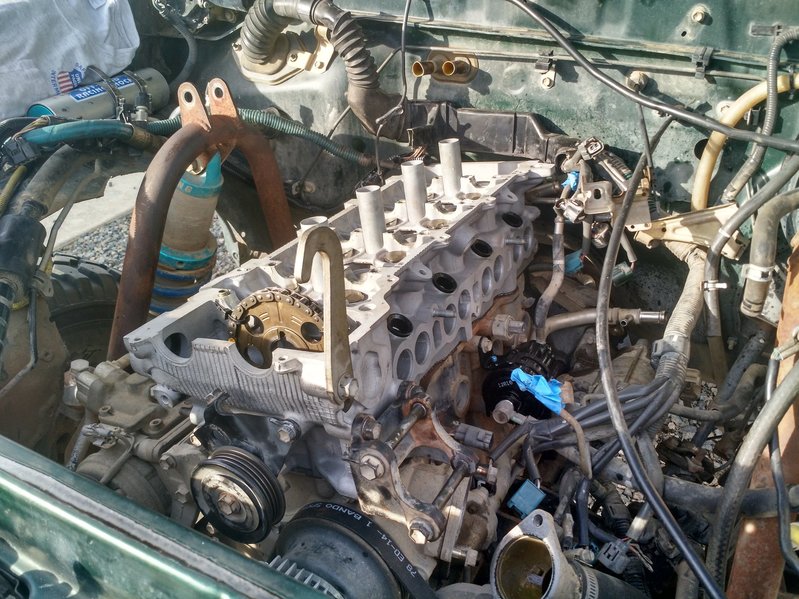

    Got a good dent this Christmas weekend even with spending time with friends and family. The intake manifold is nice and gunky. It felt like sludge. Smelt bad too. Looks like the EGR is what causes that mess. All clean now. I pulled the old head and transferred everything over to the new head. Every bolt is getting anti seize just in case I pull things apart again. Also changed out the fuel filter. That should be good for another 160k miles. I used a stock head gasket again, but upgraded to ARP studs. I don't think I'll ever do a MLS gasket. My head is pretty rough from the factory. Head is torqued down now. Need to grab some new heater hoses. They all did not want to come off. It is a good time to replace them. Looks like the last owner gave me a new timing chain and guide. Glad I was lazy there. I only need a full day to wrap everything up. Hopefully Thursday that can happen. A few things I need to grab is injector seals, exhaust studs and nuts. 4th head gasket this year replacing, but this head gasket looked fine actually. I'm hoping next year I don't need to touch head gaskets.

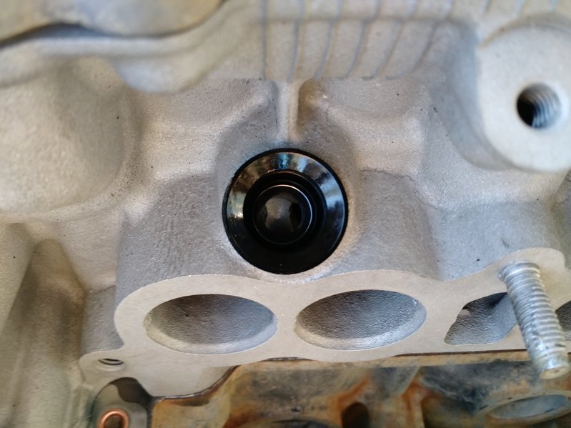

  14. Dec 28, 2015 at 4:20 AM
    #214
    Torspd
    Torspd Tor-nication
    Sep 18, 2009
    #22958
    26,445
    Tor
    The Great America!
    MMVI 4.4L 4x4 Access Cab
    Torspd Custom Turbo kit [] Borg Warner 9180EFR Turbo [] Haltech Elite 2500 [] TiAL Q BOV [] TiAL V44 Wastegate @ 15psi [] CP Pistons [] CP Carrillo Rods [] ARP Head studs [] ARP Main Studs [] ARP Header - Head Studs [] Ported Heads w/ 1mm oversized valves intake/exhaust [] Brian Crower Forged Stroker Crank [] Darton M.I.D. Sleeved Block [] Kelford Camshafts [] Torspd 160* T-stat mod [] APR Large Fuel Rail [] Walbro 460 LPH E85 Fuel Pump [] FueLab FPR [] APR T56 Conversion Kit [] KP RACING Built T56 [] McLeod Racing Custom Twin Disk Clutch [] One Piece Aluminum Driveshaft [] MGW Shifter [] Custom lowering kit [] Ohlins Front Coilovers [] QA1rear shocks [] Custom Ron Davis Radiator [] Dual SPAL Electric Fans []
    From what I can see, everything looks really good. :thumbsup: I admire the engineering fore-thought that went into the head casting. To allow the cam bolts to be removed. Weren't so fortunate on the 1GR. :pout: As well as the void left in the head to pull it off around the timing chain. As in a two piece timing cover. :jellydance:
    What was the tap needed for?
  15. Dec 28, 2015 at 8:26 AM
    #215
    MadTaco461
    Dec 30, 2009
    #28470
    13,425
    CA
    Kinda stock
    Yeah pulling the actual head wasn't hard. Everything just pops right off and stays in place. Lifting the head back into the truck sucks. Those deadlifts at the gym paid off. The head stud are under my cams. The old head didn't look bad. It is still good for a rebuild. I need to look closer at your cyl head again. I ran a bottoming tap through the cylinder to clean up after the old head bolts before putting in my arp's. The cylinder bores still have clean hone marks in the sleeves. My 8 port intake is weird I'll take a close up of it. The injector just sprays into a wall and splashes into the intake ports. No kidding why they recommend an oval spraying denso injector.
  16. Dec 28, 2015 at 8:51 AM
    #216
    Torspd
    Torspd Tor-nication
    Sep 18, 2009
    #22958
    26,445
    Tor
    The Great America!
    Yeah. Post up that picture. Curious.
  17. Dec 28, 2015 at 3:52 PM
    #217
    MadTaco461
    Dec 30, 2009
    #28470
    13,425
    CA
    Kinda stock

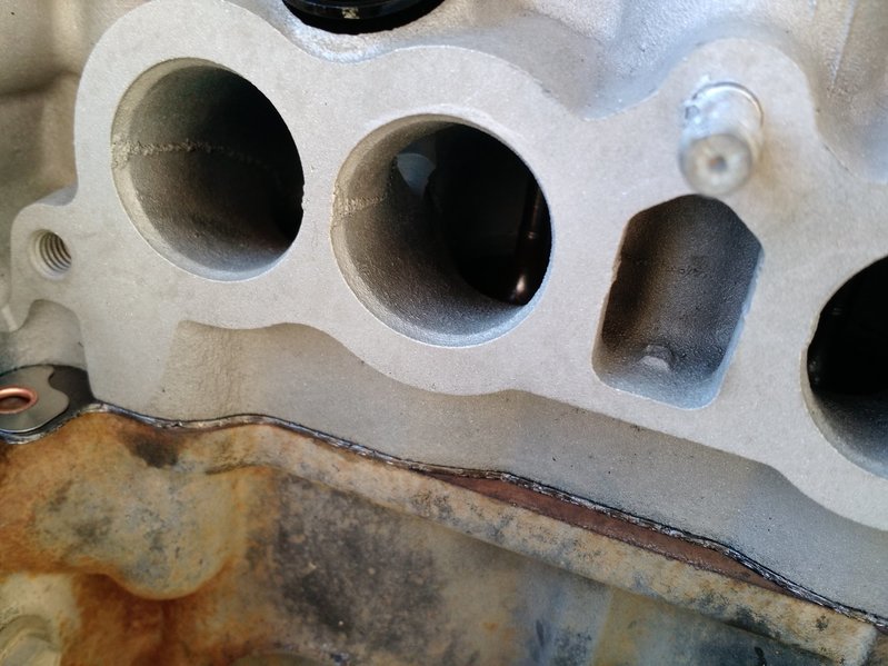

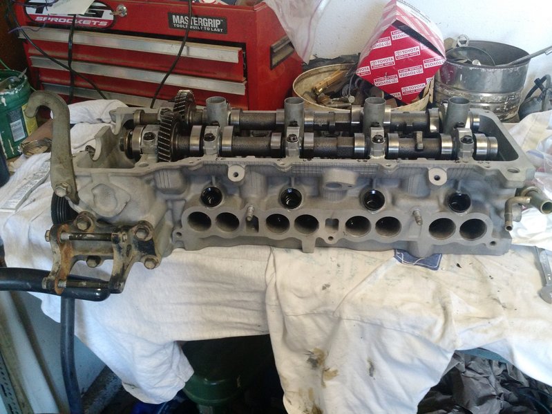

    I'll take some better pics of the old head. The pics I have now aren't that good. They are mostly for me to look back on to remember where everything goes.

  18. Dec 31, 2015 at 5:45 PM
    #218
    MadTaco461
    Dec 30, 2009
    #28470
    13,425
    CA
    Kinda stock
    @Torspd check this out. On the 8 port head they drill a hole into the vane. It sprays mostly out to the side. I have the old head in a box right now but you can see it actually does cover all the walls of the intake before hitting the valves. All the black sludge is a good spray pattern marker.
  19. Jan 1, 2016 at 3:20 PM
    #219
    Torspd
    Torspd Tor-nication
    Sep 18, 2009
    #22958
    26,445
    Tor
    The Great America!
    That is quite interesting looking.
  20. Jan 1, 2016 at 3:21 PM
    #220
    Speedytech7
    Feb 20, 2014
    #123587
    58,092
    FCQM+VG Cheney, Washington
    It's less Tacoma and more mod
    I think my new head casting is like that too, but maybe not. I'm gonna go look at my old head to see what the ports look like.
