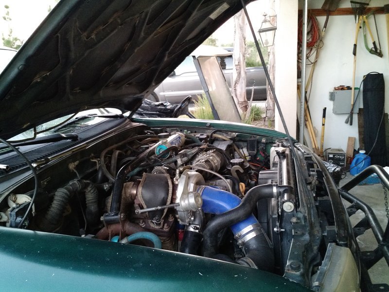

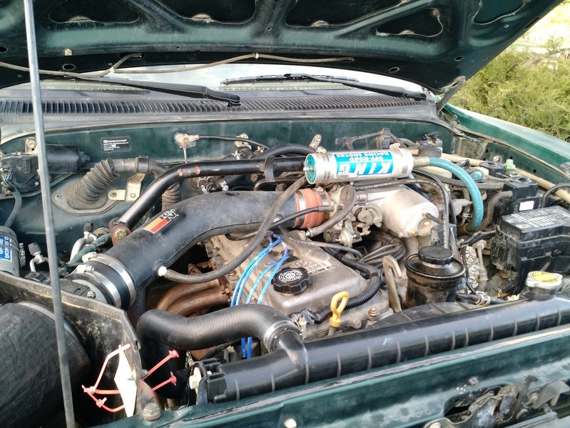

    On another note truck should hopefully be running tomorrow. Almost got going today, but heater hoses and all the emission crap slowed me down. I'm going to fill my coolant up with distilled water first drain and do a refill of coolant after.

    Back together and running today! Had a few bugs. At first fire up I had a heater hose start leaking on me. Then had a misfire on cyl 3. I bent the spark plug electrode all the way in. Must of dropped it. Changed out the plug. Threw a MAF sensor code. Left that unpluged when I took out the spark plug. Now it purrs. Drove it around the neighborhood for 20 minutes. All but one sensor checked in. Should be ready for smog tomorrow once I weld in my new cat.

    So scared right now. At the smog station right now

    Oh yeah passed! Barely though

    Max allowable NO is 552ppm. I blew 552. Whatever I'm good for 2 years. Kinda curious if my o2 sensor is dying out. Truck feel kinda sluggish with the throttle. Maybe mine is dying out more lean. If my truck was 1 year newer it doesn't need the emission testing up the tail pipe. Oh well. Let the mods carry on once I break in the top end
