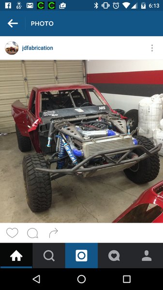

    A crap ton of meth or doing e85 you can get away with a lot of power on a stock block. Just need to not knock so those head bolts don't stretch. Of course it's a risk, but every turbo build is a risk.
    This is my build goal:
    Turbo 2rz, fully caged, lots of suspension and pretty light.
