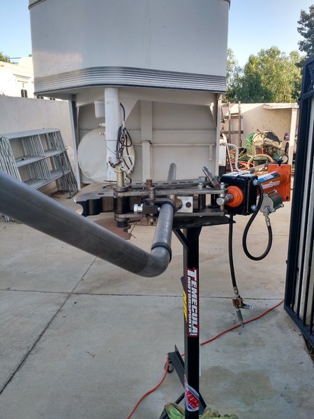

    Lol. Looks great man. Sooooo much work I'm sure. Looks easier than it is. Using the HF bender too?

    Lol, no that is the jd2 bender with the swag hf ram jack attachment. The notcher is the really only hf truck fab tool I use. Bushing starting to get worn. Wobbles like a hot dog down a hallway.IMG_20160528_180659129_HDR.jpg
