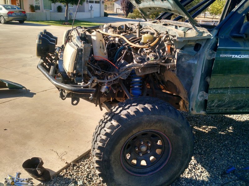

    Goodbye core support. Hello engine tie in cage. This part isn't fun.IMG_20160917_124547271.jpg

    Sawzall cuts through the sheet like butter.

    Wow that's surprising, although considering people Bob their bed with ease with a sawzall makes sense

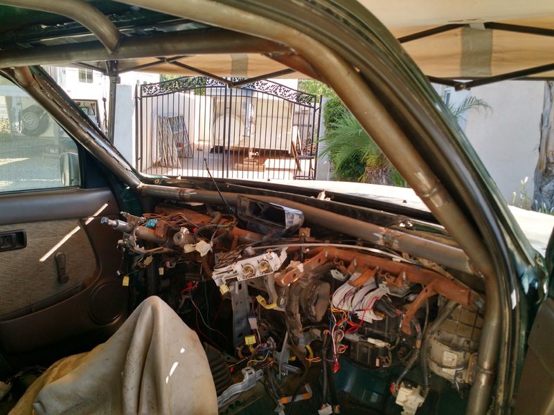

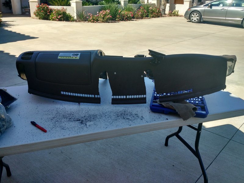

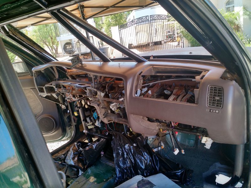

    V bars! Rear tubes! Dash board!
    This what I did over the last 3 weeks. I got the dash tube in. I dodged all ac vents. You probably won't find a first gen with a cage that has all working vents cuz it sucks to make. Doing the tubes through the firewall and that sucks just add must as the dash. All be happy once I get done with the dash area.

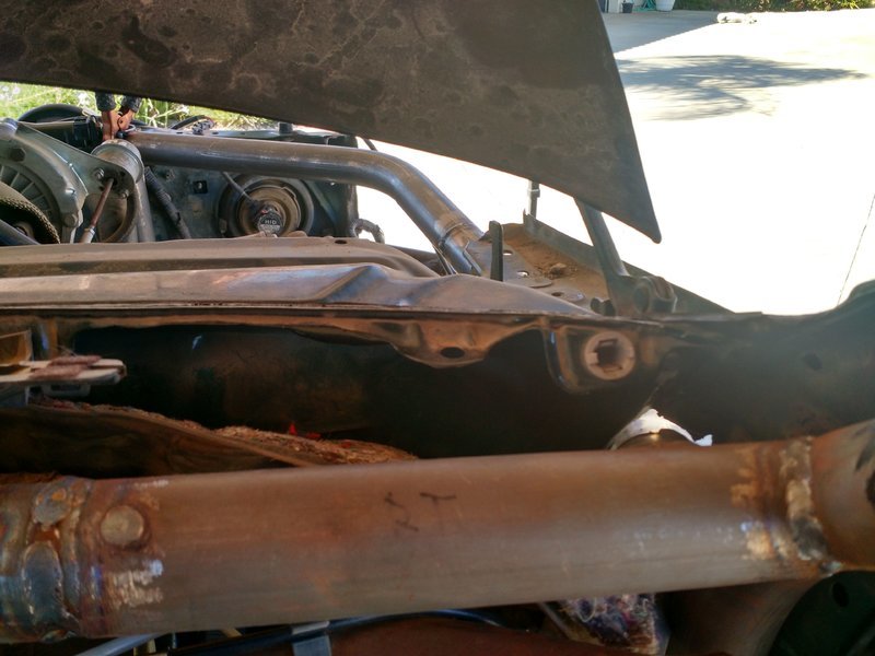

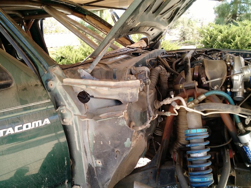

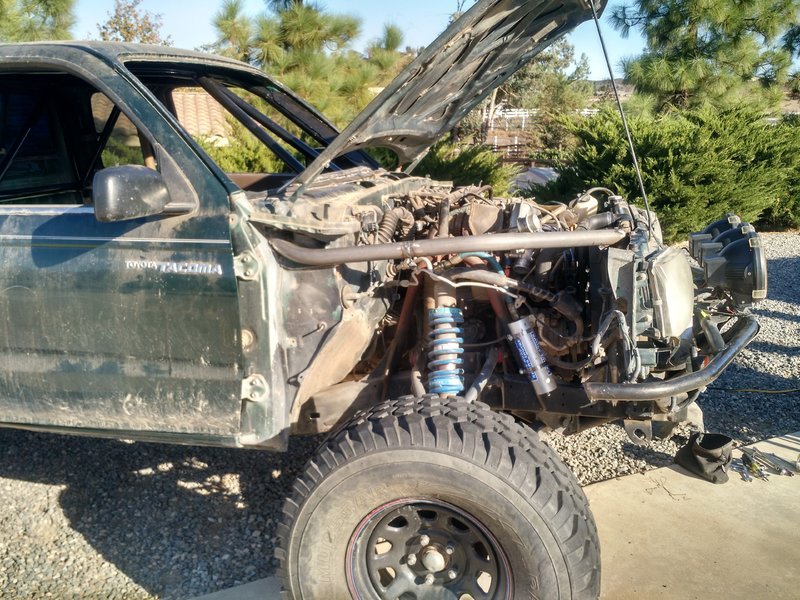

    So I got a tube to go from the dash and tie into the front of the frame next to the radiator.
    The driver side is going to be exciting!

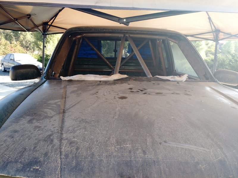

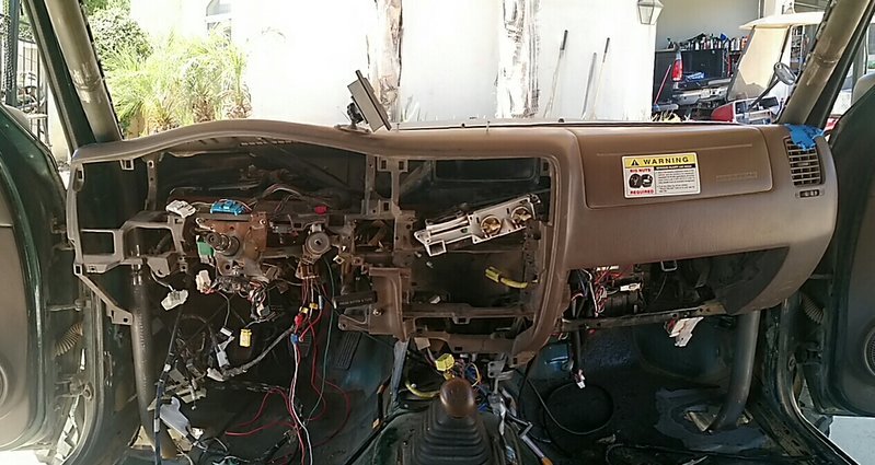

    Phase 2 of trying to fit my dash in. Too much stuff in there. I must of pulled the dash 20 times yesterday.
    Next weekend I hope to make a good jump back into this truck. I should have good pics next week. Right now it doesn't look like I've done muchIMG_20161009_113055823_HDR.jpg

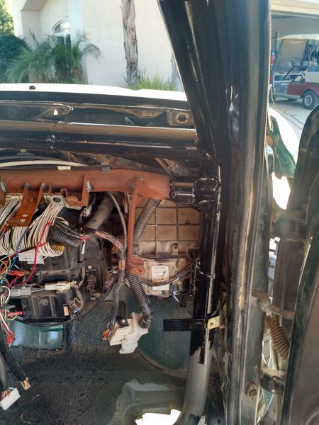

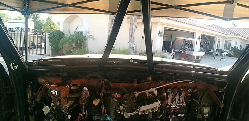

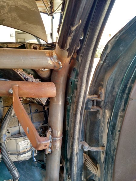

    You can see how I had to attach the engine tie in section to the a pillar. This section isn't 'race truck" I dodged a few areas to keep AC vents. I have to mount it to the dash tube instead of the a pillar. It going to do the job of holding my core support. Not pretty.
    Here is how much I hacked away of the dash.
    I slide a small piece of tube over the end of the old dash tube with a quick tack to the A pillar. Also a lower tab to mount the bottom of the dash.
    I did a quick and dirty way to hold the steering column in place. Just a small section of 3/16" I had. More solid than it was stock. Also lower dash mount painted black. I pushed the fuse block back by the clutch petal. Hope I don't pop a fuse there. Going to take a while to change it out. Well here is all the stuff you get to see before I cover it up.
