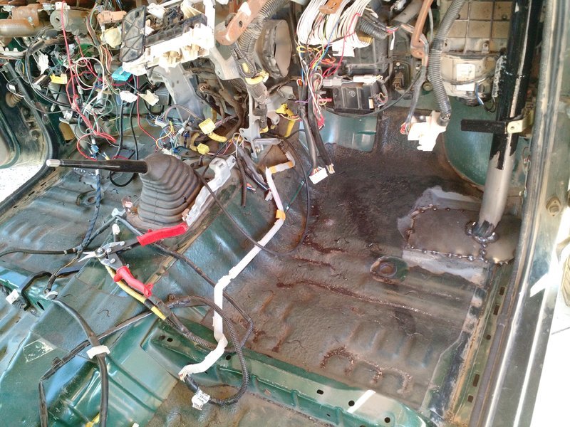

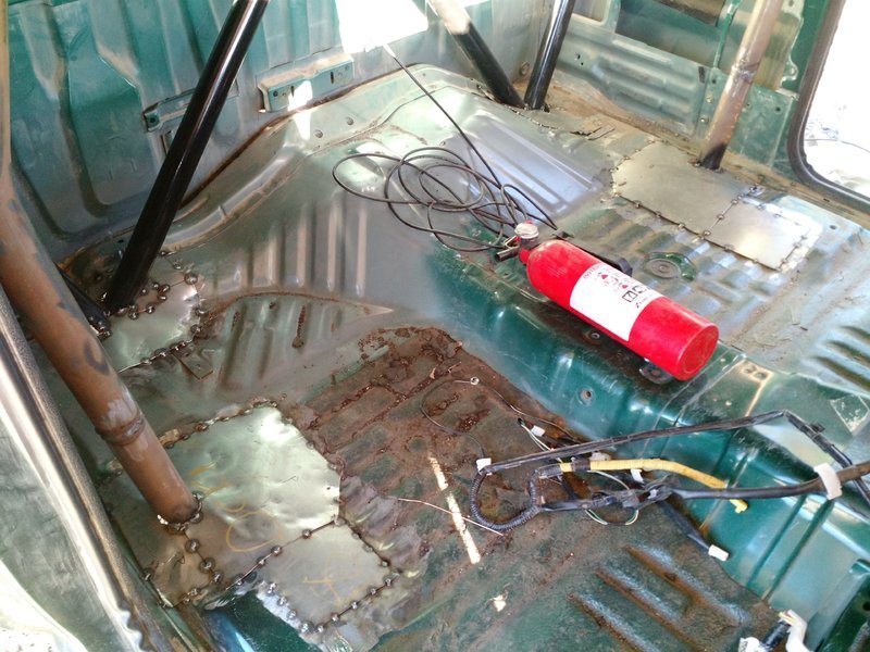

    Lol the only one I ever pop out of that fuse box is usually the 12v aux power. Might pull up a separate harness later down the road into the cab.
    Also plated up my floor. Going to use silicone for the gaps. Might try to look for something like bedliner or some rubber stuff for the underside.IMG_20161015_165205501.jpg IMG_20161015_165214579.jpg

    Geezus dude! I feel like you are building race truck, with the amount of work going on here. How long has it been since you have driven it?
    Did you plate the underside as well?
    Flex-seal. :D ;)

    It's almost a race truck. She'll clean up very soon to start hiding all my work. I'll stop into Napa and check out that flex seal. Underside is pretty much single layer sheet metal besides the front. I figure just to spray the crap out of the underside to rust proof anything raw. Truck doesn't see water very often in socal. Almost 6 months of working on it when I make the time. Hoping to be driving a week after Halloween.

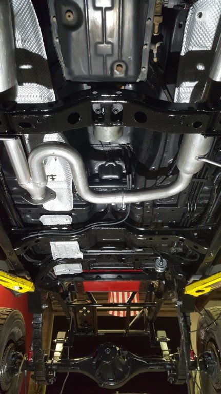

    Could do the whole inside in bed liner. Chassis saver first to stop all the rust. Could do chassis saver on the underside too. That's what I did.

    That looks good. I'll do something like that before I start flinging dirt up.

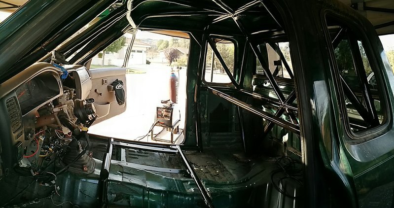

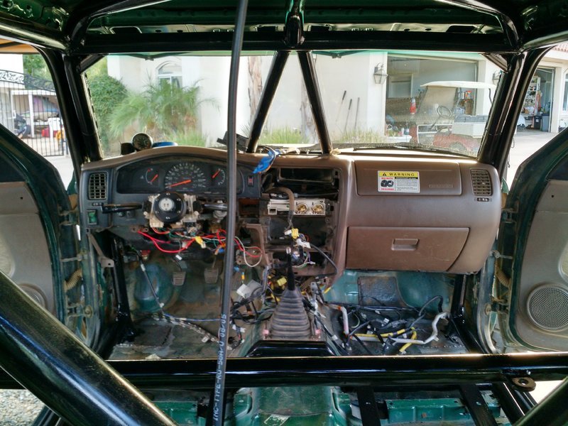

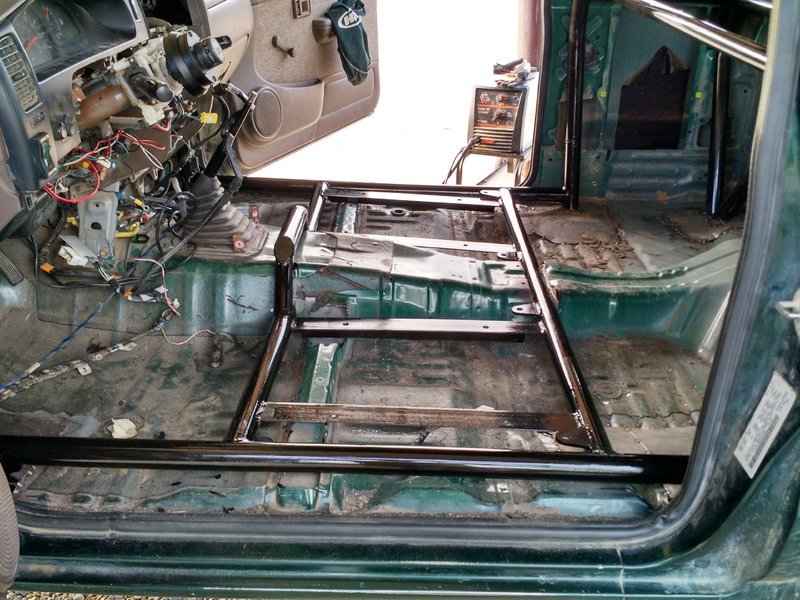

    Finally done welding this cage up. Got the seat mounts in. Lowered them a little over an inch over what it was. Feels nice sitting a bit lower in my truck. Letting the paint cure. I'll be adding a few details later on, but I want to try the truck out first.
    Still need to mount all the stuff under my hood I cut out. Pics of that mess tomorrow.
    IMG_20161029_165259743_HDR.jpg IMG_20161029_165234960_HDR.jpg IMG_20161029_165044345.jpg
