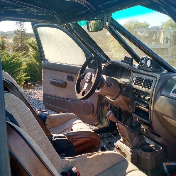

    Nice I'll let you know how mine works. I have a momo 350mm wheel and nrg quick release. It's all bolt on to the factory steering shaft. Still need to wire up the horn. I'll get a pic of the interior in a bit.

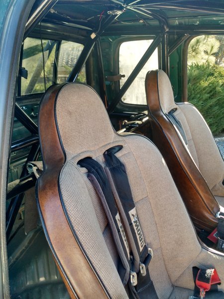

    Fresh interior shots. Need to clean my windows.IMG_20161111_084937.jpg IMG_20161111_074712398_HDR.jpg

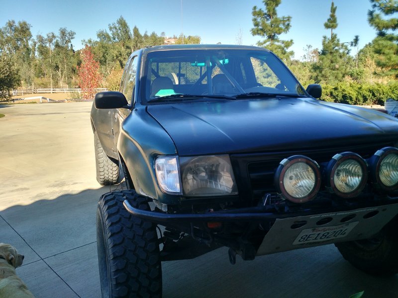

    Favorite pics from today. Truck did great. Handles great. Love how much better the truck likes the cage. Just one electrical bug with the starter cable crimp. Easy fix. Wish I ran the go pro. Hit a crazy section on accident. Felt some good hang time over a 3ft bump at 50mph.

    Hey my buddy just bought an nrg srk-125h hub adapter to run a racing wheel. You run whatever nrg quick release you like. Mine adapts to a momo 350mm flat wheel (not deep dish) don't want the steering wheel in your chest.

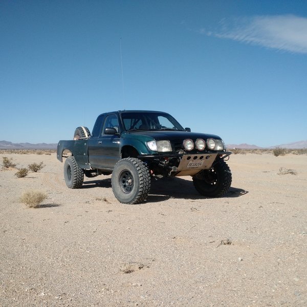

    https://youtu.be/y1cOQkAx6rQ
    #fiberglassdontcare
    Took truck up to a last minute trip to Johnson valley ohv. she did great. Maybe revalve the rear a bit stiffer for the big stuff. Trust me it felt wild in the truck compared to the video.

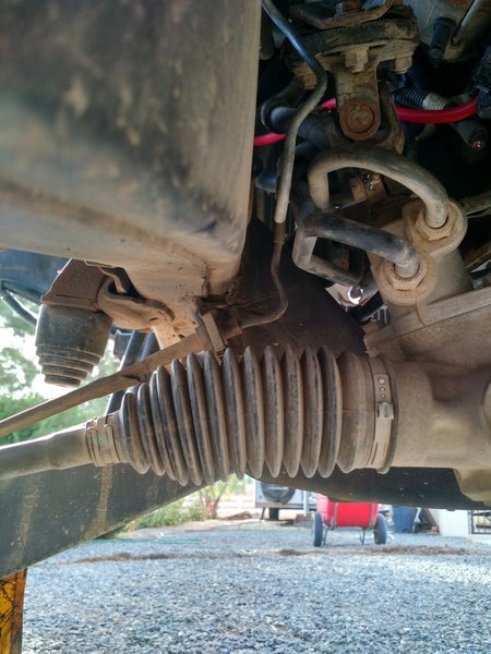

    Did some prep after my trip over thanksgiving. Found a pretty big crack in my lower cross over frame. Gnarstow (Barstow) is no joke to truck abuse. Going to push my brake line out of the way to weld, grind, and plate over on both sides. Toyota doesn't finish up the welds in this section of frame so slamming out your suspension is a bit abusive on your frame.

    Your hydraulic lines for the steering rack are facing outward? Holy shit I'm jealous haha
    MadTaco461[OP] likes this.

    If I was in a crunch I could switch that rack in a half hour.

    I've done it 5 times and it still takes me 3 hours after eye-balling an alignment
