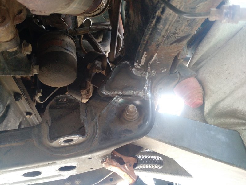

    So I took a cutoff wheel and dremel to dig into the crack. Filled it in. Grind down flat. Added this plate to both sides. Bit of a pain to do. Driver side was worse with the rack in the way.IMG_20161211_124532471.jpg

    Looks good. Have you inspected or found any more cracks?

    I have a few more cracks near non critical areas for the last few years that I keep my eyes on. It's just like high stress points at the end of a gusset. I'll put a plate over that section later to reduce stress. The frame is not that high quality of metal.

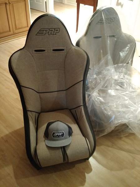

    New prp podium seats picked up yesterday. Now I'm ready for long days in the seat.

    Awh... those are nicer than mine :bowdown:

    Pff. I didn't get a hat with either of my Cobra seats. :goingcrazy:

    I picked them up in person. So I was like you got a hat. This is definitely the nicest thing going in my truck. Memory foam butt pad. I know a lot of racers don't like suspension seats because over big bumps your seat belts feels too loose.
