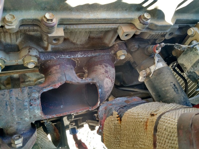

    If only I could fit in that treadstone manifold

  13. Jan 28, 2017 at 7:41 PM
    #533
    MadTaco461
    MadTaco461 [OP] BRO runner
    Dec 30, 2009
    #28470
    13,411
    CA
    99 turbo 5 lug long travel
    Kinda stock
    Does your setup go outside the frame? Think I have around 9.5" away from the head to work with. This sounds really dirty. Tucking the turbo next to the block is best for my truck.
    For some reason I can't see his pics if he has any.
    Those tube headers are big $$. Think I'm going to reweld add a few gussets and go another few years. Might try to make an additional brace.
    Who knows might make my own new ss header and have someone tig it up.
    My engine mounts I think are to blame for this accident. See some missing paint from the hood.

    Not the tube one. The cast one.

    It's less Tacoma and more mod
    Damn, was that manifold tigged or cast?

    That one!

    That looks strong enough for my truck. The tubed headers are too thin for jumping and dirt. It broke right at the weld. Actually my weld held. The weld that whoever tigged the tubes broke. It might be a mild steel plumbing tube.

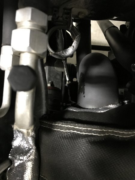

    boostedka
    boostedka Well-Known Member
    Sep 29, 2011
    #64367
    6,043
    James
    NM
    2013 DCSB 6MT, 2004 4runner
    My turbo is about lined up with the outside edge of the the frame rail. Idk if this pic helps. You can see the frame down below
  20. Jan 28, 2017 at 9:25 PM
    #540
    MadTaco461
    Dec 30, 2009
    #28470
    13,411
    CA
    Kinda stock
    Thank you exactly what I needed.
