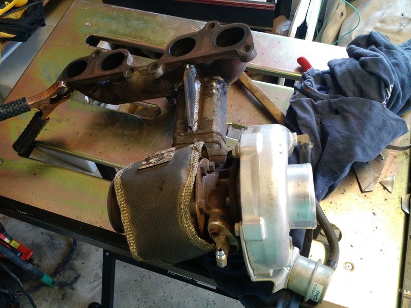

    She not pretty, but it will do I think. Going to make a ss heat shield around that ugly up pipe instead of heat wrap. The wrap is making the metal flake off.
    Did done some measurements and think that treadstone cast manifold is my next move. Just need to bend a new shock hoop.

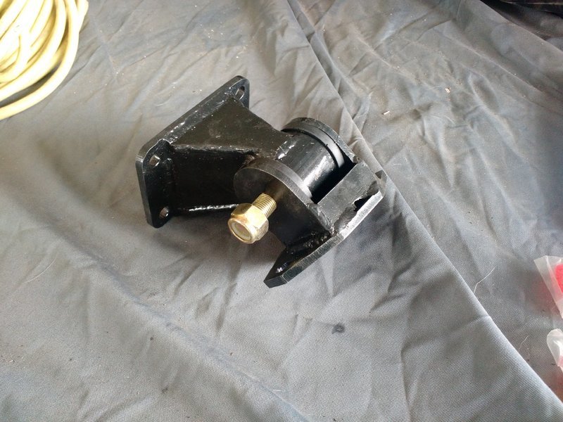

    Passenger side motor mount all finished up.

    Started the truck up today. Whoa baby feels like race truck. Good vibrations and tight driveline. Probably tackle the other side in a month or two. Just happy the motor doesn't flop around.
