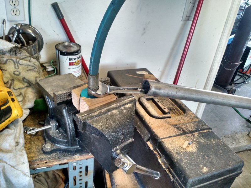

    In other new what was suppose to be truck prep for a dez trip, turned into truck being stuck on jack stands.
    The resi hose sprung a bubble and leak. Too close to the exhaust for my comfort if it popped. Trying to loosen the hose that goes into the resi cap requires custom fab clamps made from wood to not scratch the outside of the cap. Had to torch the threads because king uses Teflon thread sealant. Pretty scary how hard you need to crank that vise shut. The wood actually dents into the o ring groove. 15 yr old hoses.
    Coil over won't come out of the bottom. The bolt bent. Much of came a bit loose. Going to need a full day to cut that bolt out. Out to the desert tomorrow to take a break from this.

    It sucks when little shit turns into a huge job :(
