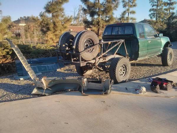

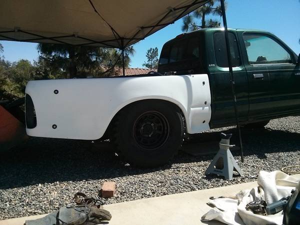

    Decided to rip the bed off and mount up some fiberglass, make my own bed, located the shocks out board the frame and swap in my tundra axle. Got it kicked off this weekend. Hopefully the truck won't be down too long.

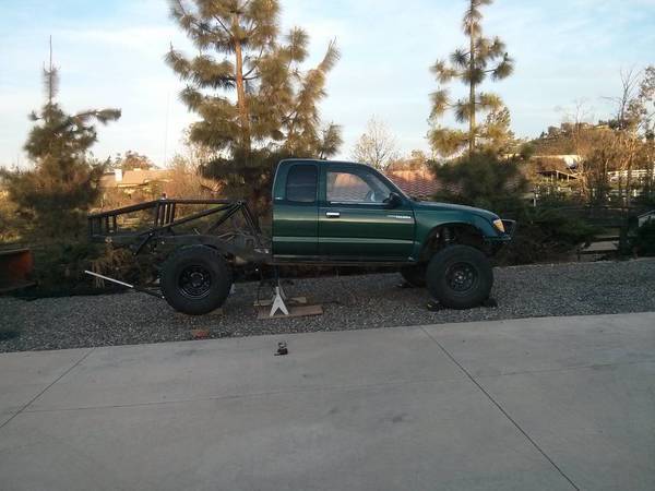

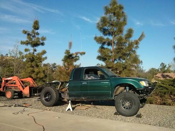

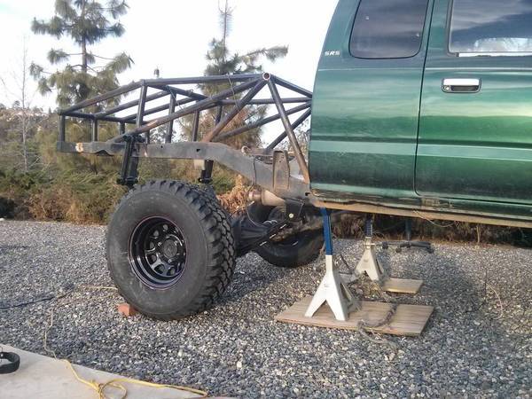

    Been sitting like this the past 3 weeks
    Setting pinion angle at ride height
    Full droop. It will be strapped about 17"
    DAT ASS is wide and it is nice.
    So the spring perches are welded up. I broke the leaf pack down to a single leaf to start cycling the shocks. I have some grinding to do before I tack the shock tabs on. I made a pretty good dent this weekend with the help of a few friends to help speed things up.
    I'm hoping next week to cut my fiberglass down and finish up mounting the shock tabs. I should also have time to mount my battery. For some reason this seems like it's more work this time around than when I did the rear long travel 4 years ago.

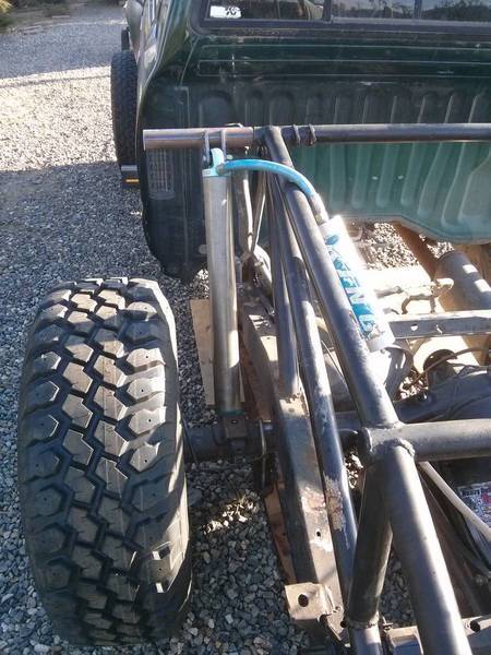

    Full bump shocks tacked into place.
    I extended the shock tube out. I have tubing 1.5" inside my 1.75" main tubing and a rosette weld to hold them together. I'll need to finish up the tubing around the shock to prevent fatigue.
    Hoping to get my glass cut down and mounted this weekend while the leafs are still broken down so I can prevent tire contact. The glass is going to get dovetailed out pretty far. More grinding and cutting today. The to do list is getting smaller. Starting to see some light. Need to finish adding tube, mount battery, add limit straps, brake lines, shorten driveshaft, mount street legal crap, sand, paint, and make a bed tray. I'll make a parking brake a little later down the road. A block of wood will fix that for the time being. Now I know why this project started to become expensive just to mount a tundra axle.

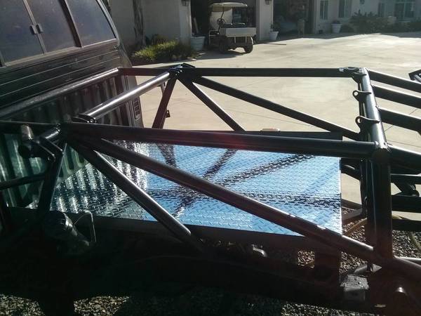

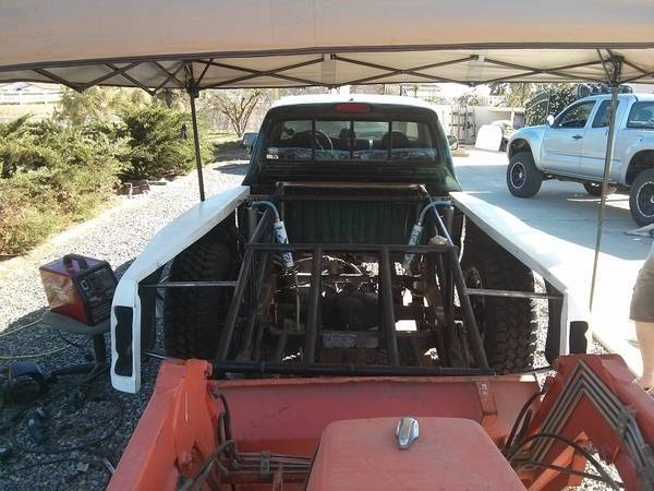

    So I've been getting pretty burnt out on this build, but progress is slowly going.
    All the cage work is pretty much wrapped up right now. Started making a bed tray with plans to box in the side later down the road. Shocks are in place, but still need to do limit straps. Battery box is ready and just waiting on a few parts for the breaker. The brakes are hooked up and bled. Fiberglass is cut and mounts are in place. Currently have the rear glass off. Driveshaft is getting shortened for the larger axle diff this week. Still need to get my hands on some spare 33's tires since I went up to 33's from 32's. Maybe running next week. Hard to say because something new comes up.

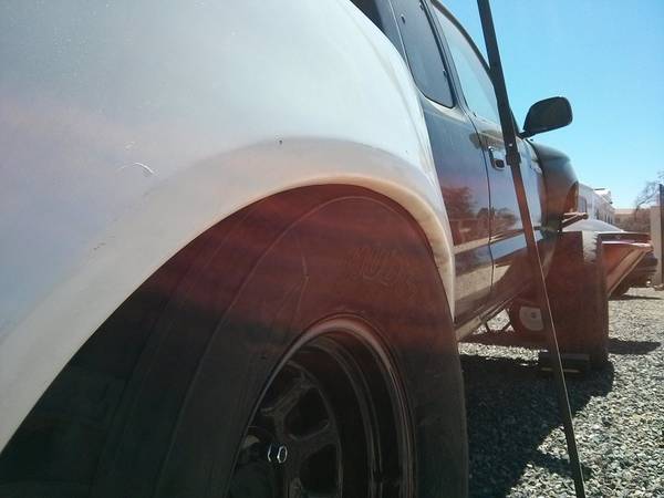

    I originally thought it was going to be as simple as when I mounted the rear long travel 4 years ago. Well you run into custom fabrication when you ditch a bed and still want it functional. I realized I never posted a pic of the glass. I had no idea how to hang it up by myself so I brought the easy-up outside the used tie down straps the hold the bedside in place while I make mounts. I mounted the glass at full bump. You can see my tire stuffs up like some slammed hella flush car. I couldn't roll into the garage because you can't step back to make sure the glass follows the body lines. So in these pics I had to tack weld with the flux core and roll into the garage later to MIG it up. I do not miss that flux core welder.

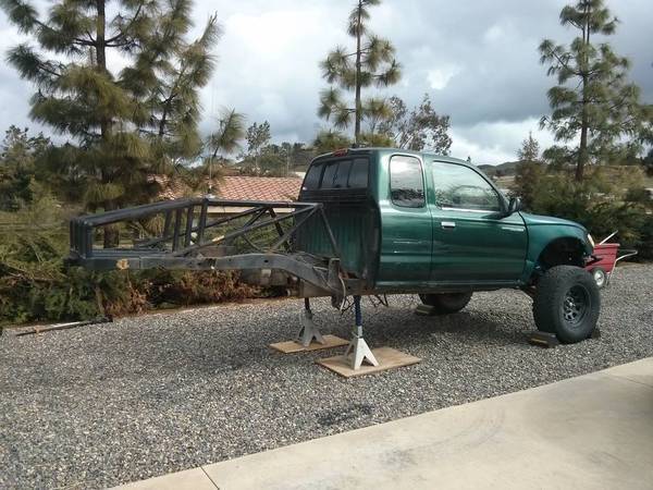

    Whoa TW changed a bit on me. Let's hope this post looks fine when I'm done. The truck today was driving kinda. I didn't bleed the brakes good enough the first time, so that was kinda fun. Battery is sitting in a battery box now with a metal battery box inside. I'll show finished results next week when I get the breaker set up and the wires organized. Got the limit straps set at right before the leafs spread apart which is about 15" before I touch my bump, not pictured. My dog likes sleeping next to me when I work on my truck and will often try and bite me when I'm welding. The driveshaft came back this week from getting an 1" cut off to account for the larger axle and me just wanting a bit more wiggle room.
    Next weekend finish bed tray, clean up electrical, hang bedsides up again, and drive around town and try and break all my work I just did!!!!
