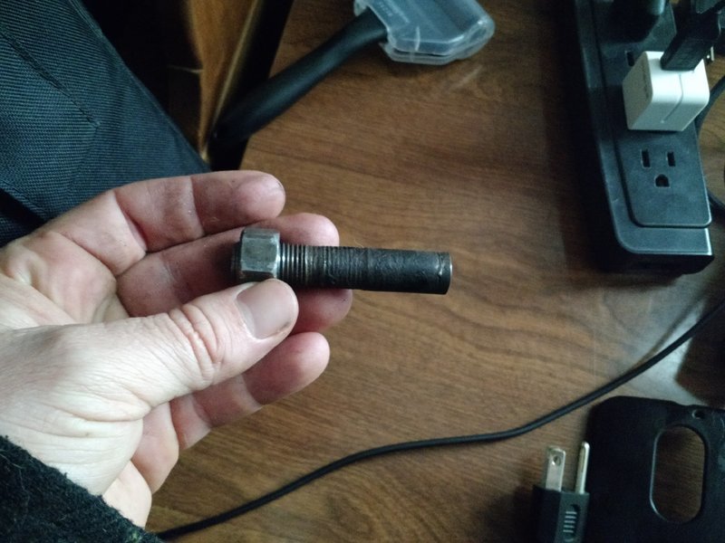

    Bent grade 8 bolts suck. Had to cut off the head and push it out backwards. Shock is out finally. Should pull the driver side coil over too.

    More shoulder on the replacement bolt?

    Going to use the same size bolt. Probably came loose on me. Didn't take much to break the nut loose. Haven't pulled these shocks in I think 5 years.
