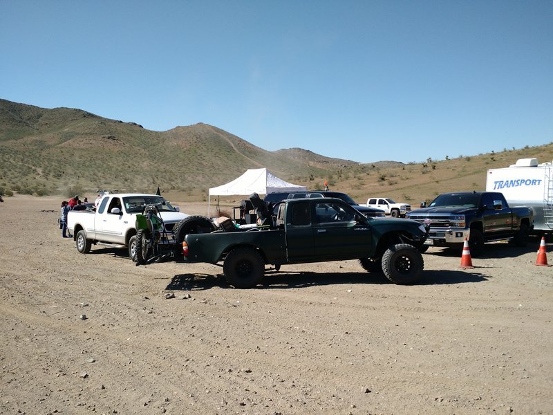

    I should start looking into a trailer...

    Almost doing a wheelie. Lol.

    Or just sell the bike, put money into truck... Ur body and truck will thank you. Problem solved :D

    Telling me. My body hates me right now with how much that bike beat me up. Think the truck thanked me for not running it in barstow over the weekend. Little too big out there for my truck.

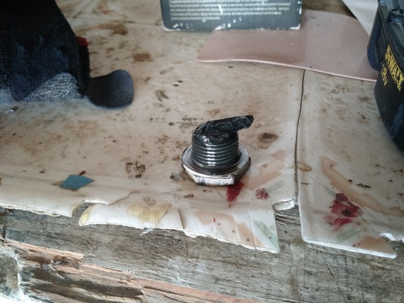

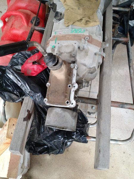

    2 to 3 weeks ago took the truck up to Barstow for a shooting trip with some messing around. Ended up pissing off the transmission a lot hitting some whoops. Happy the truck was kind enough to take me home 130miles without letting go. Well drained the oil and a big chunk of metal came out. So a bought an r155 trans from the 05+ 4 banger. Found out my shifter is different and input drive shaft is too small. One more trip to the junk yard.

    Oh faack, well an r155 clutch is still 10in so a 2tr clutch would probably work on your flywheel to get the correct input shaft size?

    I was thinking to do the 2tr clutch and 3rz flywheel. I'll do some measurements but that should be a breeze since I'm using the r155 belhousing also. I think my slave cylinder bolts right up to the clutch arm. That arm is so much beefier. Everything on this R155 is a lot beefier than my w59.
    My driveshaft input shaft is the one that is too small. Get to take a :sawzall: to the junk yard and have at the section of drive shaft that I need.

    Ahh, well thats good to know! Splines on the trans input shaft meshes with your 3rz clutch disc??

    I'll call lcengineering next week to check. I have a 2rz motor which is a 9.25" clutch. I'll step up to the 10" flywheel and use the 2tr 10" clutch. I haven't pulled my trans yet. I doubt my clutch slides over the R155 input shaft.
